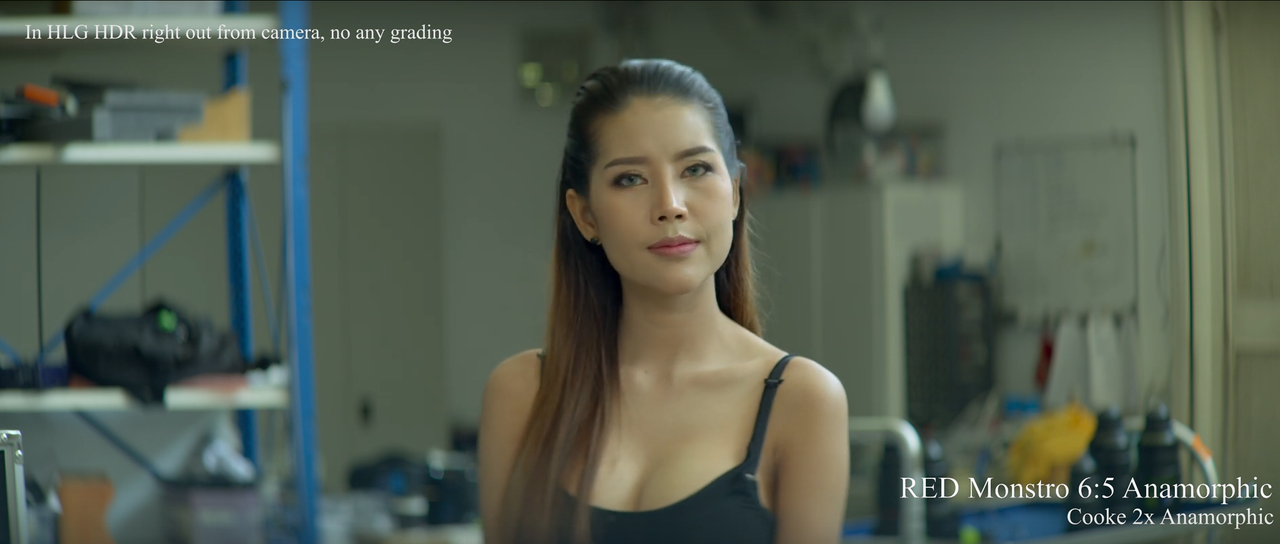

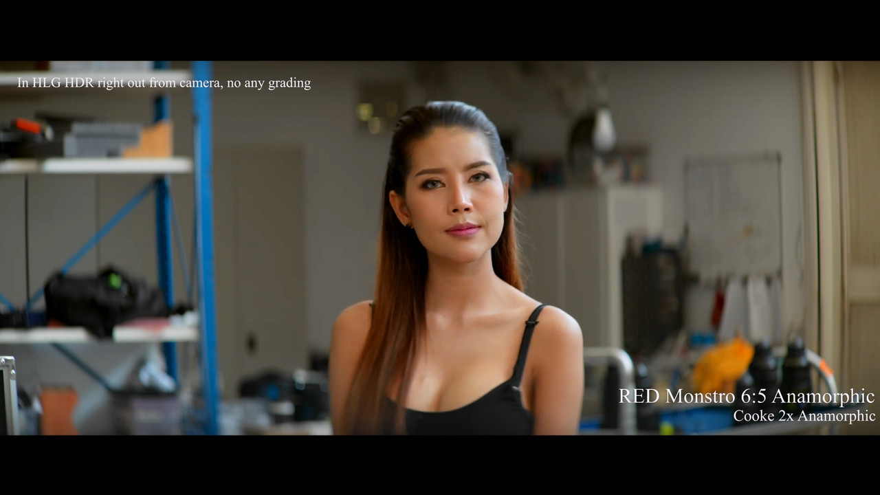

Why is the Monstro so unbalanced in its tint?
Yes, when white walls are green you are doing it wrong some how. I have a difficulty to believe both cameras are at equal kelvins and tint. And even if so. Why make a test where one has the colors clearly pushed out of balance.

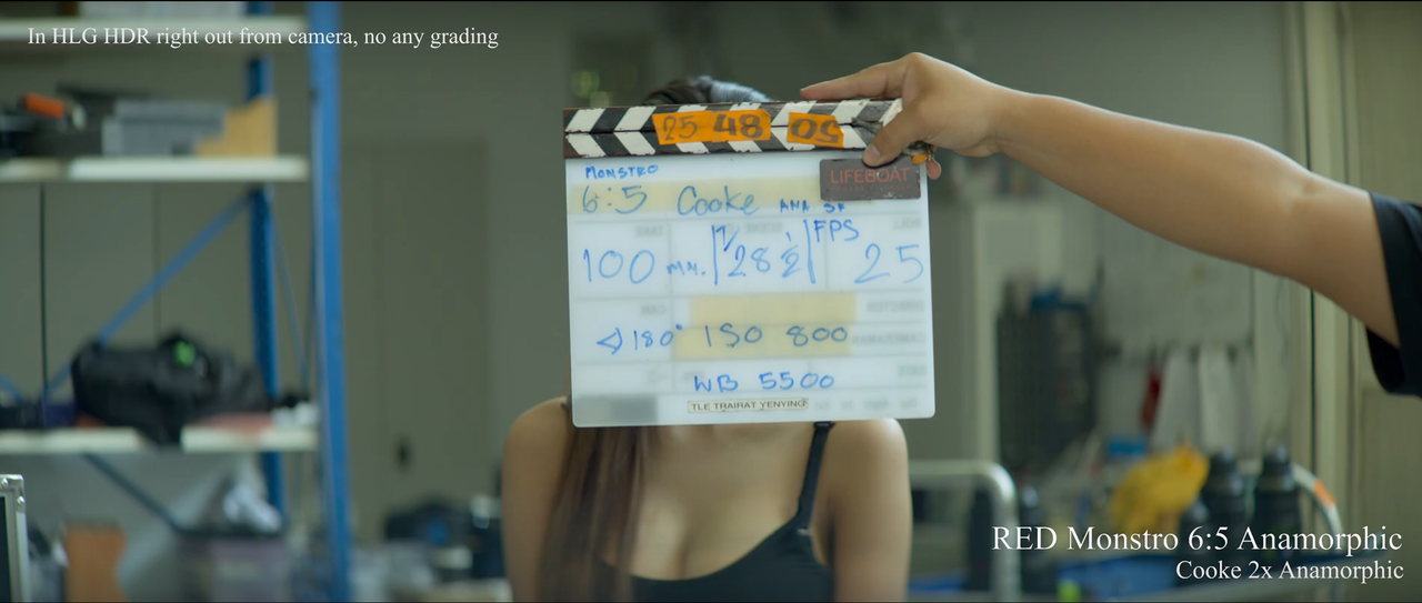

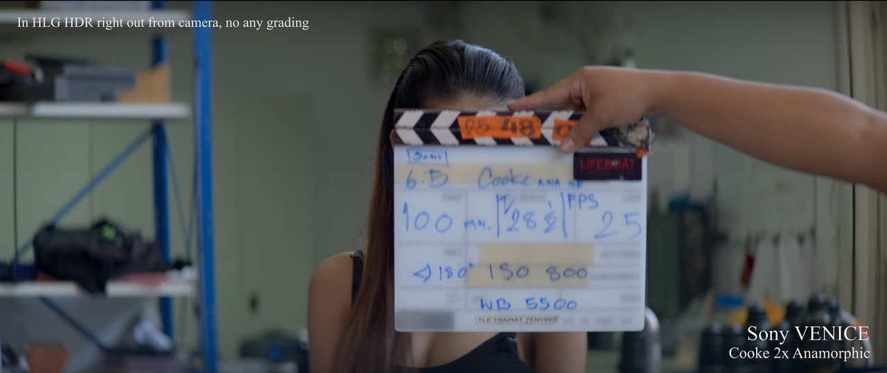

From looking at the clapboard he presented for each camera at the beginning of the shoots, he did use a White Balance of 5500 for each camera. It seems he is unaware of the Tint required to better white balance the monstro or chose deliberately not to use it for this test.

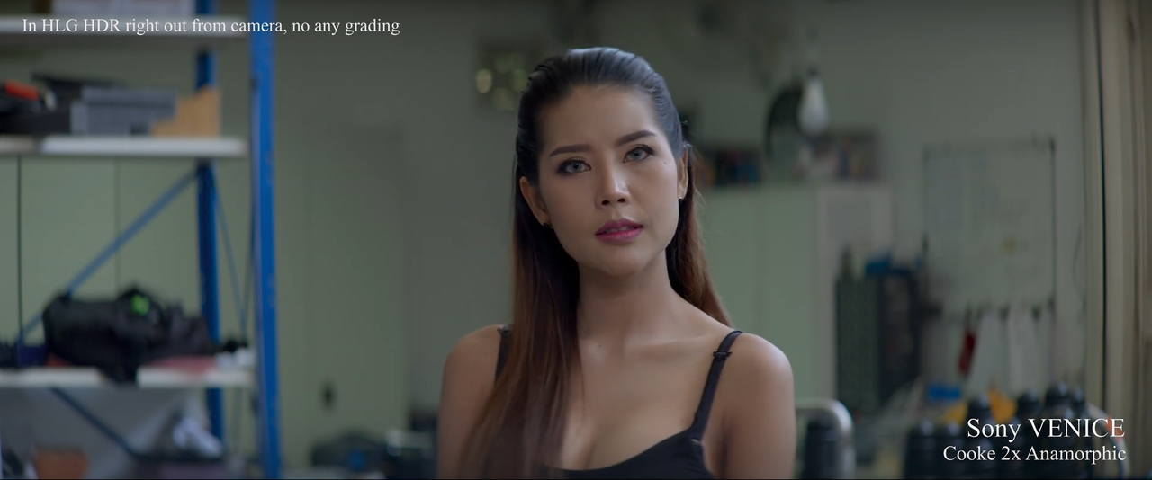

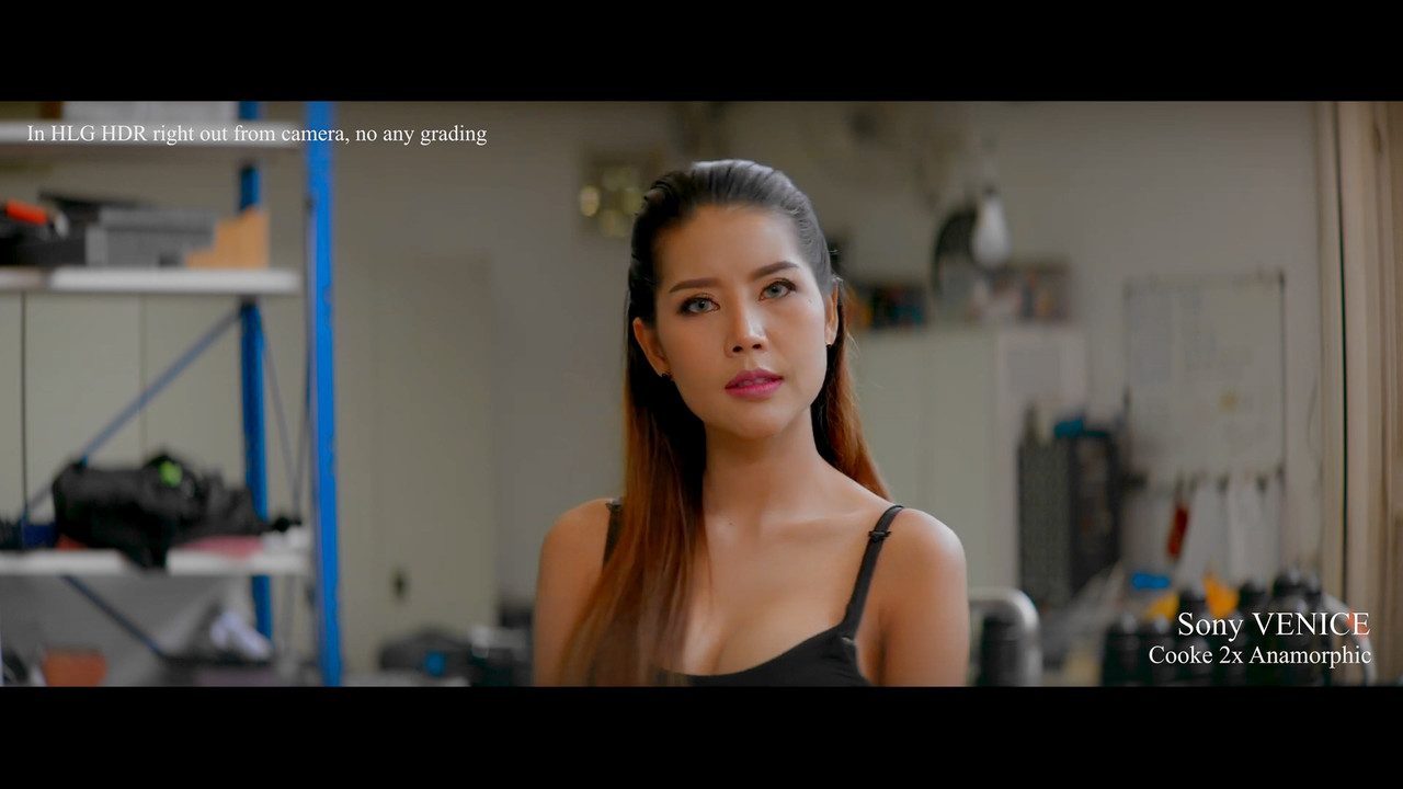

The Venice seems more blue than it probably should as well. So I'm sure there are some Sony Venice owners who will probably take issue with this test as well. So I believe neither camera is truly "White" Balanced.
Edit,

Yeah, They probably just thought it was easier for them to just set the Kelvin the Same and just go from there. They do say that no grading was done to the images.
here is my attempt to show how the Venice and the Monstro both could have been corrected to atleast fix the White Balance of each in this test. And yeah! I know they are jpeg images that I graded you can tell by the shitty banding in the image.
Venice

Still, it's a shame to see the color from the Monstro so off... I know there are a couple of people who believe it's accuracy but it's too obvious. Good thing grading takes care of it on the Monstro, for the most part.

Chris this test has nothing to do with RED's color accuracy - this crew is clearly not white balancing (at all).
Sorry, you're being pretty unfair here.
If you pointed an Alexa at this slate with similar settings it could be green too (I know of a very talented DP that always dials out the green in Alexa - did it on an Amira shoot with us).
This team obviously wasn't thinking about WB at all.
Maybe there were offsets in the Monstro from a previous shoot?
Maybe the light really is green?
We always WB RED's before we shoot (off a card or chart) and never have problems. And we have a demanding colorist who doesn't tolerate cams with wrong color balance, so trust me...if there was an actual problem I'd know.
Again this test is meaningless. For all we know this Monstro may have had +green offsets from a previous shoot.
If this team had WB'd off a card (or just AUTO WB'd from the touch screen) I'm 100% positive the Monstro would look normal.

I've noticed green when shooting with the Monstro before and so have others who rented the camera from me. It's not a myth. It's there. I've even seen people do the - tint in camera to get rid of it as to not deal with it in post. At the end of the day, still a beast of a machine, but the color isn't phenomenal.
It shoots raw, does not matter where you do your white balance calibration, in camera or post gives same result.

As the poster of this video noted;
"I tested at Life Boat, a camera and lens rental house in Bangkok."
So as Nick stated, who knows what settings were left from the previous renters for both the Monstro and the Venice cameras, the Venice's white balance didn't look all that hot either.
I mainly posted this video to show how the different Anamorphic lenses used in this test looked on each of the cameras. I realized after the first anamorphic comparison that someone must have screwed up the white balance for the Monstro, due to it's green cast, and simply viewed it as just an anamorphic lenses comparison and not on color rendition.

For all the wides, the ceiling lights in the background are off in all the Monstro shots but turned on in all the Venice ones. It gets more inconsistent in the closeups - sometimes on in the Venice shots, sometimes off (you can even see it turn off at 3:05). Appears to be consistently off in all the Monstro closeups but I might be wrong. If the background lights are changing, I wonder if all the ambient lights in front of the subject are also changing. Not to mention the daylight through the windows is more than likely shifting all day.
And lastly, who knows what that LED key light they're using is like. People should definitely not consider this test as a color test.

While it is upsetting that so many people do tests like this because they seem to think that keeping the WB numbers constant between two cameras is somehow being objective, I hope RED understands that THAT is the type of person they need to target. Although the tech-savvy of us understand that WB is just a non-destructive multiplier to the raw data and it doesn't matter whatever the hell the numbers actually say, there's still many people that have the compulsion for the number on screen to read zero -- if it's anywhere away from 0, they think something is inherently wrong.

While I'm on the line, a few things about this test as it's "straight out of camera". Something is weird here for sure in terms of white balance of both bodies. In testing the Venice recently there was nowhere near this color variance between Monstro and it.
However, I will say it is critical to have good white balance when comparing camera systems because literally no manufacturer hits each others targets in terms of color temperature, tint, and occasionally other bias related things.
Also, it's alarmingly easy to match to the Venice shot or vice versa, though really the hard truth is providing an accurate target for white balance for both systems here.
