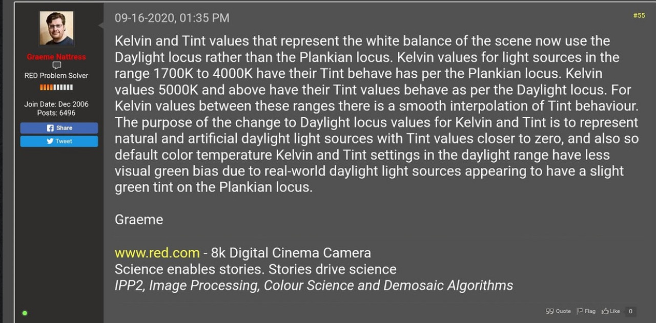

I don't know if it's the change from the "PLANCKIAN SPECTRAL LOCUST" to the "DAYLIGHT SPECTRAL LOCUST" as Graeme explains it in post from a thread from a ways back
https://www.reduser.net/forum/red-ca...34#post2798934

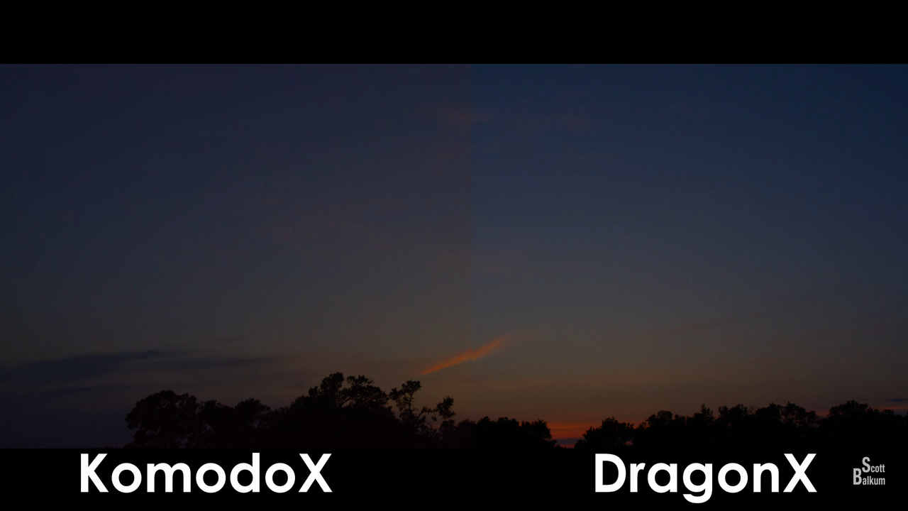

But compared to the Dragon-X, the Red Komodo-X seems to exhibit more of a Magenta Cast at certain Color Temperatures and at different times of day. Maybe it's "IR POLUTION" and the Komodo-X can benefit from using an "IR CUT" filter in front of the lenses used.
There is already an IR Cut on the Komodo-X. The square comparison issue is the OLPF/CSFs are not the same in both bodies.
