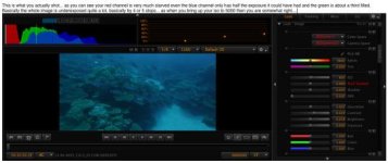

I second Rudi and encourage you to manipulate my R3D file. It was shot on Palau, c 10 meters deep, sunny day, clear water. I white balanced the camera on sandy bottom probably being half a meter from the sand. This was the same procedure I used to do for 3 yrs shooting for Discovery with my old EX1 and having no problems with colors.
http://dive-away.pl/dopobrania/A003_C013_05150R.0000387F.R3D
You underexpose by 4-5 stops and then you argue that the camera you use has issues.
I mean your red channel is really hitting the bottom and your blue and green is not doing much better. So what you have is pretty much an underexposed duetone image. if you would have filtered with a red/orange filter and by doing so lose two steps and then open up like 6 steps your image would look superb.
I Think before uploading images and arguing that the camera is not doing what it should I think it's first vice to ask one self if there is any other parameters that maybe is not where they should be. In this case exposure is clipping the red channel heavily at the bottom, so when you try to white balance the image there is simply no info, and the result is bad colours, kind of trying to make a color print from a duetone image. To get good results you simply need to use all the photo sites in the camera, that goes for all cameras red included.
If you see my screen dumps bellow you can clearly tell that the red is out of line at 800 iso, and when adjusted to balance you do not have a full spectrum to balance from so your image get ill colours all over and especially in the dark regions.
Maybe you had better knowledge how to expose on your EX1, even though I think the epic is the easiest of them all. Make sure you see no goal post and you are usually fine, bring up skin tones to 70% of the histogram if possible, and try as far as you can never to clip, not at bottom and not at the highlight end. Thats probably covered with in the first 10 minutes of reduction.. :)
