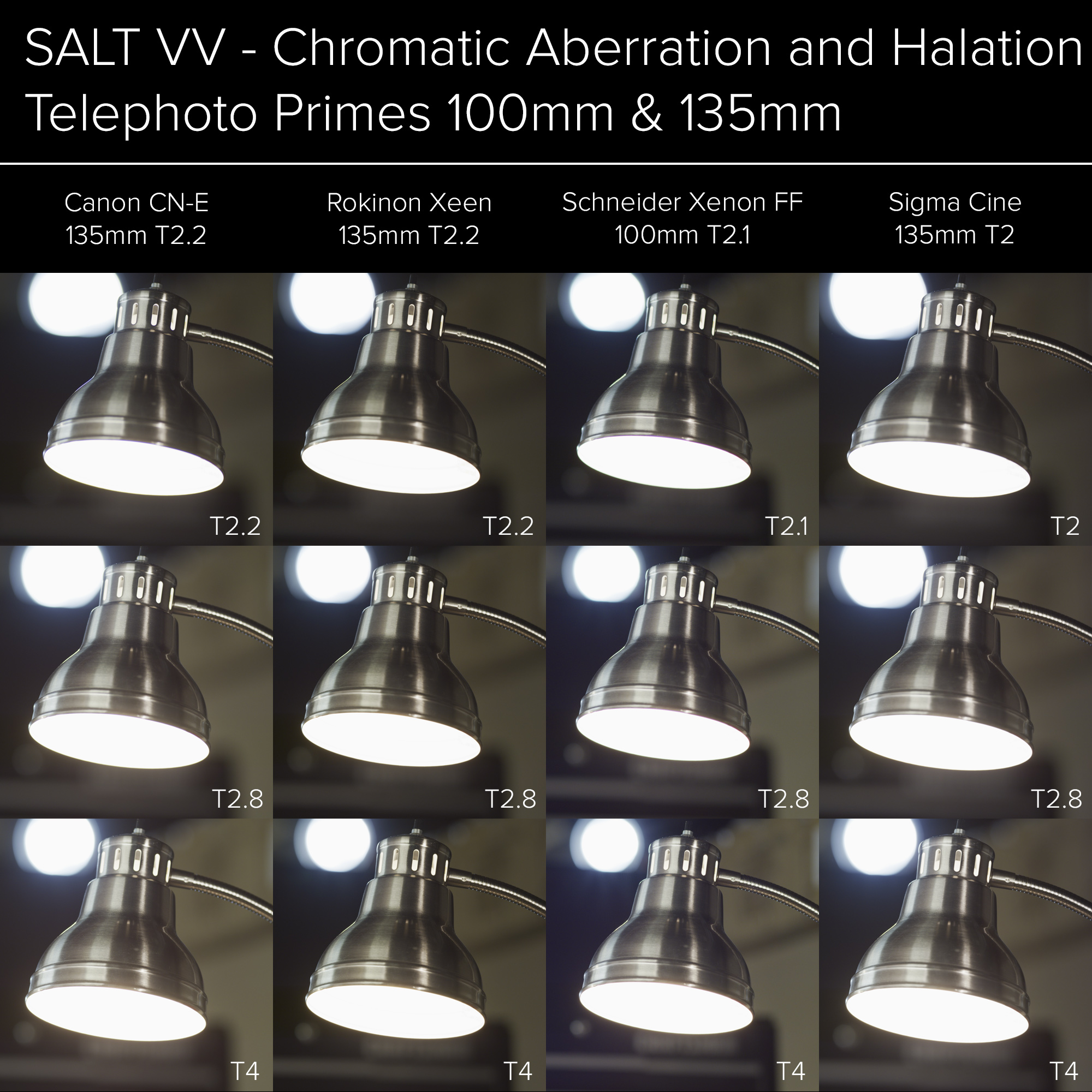

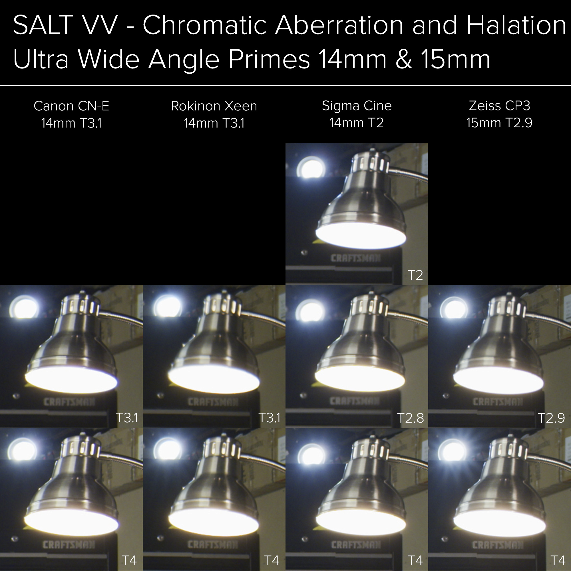

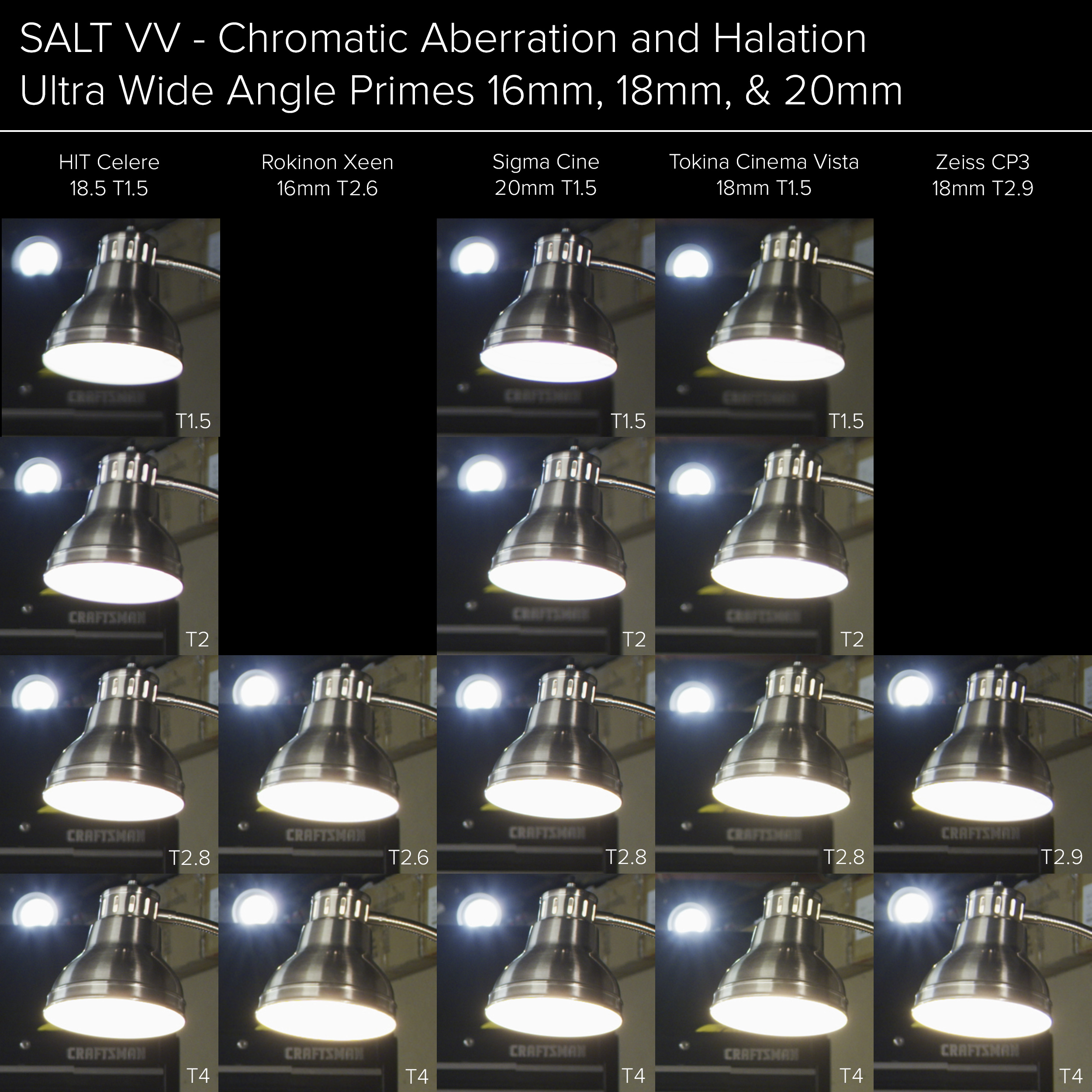

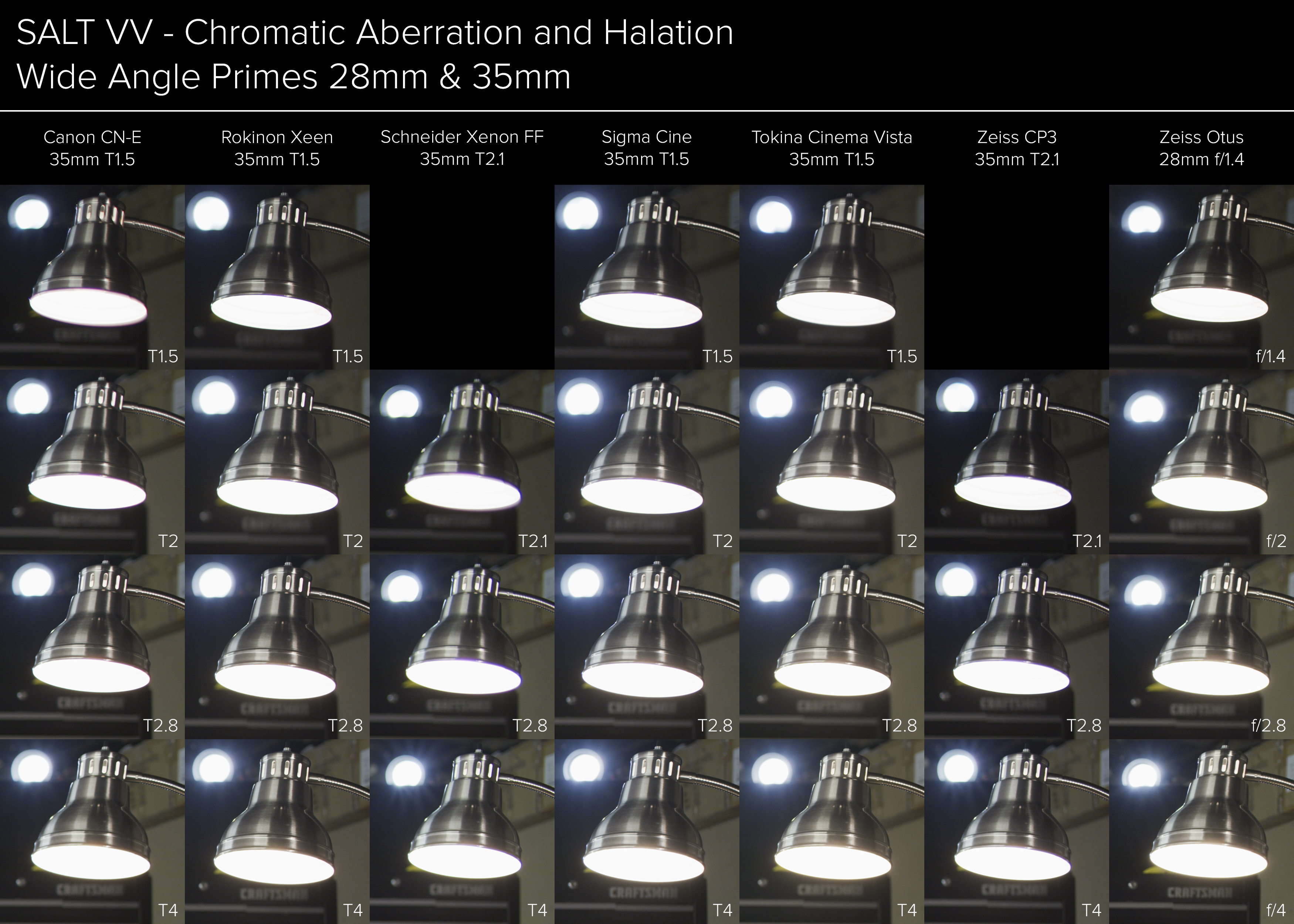

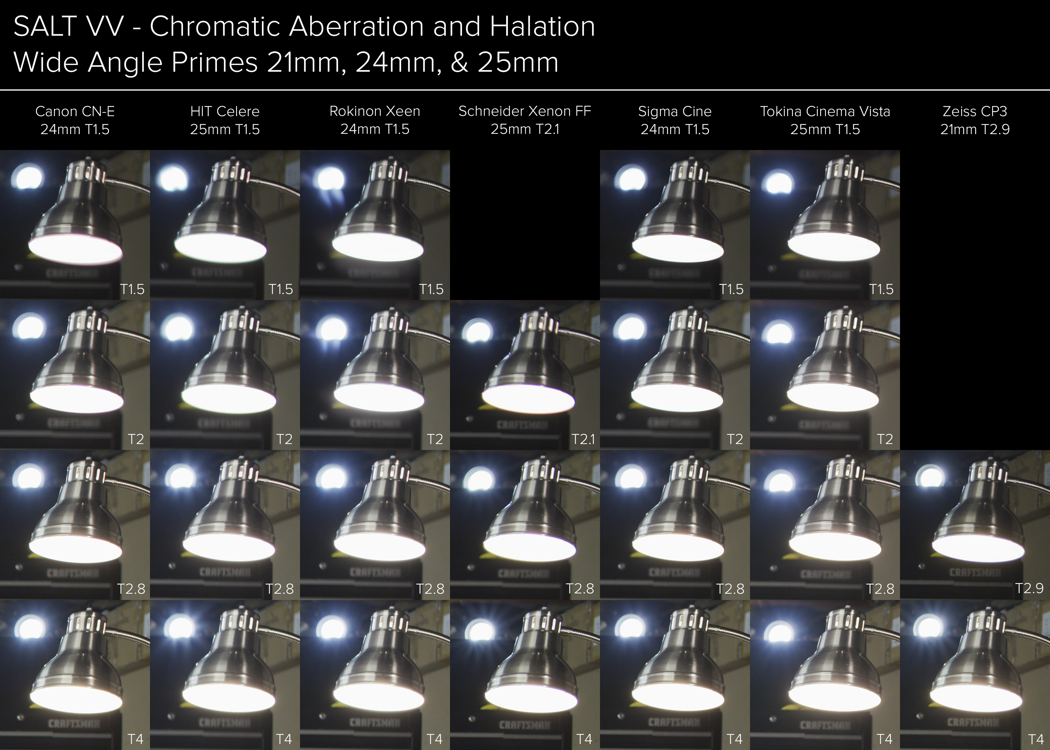

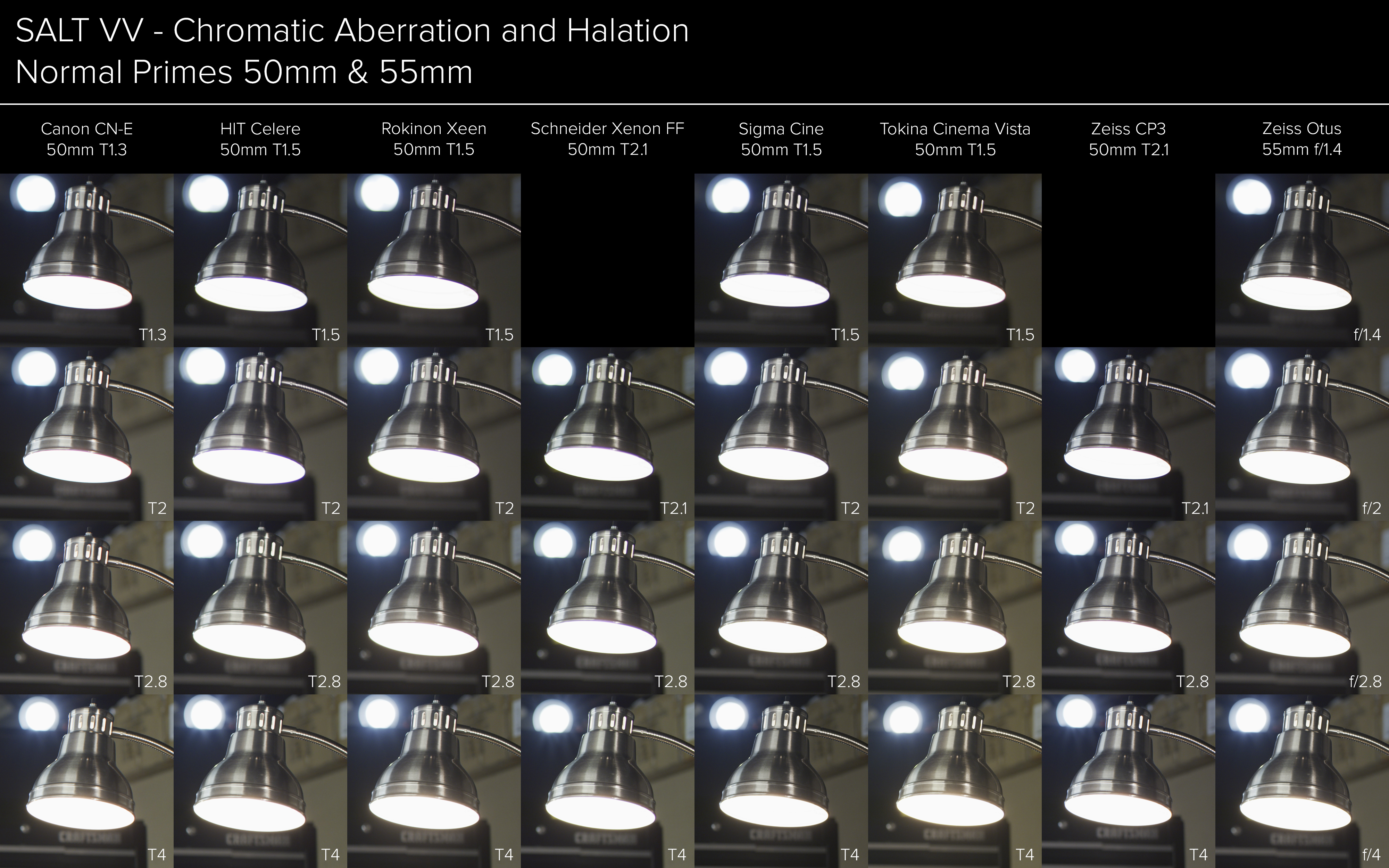

Chromatic Aberration and Halation Side By Sides - opens large image in new window or tab
Ultra Wides (14 & 15mm), Ultra Wides (16, 18, & 20mm), Wide Angle (21, 24, & 25mm), Wide Angle (28 & 35mm), Normal (50mm), Telephoto (75 & 85mm), Telephoto (100 & 135mm)

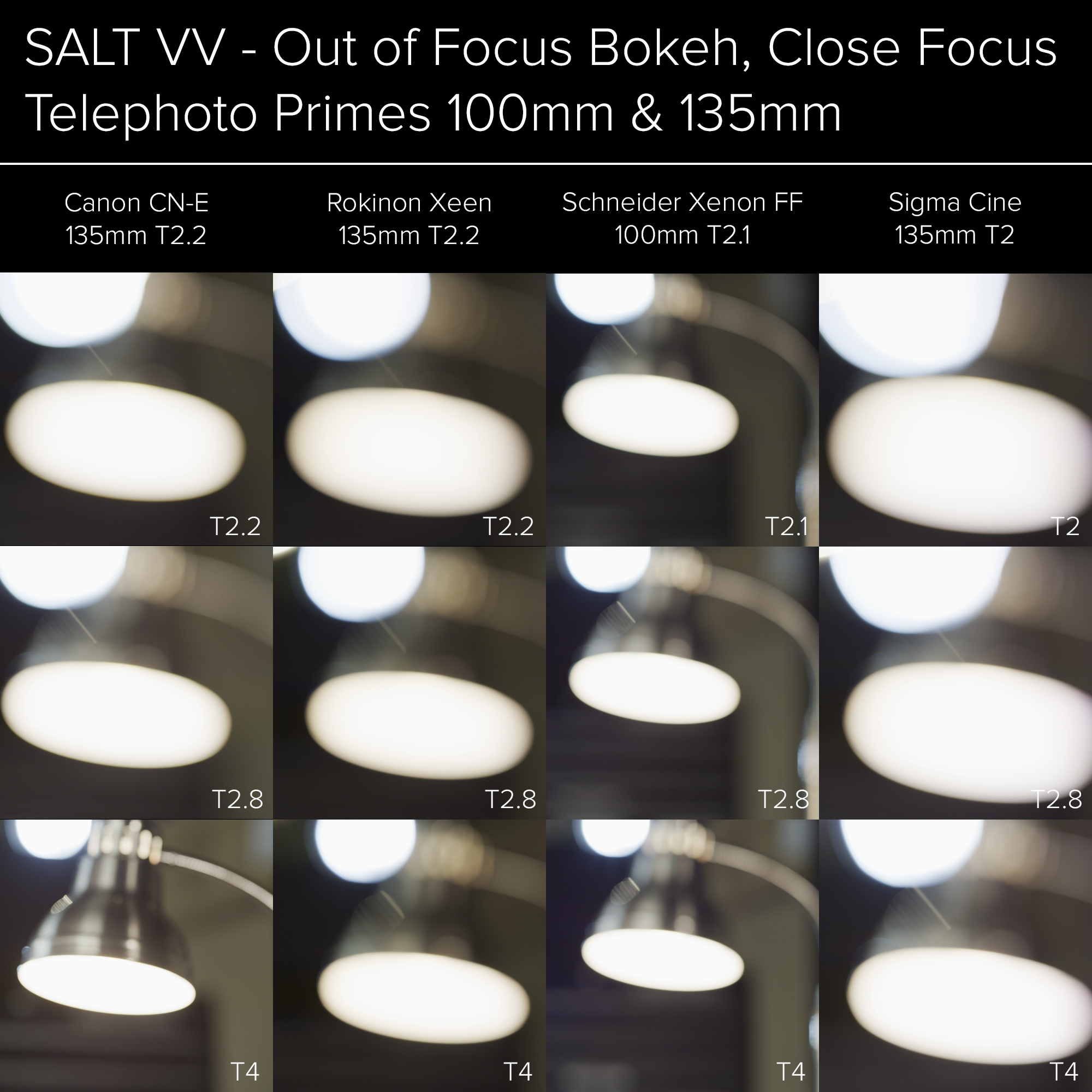

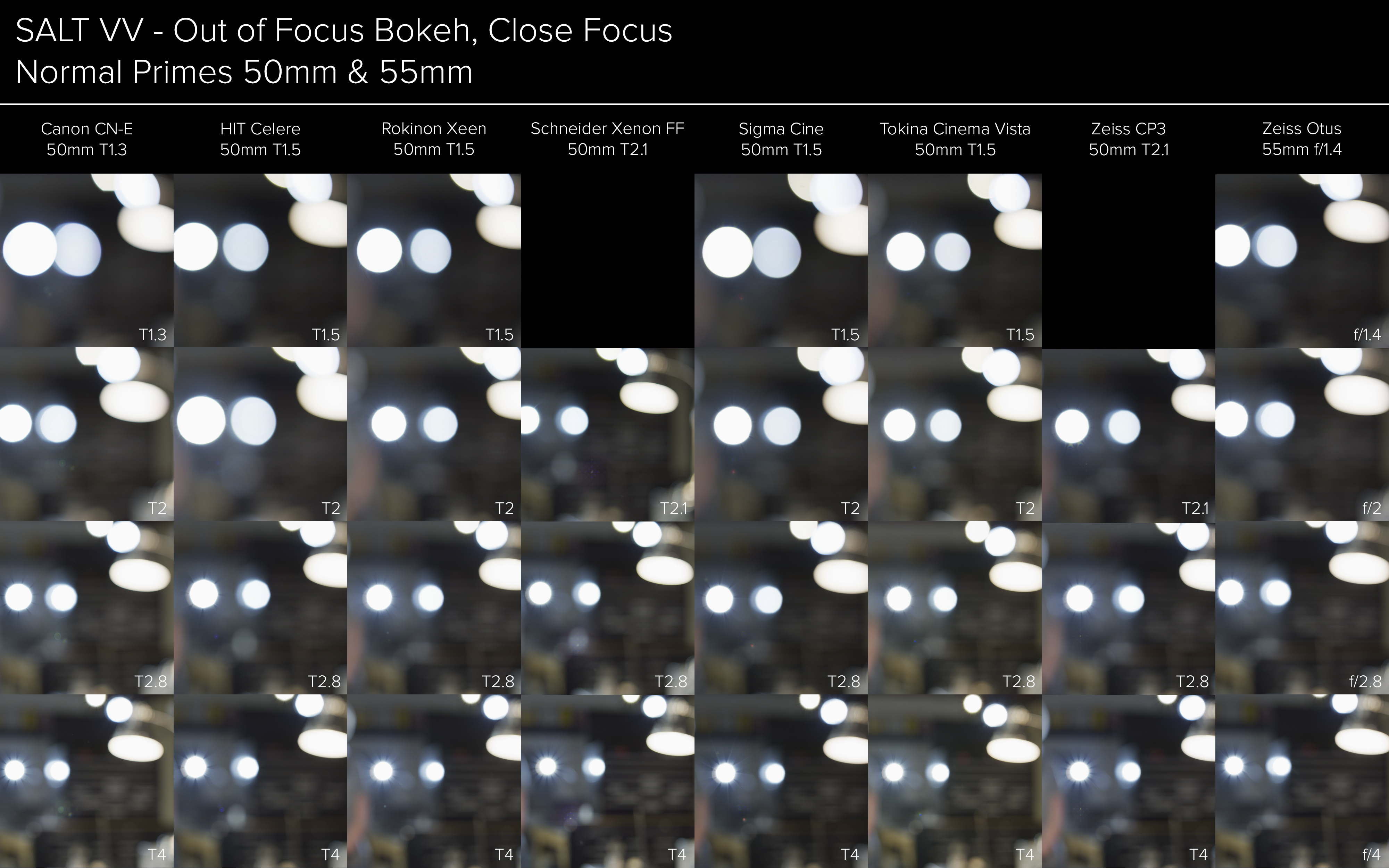

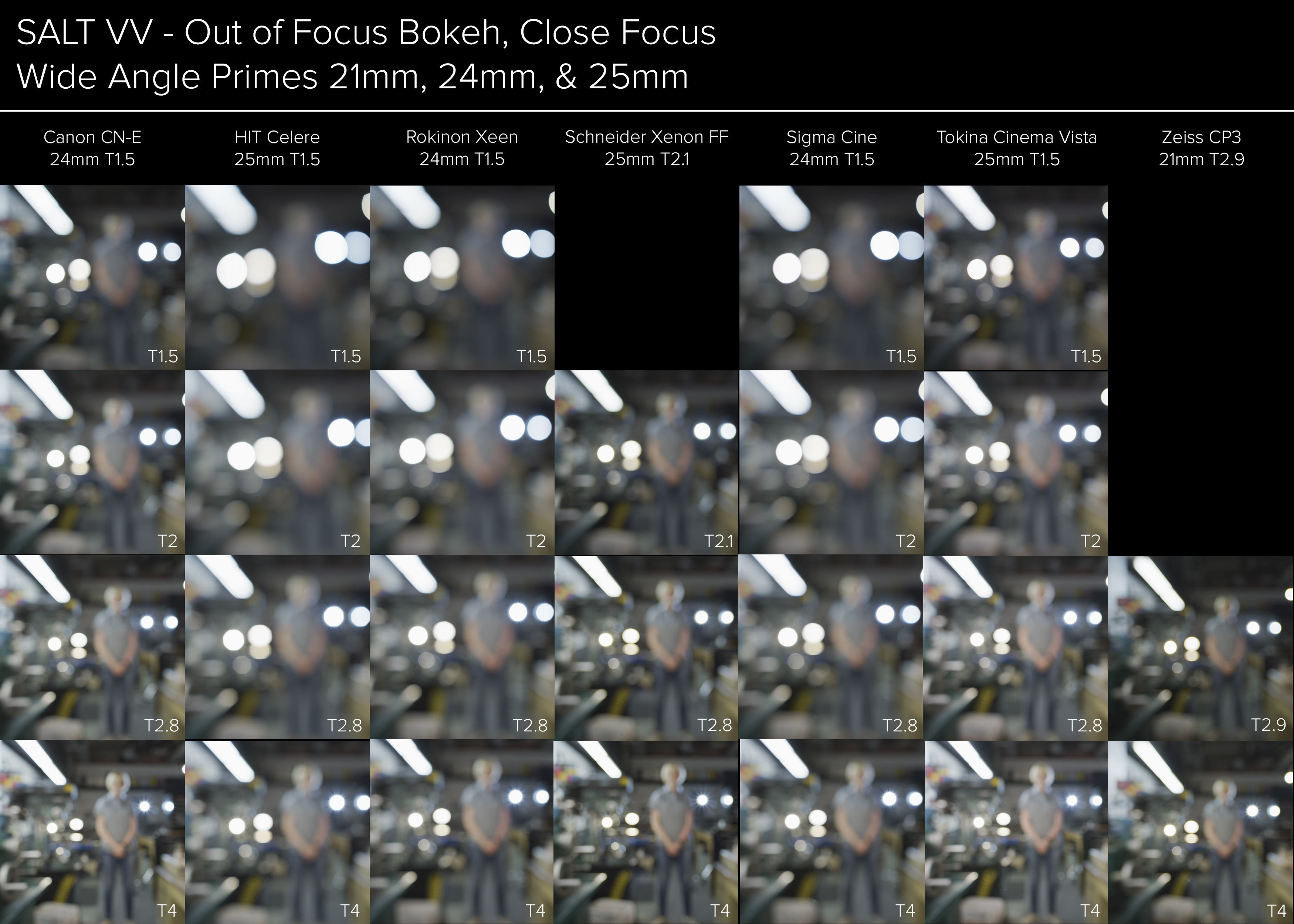

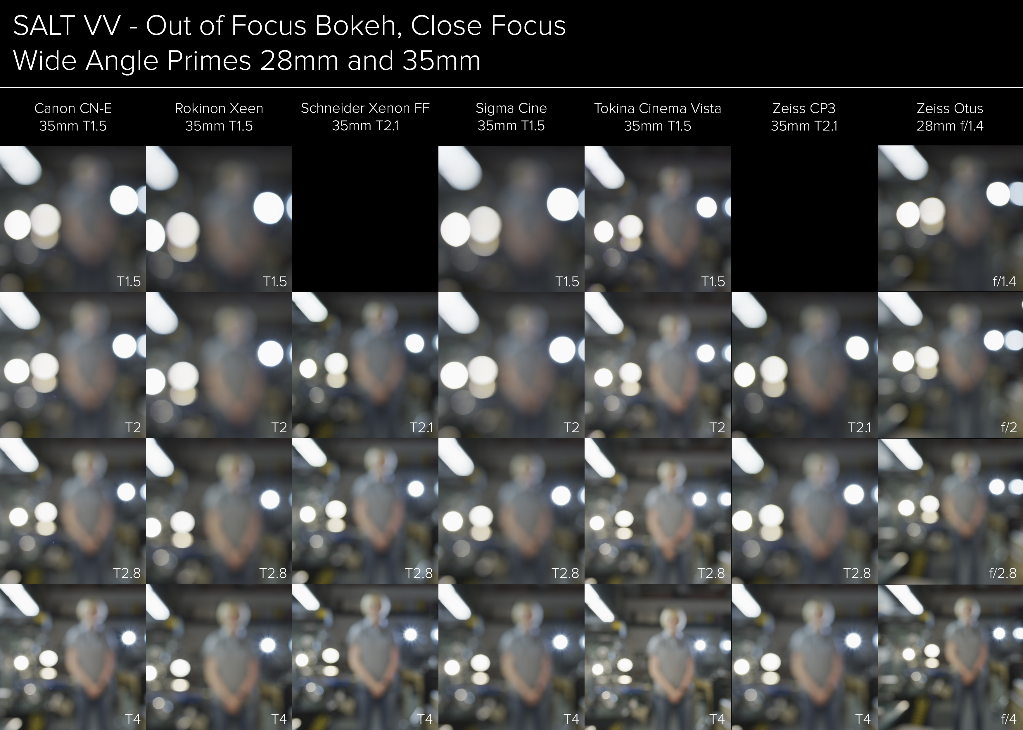

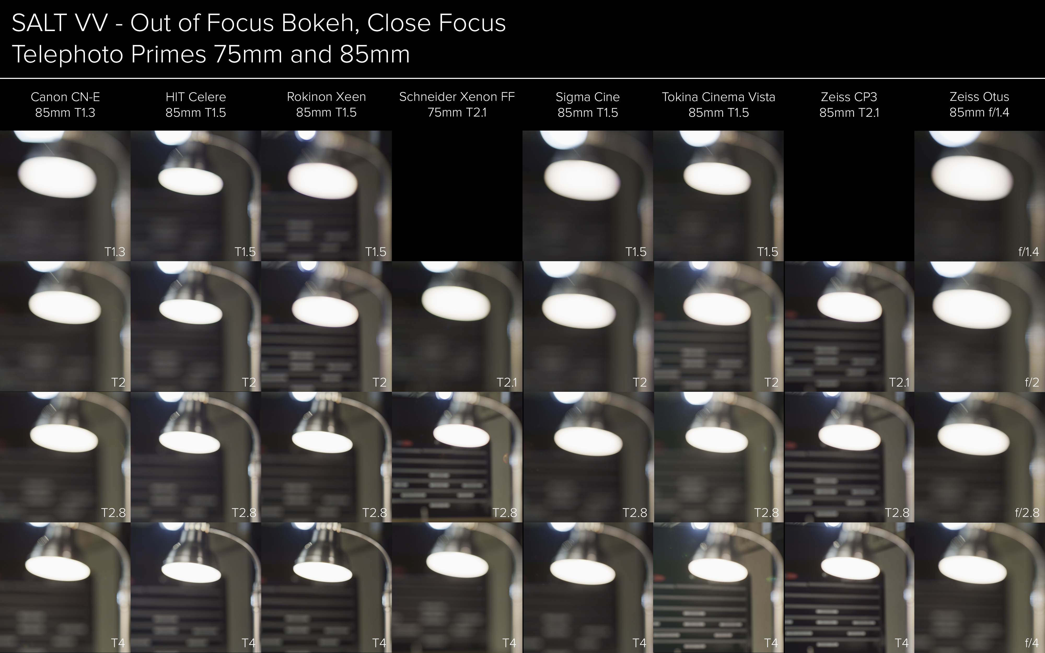

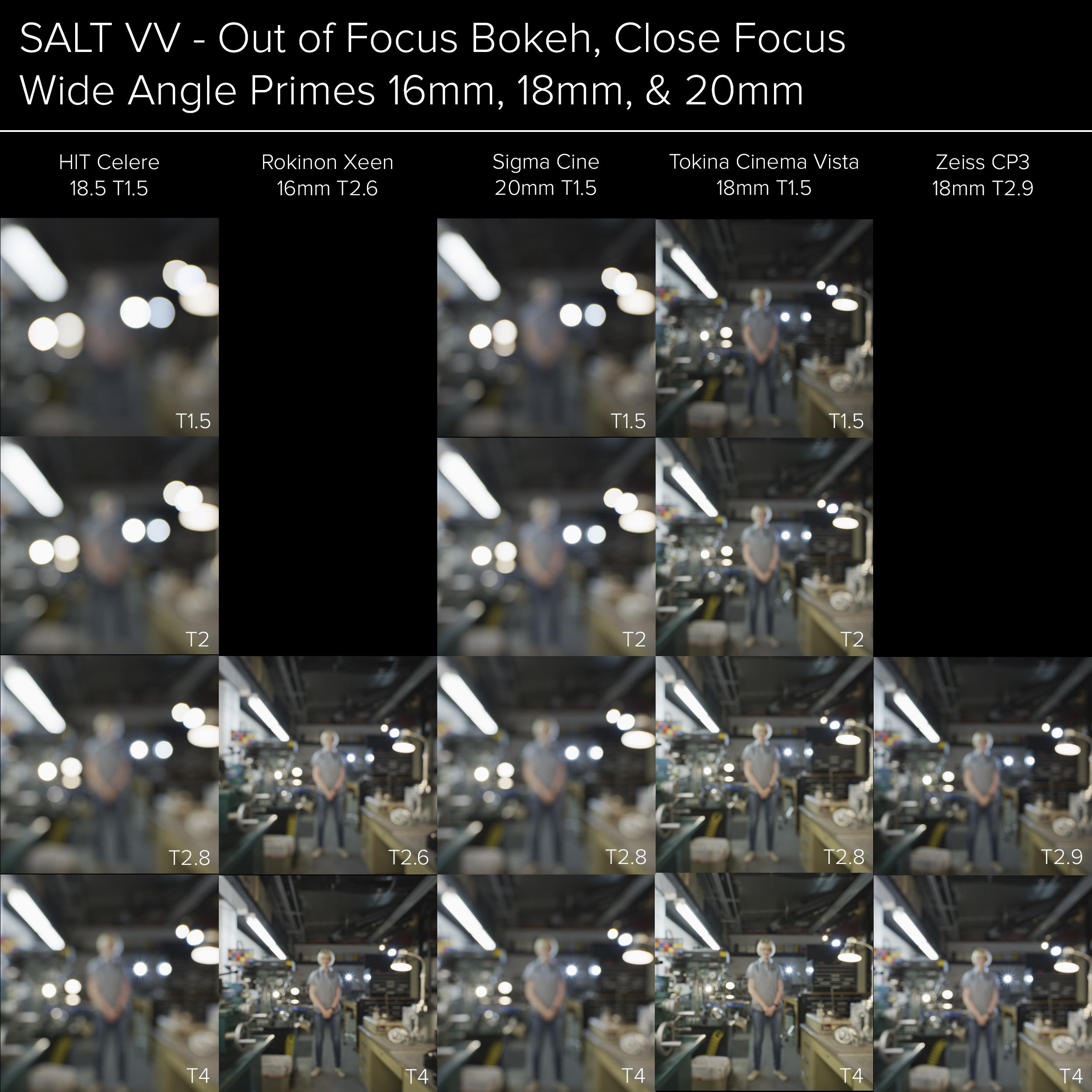

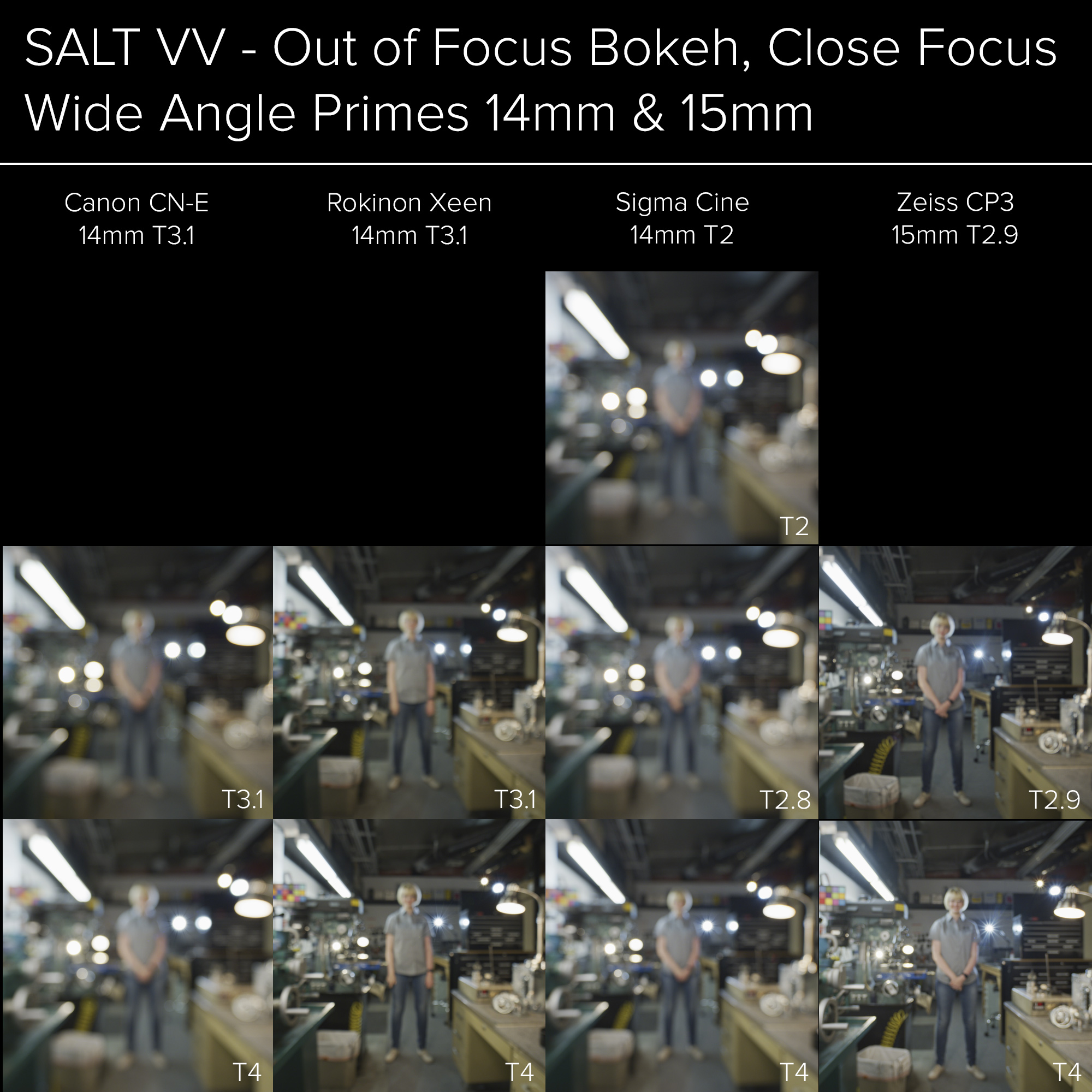

Out of Focus Bokeh at Close Focus Side By Sides - opens large image in new window or tab

They do however display extraordinary CA control showing negligible purple fringing even under very challenging conditions. They also display very low distortion and breathing. VV coverage seems ample as well. Color character is a bit yellow/warm with green/blue flares. Lenses are extremely heavy and very solid with great mechanics and marks.

To me these get edged out by the Xeen’s. The CNE lenses show a fair bit of CA and for the price, I’d go with the Xeen’s. If you’re already in Canon world, then you’re used to how these lenses perform and it’s the look you are accustomed to.
