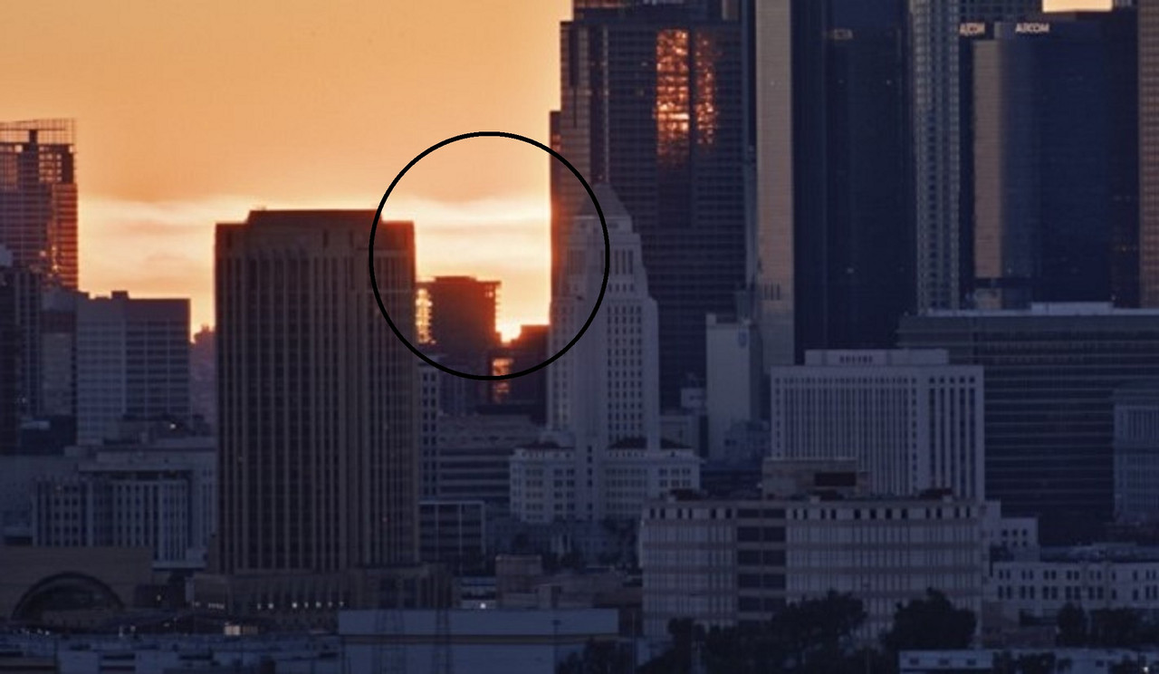

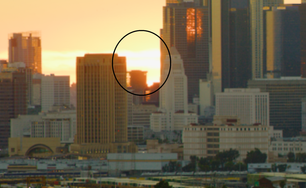

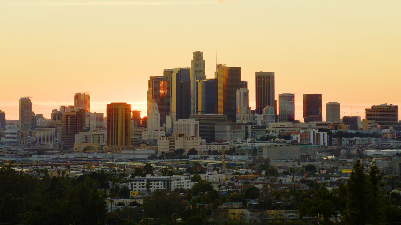

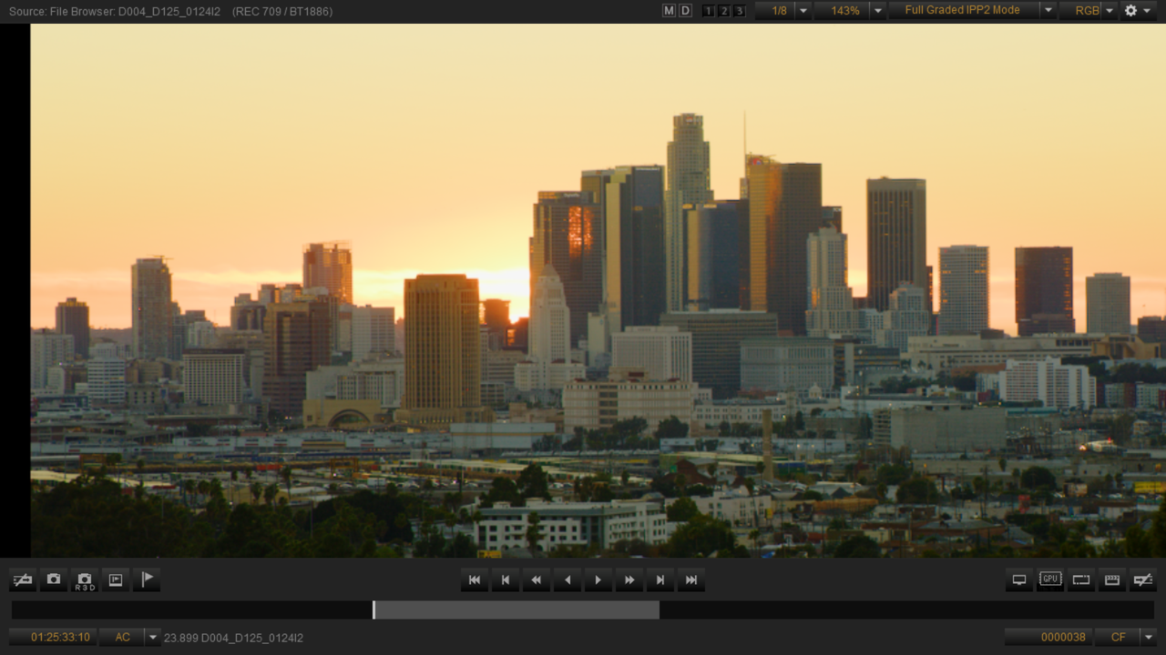

I noticed something Interesting when I tested out the "V-Raptor 8K VV-X SUNSET" clip. In the Original Still included with the .R3D file, the Sunset Area was much better controlled. When I brought it into REDCINE-X BETA Version 62.0.17 and did some correction, The Sunset between the buildings was less controlled. However when I exported a Still from REDCINE-X Beta 62.0.17, The Sunset was as well controlled as was in the Original Still from The Sample RED V-Raptor 8K VV-X SUNSET file. I don't know if this just the Beta Version of REDCINE-X or will that be the behavior of it not showing the new Highlight improvements inside REDCINE-X but only at export?
Original Still included with the "V-Raptor 8K VV-X SUNSET" clip .

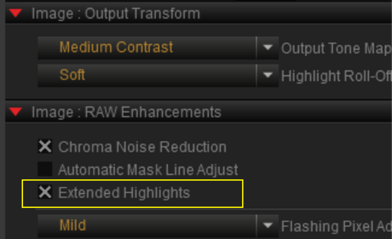

My correction of the "V-Raptor 8K VV-X SUNSET" clip in REDCINE-X with the "EXTENTED HIGHLIGHTS" Checked.

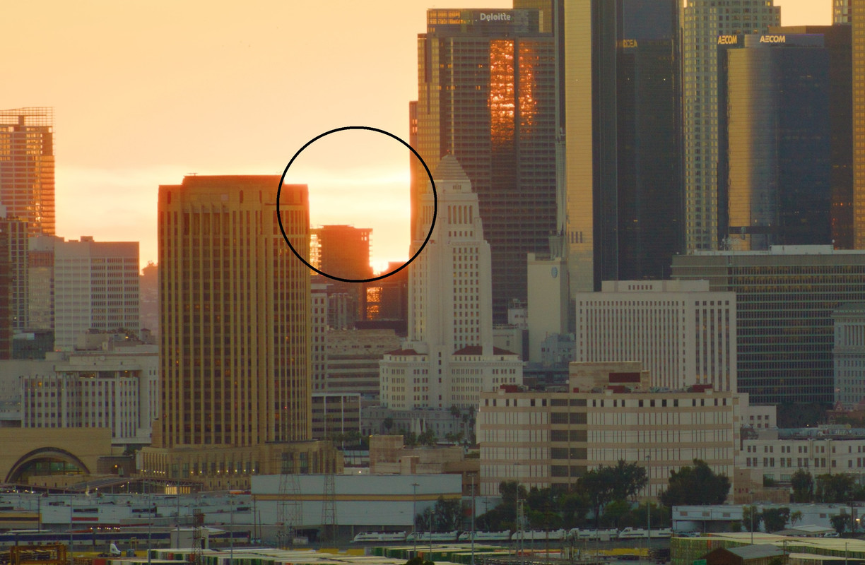

The Exported Corrected "V-Raptor 8K VV-X SUNSET" clip
Original
In REDCINE-X
Exported
EDIT:

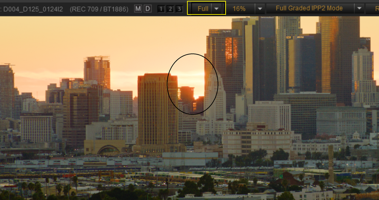

REDCINE-X was set to a LOWER resoltion 1/8 instead of FULL so the less than controlled HIGHLIGHTS were BLOOM from being set to a Lower resolution. MY BAD!!!

Yep, I think in REDCINE-X PRO you need to be in 1/2 and Full to "see" what's going on.
