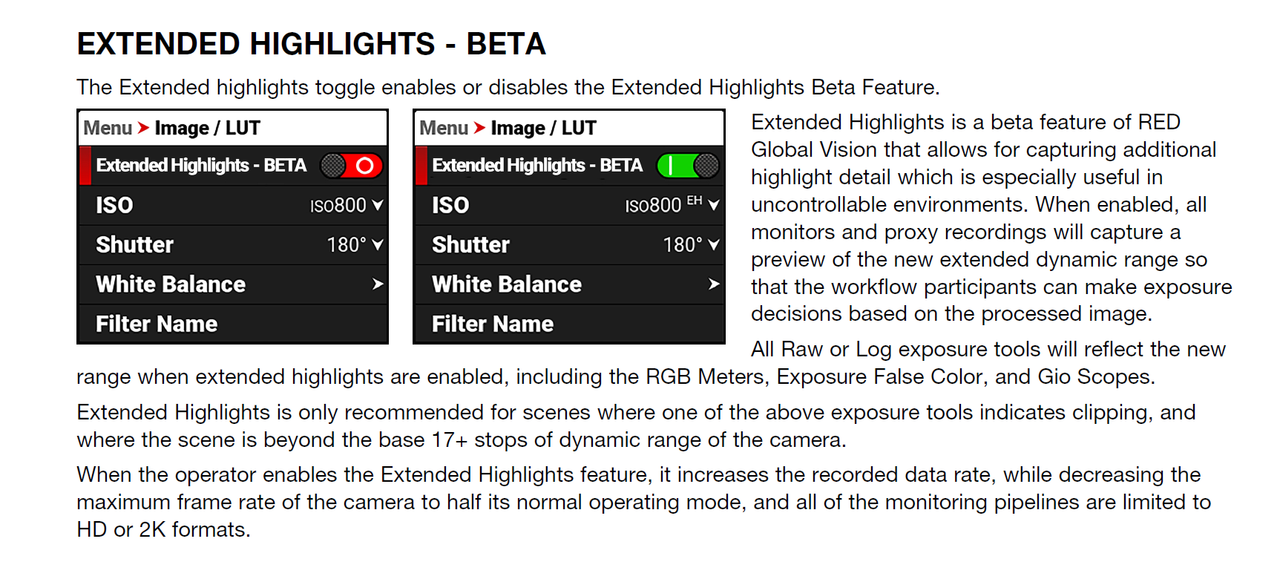

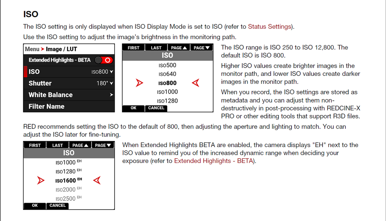

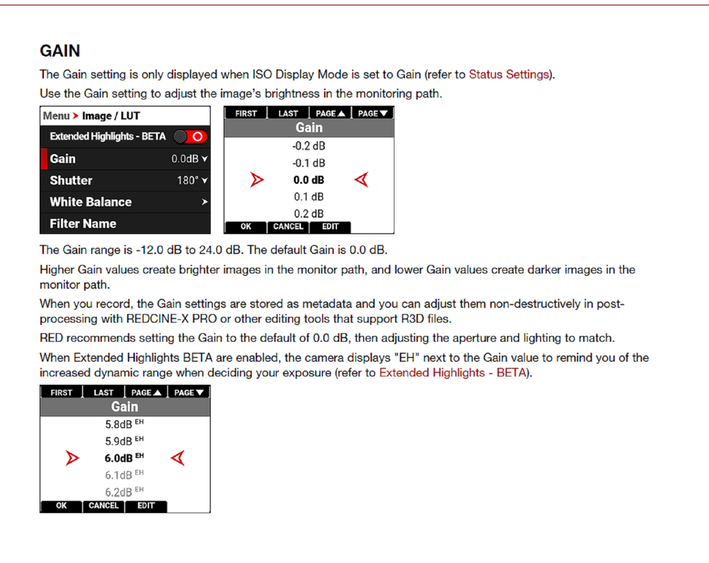

Are there any limitations for ISO when EH is enabled?
With V-Raptor -6 stop was usable can you say we didn't lose anything on shadow performance with global shutter?
Same for high ISOs..Are they at the same level as V-Raptor?

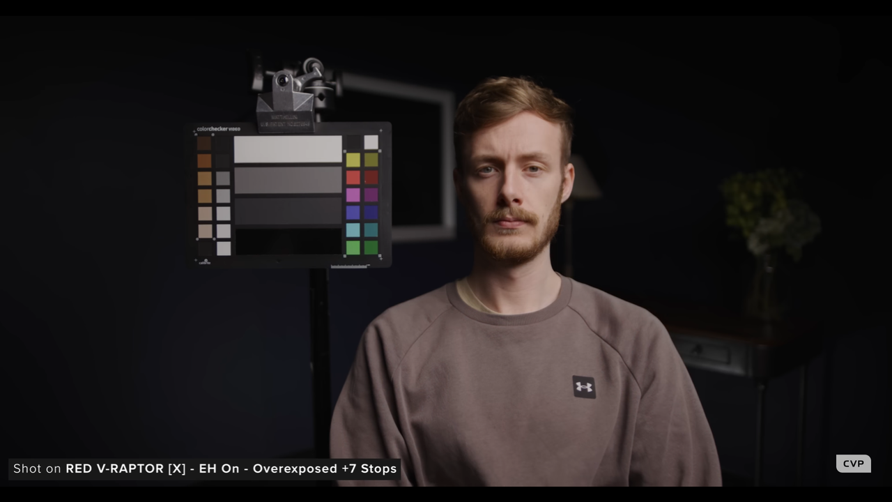

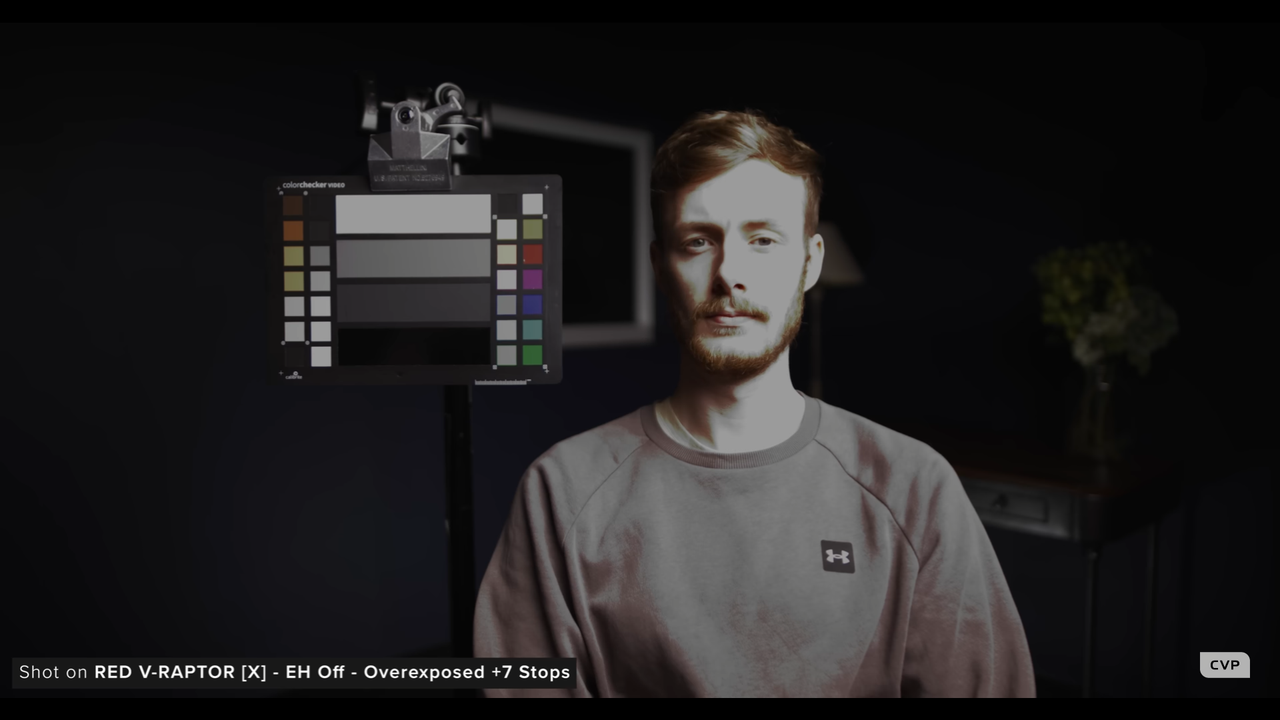

7 STOPS OVER EH OFF
7 STOPS OVER EH ON

Even the best Phase One camera can't give as much DR as the V-Raptor. And that's before EH is turned on. I wonder if perhaps photographers would sacrifice megapixels for latitude and frame rate.

Raptor X without Extended Highlights and with (toggled) = no loss of data in shadows. No loss in shadows when comparing to Extended Highlights off either.
There is an new ISO ceiling of ISO 1600 in camera. This is mainly used to not clip the encoded linear data, that makes sense. With Extended Highlights on you seem to have precisely 4 stops of headroom. 3+ is what RED is quoted, which is a safe and reliable metric. Looking at my tests I have a few things that are at 4 stops, but I suspect some of that is intensity or color related and 3 is the reliable number. I can get the camera to clip still, but it does take some effort under controlled lighting and with a fast lens outdoors in days you certainly can.
Have you run low light tests at high ISOs 3200 , 6400 and 12800 against OG Raptor? Like i said before Raptor was the best low-light camera (cinema line ) and hope this didn't change with the global shutter upgrade.
