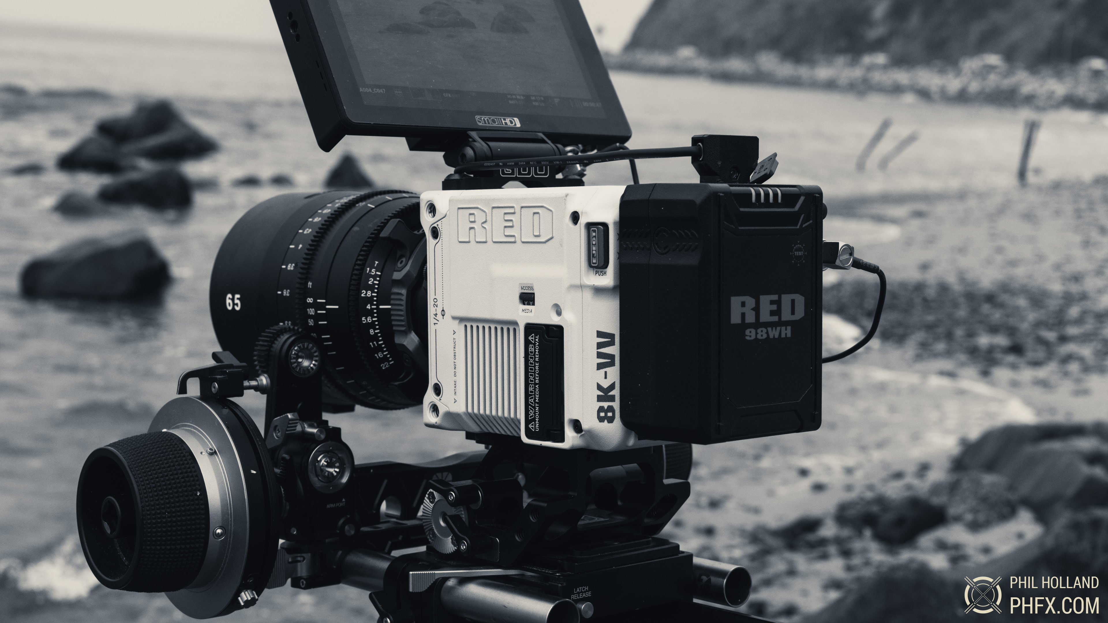

Hi Phil, Can I ask what mount you are using with built-in ND?
I used the prototype Breakthrough Filters RF>PL Drop-In ND Mount (Cine Gear timeframe will showcase I think the full kit, I've been testing this for a while). Interiors were the straight NDs, Beach was their VND. More of a choice of "need for speed" and keeping the camera small.

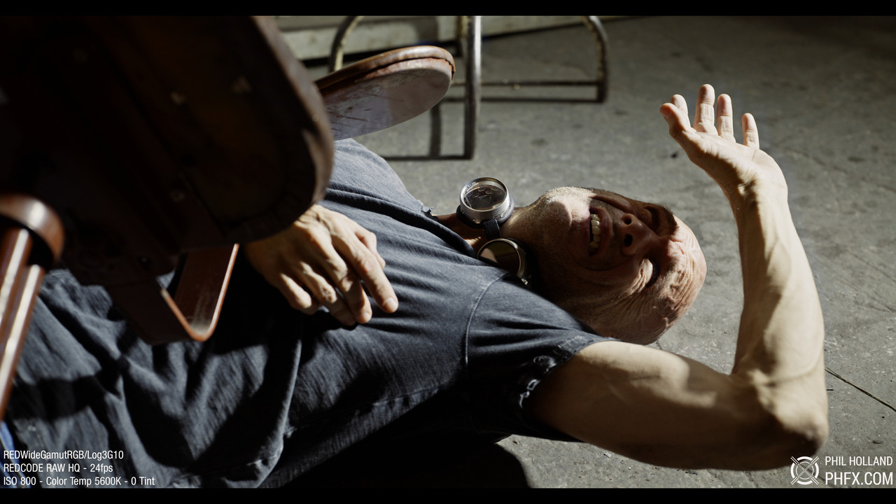

What I've been doing since is looking closely at the footage. I'm being reserved, very reserved, because I haven't conducted a round of technical tests to produce hard numbers. But V-Raptor shows it's strengths in a few critical areas when it comes to image quality.
Take what I'm saying with that in mind, also take the fact that I am rather intimate with all current cameras. Dynamic Range is on par or slightly better than Monstro, hard to know exactly just yet. Image is significantly cleaner in the shadows than the Standard or Low Light Optimized OLPF with Monstro. I often shoot with the Skin Tone - Highlight OLPF, significantly cleaner than that obviously. It's not actually just the shadows, it's noise improvements across across the board. Noticeable in midtones and down basically. Seems to be a bit more juice in the highlights. That's tricky to test without charts, but I grabbed a shot on a clipping lamp not to mention most of the sparks I shot were fully exposed given the relative light level.
I'd say that's impressively clean considering the ISO 800 120fps material I shot indoors.
Color-wise, it's very good. I'll leave that there for now. The new OLPF looks fantastic, another one I need to test further. The immediate standout IQ improvements I'm seeing are related to image noise and dynamic range. Like spooky clean for a RAW camera clean. Toggling CNR on and off via the SDK or REDCINE-X PRO is interesting and reveals additional chroma noise, but we're not talking a significant amount.
The cleaner shadows are fascinating as there's more color down there. Monstro already excelled on this level versus other premium digital cinema cameras, but this is something else entirely.

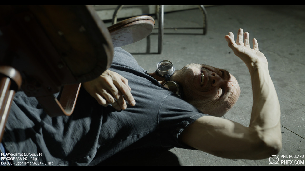

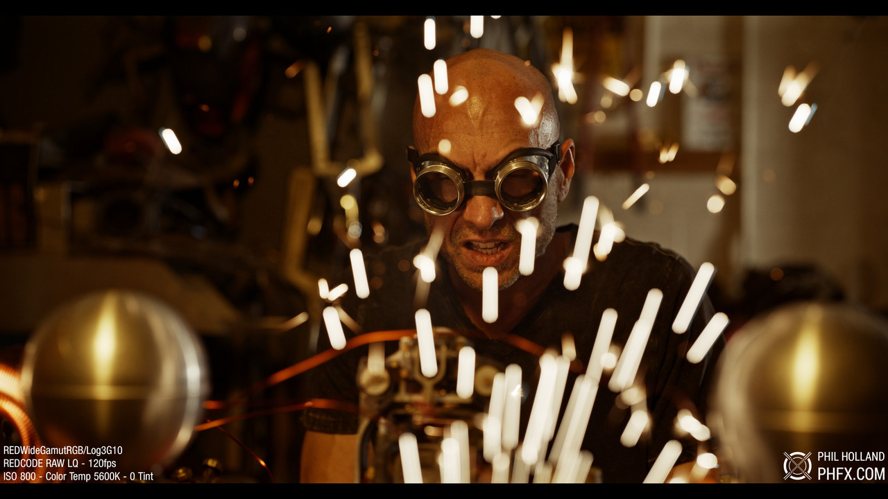

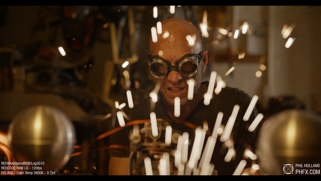

A couple of sample REDWideGamutRGB/Log3G10 frames, 8K full resolution. Full sized web optimzed JPG there and a link to an uncompressed 16-bit TIF. When I get the chance to shoot some additional material, I'll be making some short R3Ds available for download. For now enjoy these.
Awaken ISO 800 REDCODE RAW HQ
200MB TIF = http://www.phfx.com/temp/reduser/phfx_RED_VRAPTOR_RWGLog3G10_VM_awaken.tif
Sparks ISO 800 REDCODE RAW LQ
200MB TIF = http://www.phfx.com/temp/reduser/phfx_RED_VRAPTOR_RWGLog3G10_VM_sparks.tif
