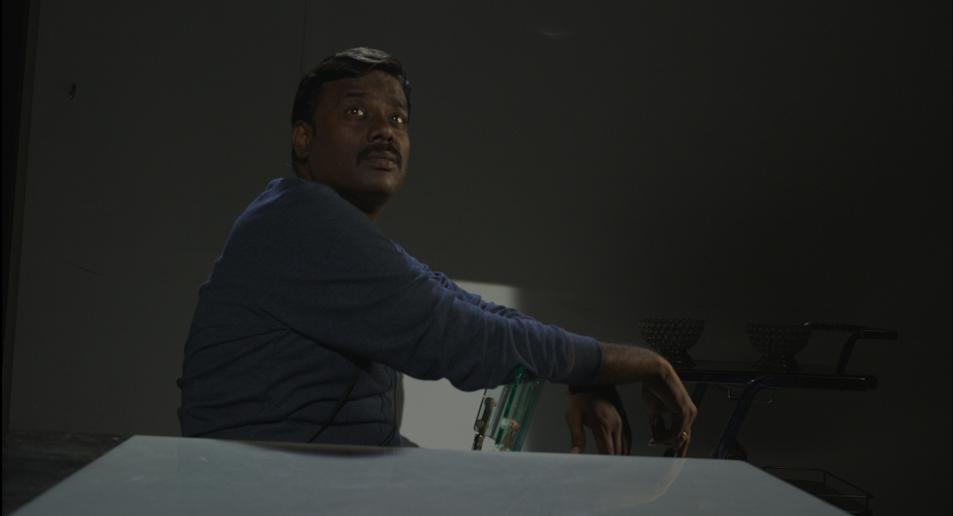

On the other hand, last month we shot a fashion film with the Alexa LF and here's a frame grab of my DP, Sivanesan, sitting in while roughing in the light:
His skin tone from the Alexa LF just doesn't look natural (I have other samples, but I can't post it here) straight off camera (LogC to 709, Resolve 15). But it looks amazing with fairer skin (our model was Caucasian). If somebody can share their experiences here that would be great.

Ultimately, with my limited experience with both cameras the argument for skin tones can be made both ways! However, as Phil's test shows, the Monstro is 'more camera' than any other.

That depends on quite a few factors, white balance and light being some of them. Also, the example you posted has generic LUT applied. All these tests are not tests of base camera image but tests of camera + transformation.
Red has superior separation in shadows so that helps with darker skin palette but final colour results depend on transformation from log/ wide gamut.
