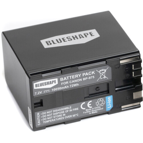

Christopher A. Bell
- Feb 22, 2019
- 409
- 5
- 18
Just learned something about the Canon BP-9xx batts. I've heard that Canon has in-fact discontinued them, BUT licensed them to BlueShape.
Just learned something about the Canon BP-9xx batts. I've heard that Canon has in-fact discontinued them, BUT licensed them to BlueShape.
Just learned something about the Canon BP-9xx batts. I've heard that Canon has in-fact discontinued them, BUT licensed them to BlueShape.
Just learned something about the Canon BP-9xx batts. I've heard that Canon has in-fact discontinued them, BUT licensed them to BlueShape.
I just recently got brand-new BPs from Canon through B&H so I highly doubt that is true.
Does anybody know how to enable the Hydrogen discount?
Hi guys.
1. As someone else previously asked, could someone please tell us how to use our hydrogen imei for discount (apparently it doesn't let you use it in the promo code field).
2. RF lens support not ready yet OR has been scrapped all together?
3. If we order now, are delivery times still expected to be Dec/Jan as mentioned a few days ago?
Guys, could we hold off on the ND/adapter, battery, random footage related posts until these questions get seen and answered please. Seeing as it's day1 of the official release
Honestly, you get more functionality keeping your EF lenses and using an adapter, since you gain the ability to have behind the lens ND(both fixed and variable). And from so many reviews and video's I've seen, using EF lenses on RF mount Canon cameras with the Canon adapters, the EF lenses performed even better(AF) than they did on EF bodies. I have zero plans to get rid of my EF stills or cine lenses. The ability to use a behind the lens ND system is a gift.
Got my order in within the first 12ish minutes but unfortunately my imie code wasn't working. Had to place another order much later (after I wrapped my shoot yesterday) in order to use my hydrogen discount. Really sucks that I have to give up my first/early order position to use the discount when it seems like many people had problems with their code not taking. (* Worth noting there was no problem with my code, I'm the original H1 owner and it worked later without having to reach out to Hydrogen/Leia or anything like that*)
