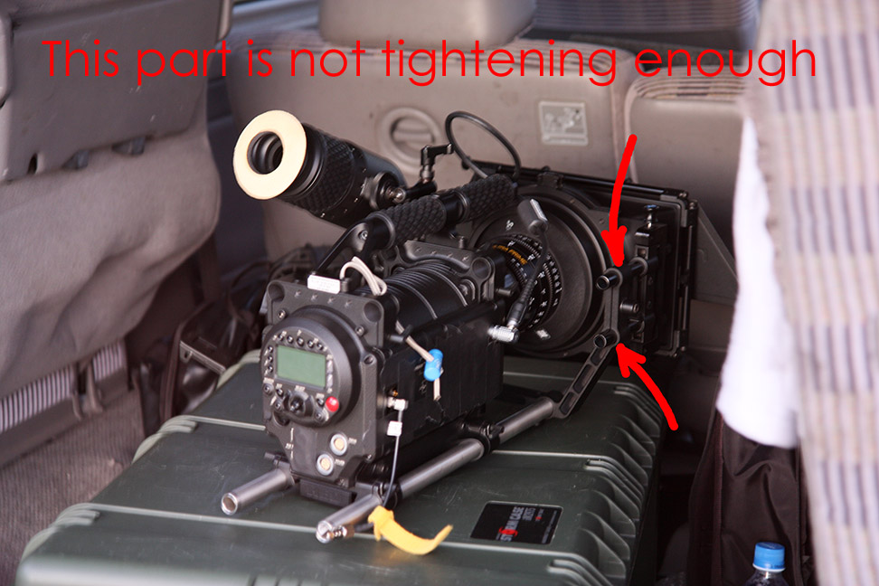

Brian, any tips on what to do if the arm for the matte box is a bit loose where it slides on to the twin 15mm rods? I've tightened the knob down as hard as I can and it still slides fairly freely. I have three matte boxes and this is only happening on one. Rest are fine.
It's not a huge problem as I can put tape in front and behind on the rods to prevent slippage but for the long term it does need a fix of some kind.
Cheers,
Paul
Paul, we have the same problem on two MB and we use multiple washers. That helps. But you still have to tighten hard. I'm worried the screw thread will crack up.
Thanks for the tip, I'll try it and see how it goes.

Update - the washer tip worked! Thanks again Alexander.
For info, I added two more of the washers that came with the kit and then tightened it back down. It is now grabbing the way it should.
Cheers all!

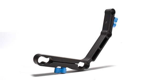

Hi everyone
FYI we are now shipping a 15mm studio arm - it's actually a combination 19mm/15mm studio arm, as pictured below:
It is available as part of our standard Red Bundle mattebox. At the moment it is only available in new microMatteBox bundles, but should be available as a standalone item shortly.

Hey Paul. I have the same problem with that screw not clamping down tight enough.
Brian, is there a fix for this? Should we contact you through RedRock. Seems like a common problem.
