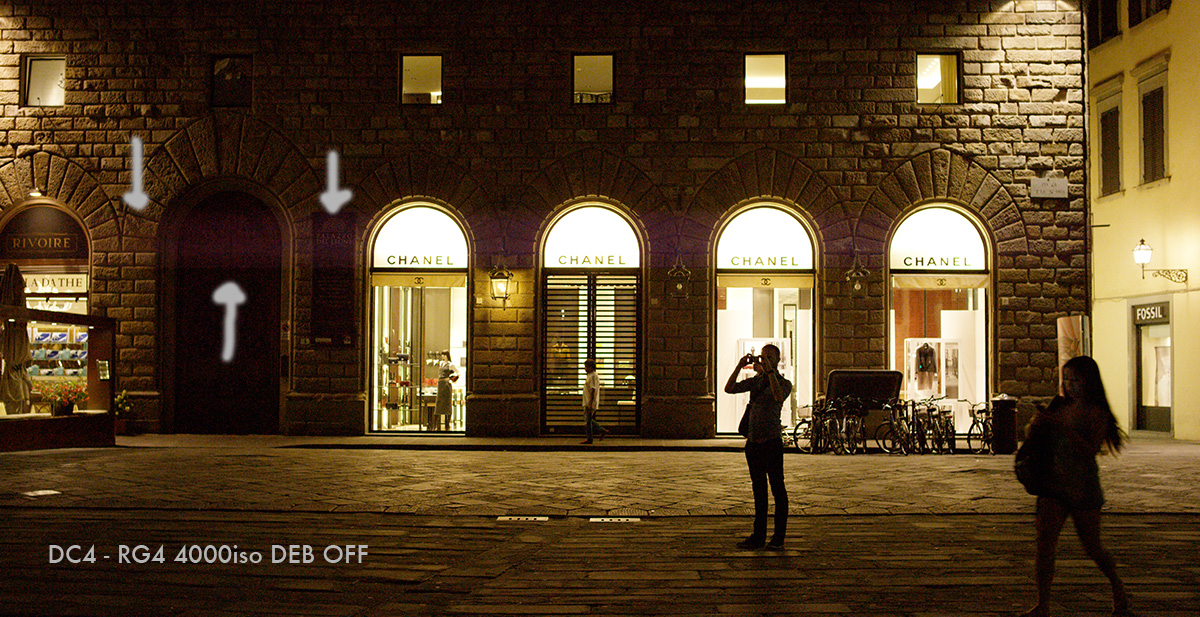

here is the answer to that question...
which is NO SMEAR ON WEAPON....
this is the same exact shot from two separate cameras on the same head
this is the Dragon with skin tone at 4000 ISO ( which i would never do in real life btw) DC2, RG4. 32 MM Master prime, 180 shutter no grade, straight out of RCX tiff Snapshot
weapon 6kHD low light OLPF, , 4000 ISO, DC2, RG4, 27 MM Masterprime, 180 shutter - no grade, straight out of RCX tiff Snapshot
