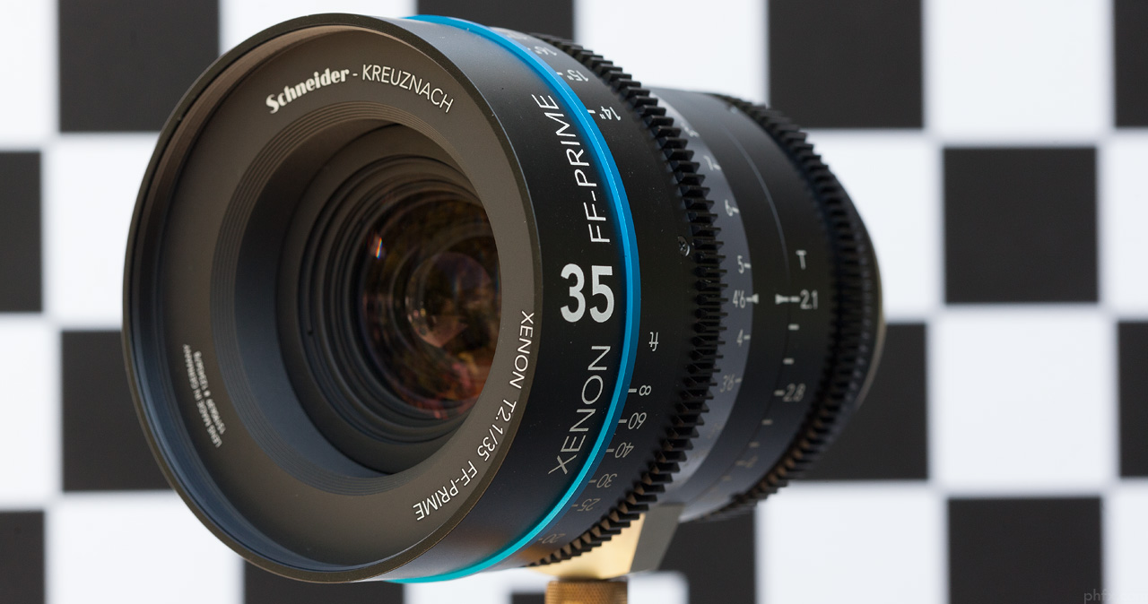

Build Quality

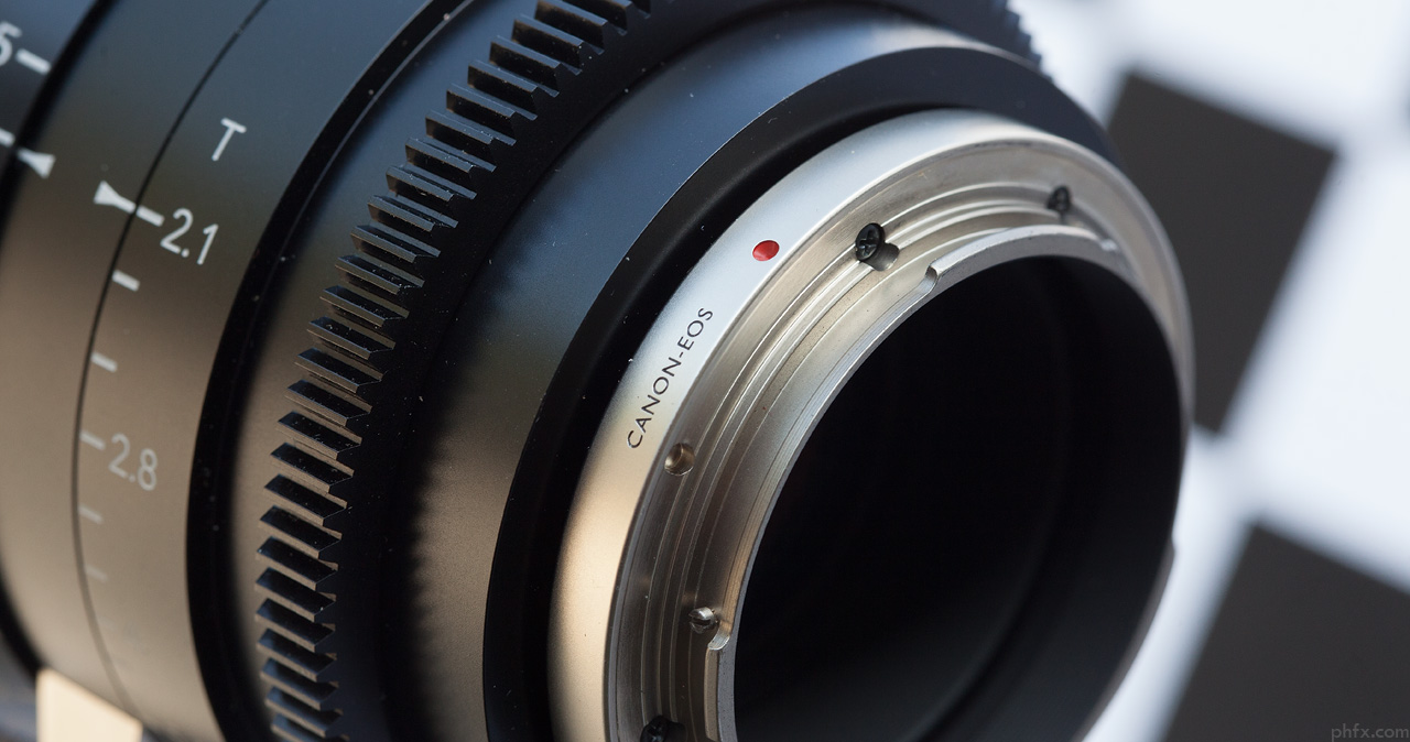

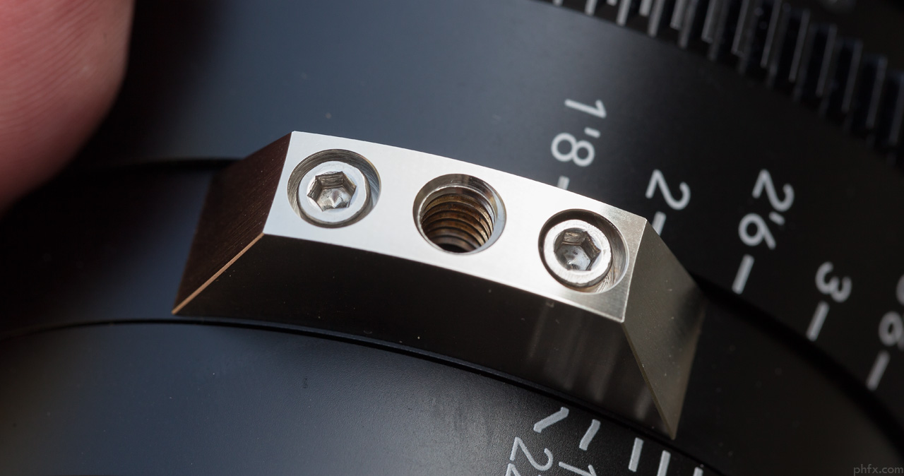

The very first thing you'll notice when you hold one of these lenses in your hands is that they are very well built. These are not toys, they are tanks. Clearly the Xenon FF-Primes have been designed to stand years production use and abuse. They are very solid and feel like a solid piece of metal and glass. That's great news.
I opted to test out the Canon EOS/EF Mount version to allow me to check out the full frame coverage. The first thing I noticed about the lens mount is just how solid it is. It appears to not suffer from the "wiggle" effect you get from thinner lens mounts like Canon and Nikon lenses. Ryan explained to me that the mount runs deep into the body of the lens.

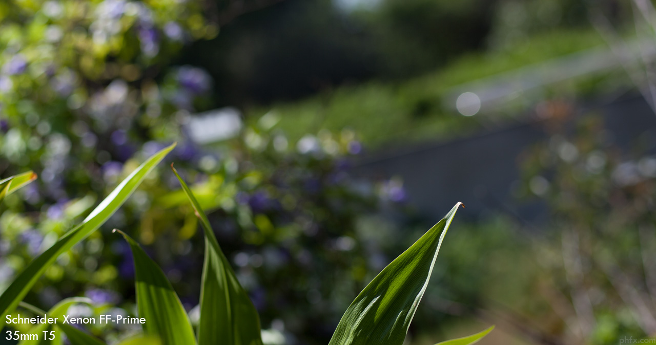

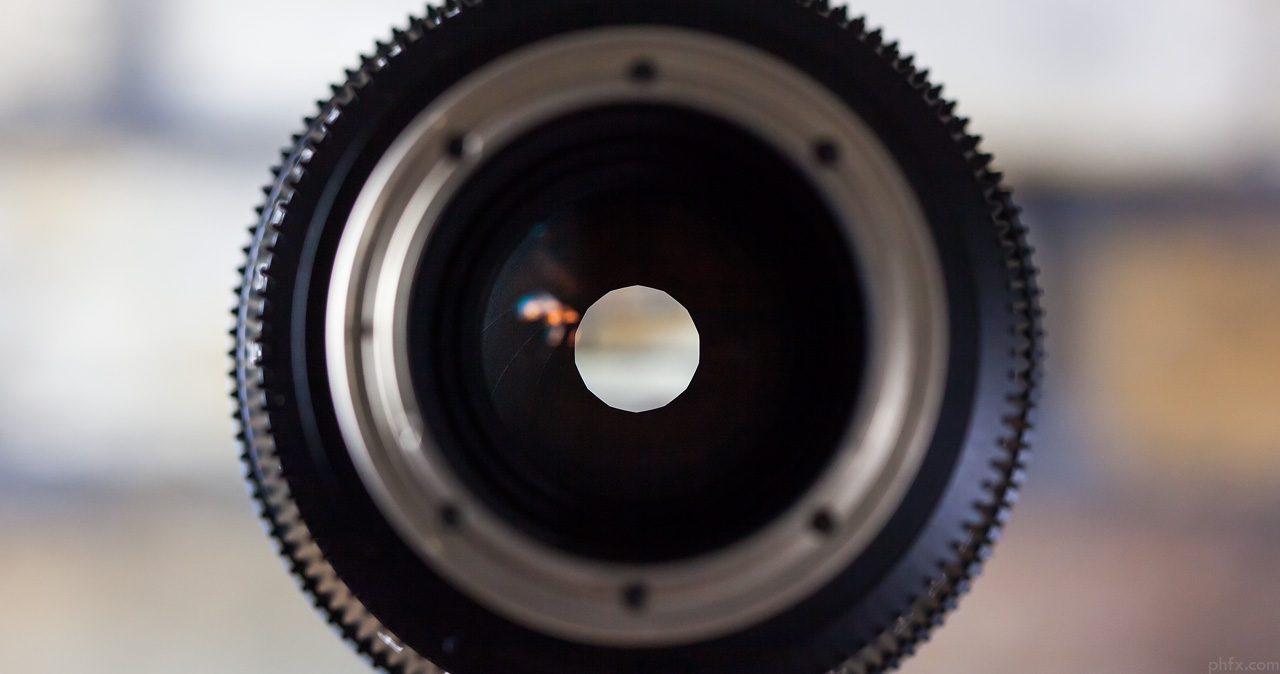

14 Iris Blades, Bokeh, and Out Of Focus Image
Iris design and blade count are pretty much create that unique look behind the out of focus image behind and in front of your in focus subject. There are 14 blades packed into the Xenon FF-Primes and they create a somewhat consistent shape and feel through the aperture range.
This particular design yields a more round/circular bokeh shape, which to me is very pleasing:

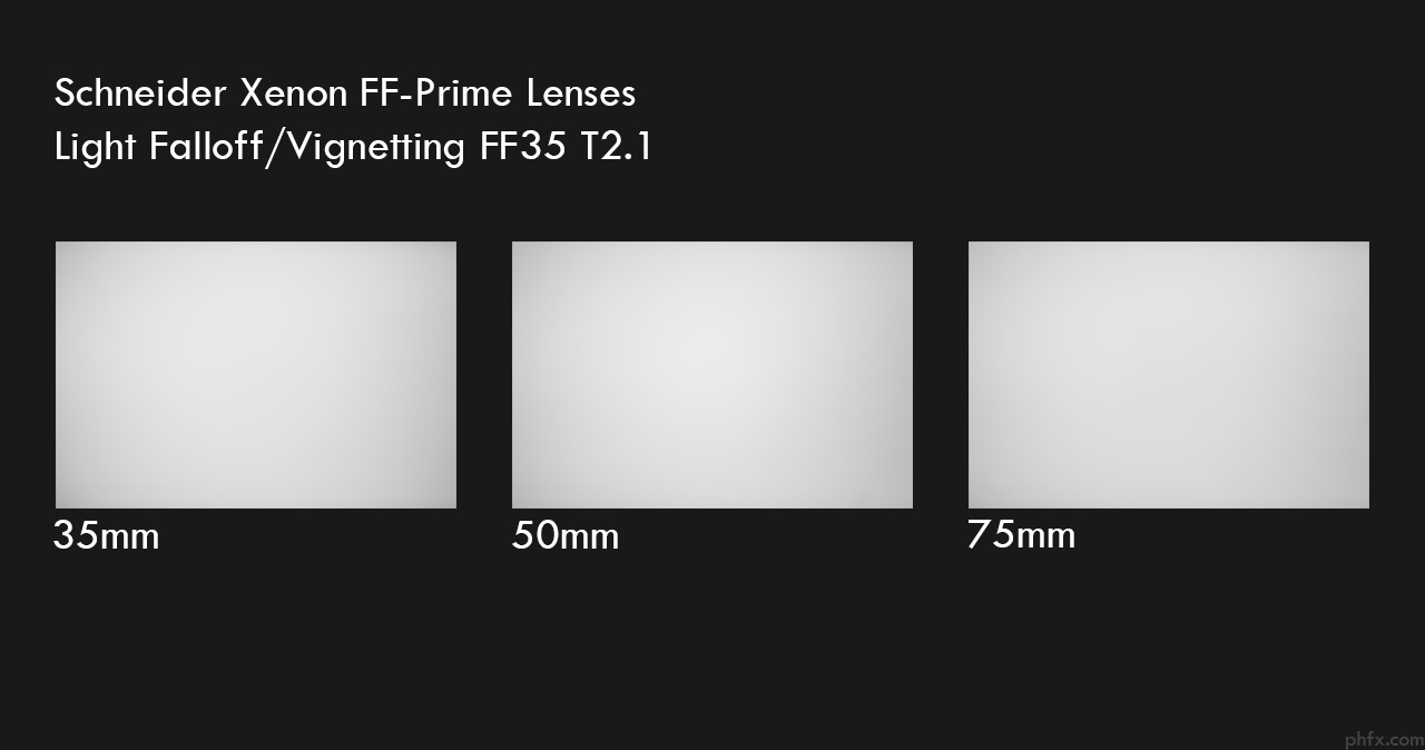

Light Falloff/Vignetting Wide Open
Wide open the Xenon FF-Primes produce a fairly flat image without noticeable falloff. This is good news for both Mysterium-X and soon Dragon shooters. I was actually surprised by these results and was expecting more vignetting overall.

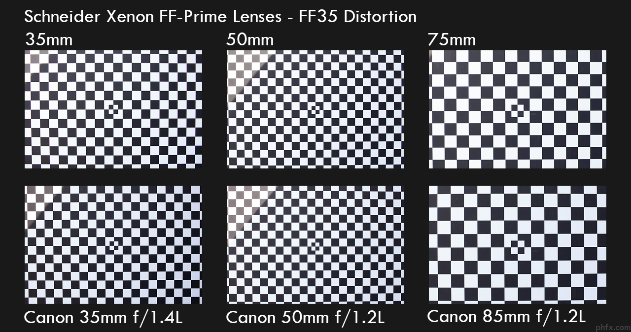

FF35 Distortion
I wasn't expecting to see much distortion on this set, but I did decide to compare the Xenon FF-Primes to their Canon equivalents to see how they fair against similar competition. The 35mm Xenon FF-Prime has a bit more of a bulge compared to the Canon 35mm f/1.4L, but nothing that I feel would distract from the image. The 50mm and 75mm were fairly flat and looked good to me.

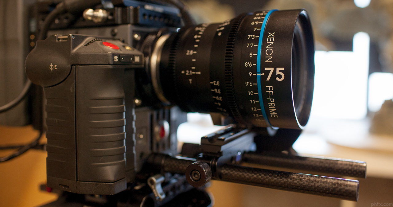

I ran each lens through about 200 focus pulls each. I also tried configuring the camera in a variety of ways to see if there were any clearance issues or odd roadblocks when working with follow focuses. I was particularly curious about the removable lens support bracket and if it could remain attached during normal LWS operations:
This will be nice to use with lighter cameras or if you are looking to really lock down the lens on your rods. Happily I was able to clear it with the Redrock Follow Focus|blue that I often use:
I was also mimicking some general production workflow and swapping out lenses with and without a matte box. Pretty quickly the consistent size and gear spacing impressed the heck out of me. Lens changes don't require an adjustment of the follow focus position, same goes for users who use swing away matte boxes. That makes these ideal for run and gun or any sort of speedy workflow. This also can help keep your rig compact by using specific sized rods to your Xenon FF-Prime setup and you won't need anything longer or shorter for any reason. Nicely done.
Pulling focus with 300 degrees of rotation is an utter joy for me and ACs will appreciate that as well. I plopped the camera down in front of a bush and as the wind blew the larger leaves around I was able to track them with ease and precision at T2.1. The big difference here against say modified still lenses or just lenses with shorter throws is that you don't have access to that level of precision.
I found that I enjoyed operating with a speed crank attached which enhanced the precision and control even further while allowing more access to "different gears" when you need it. This is how I prefer to use cinema style lenses as well when self operating.

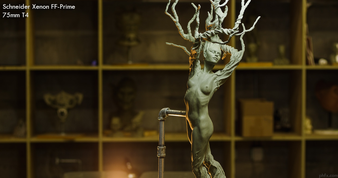

The Schneider Xenon FF-Primes provide nice usable image wide open. The resolving power is decent and in line with mid-range primes across the board. After experimenting for a bit I found that these lenses really sing around T2.8-T4. They have almost a classical feel with the current coatings and flare protection. Overall they render a slightly, very slightly, less contrasty image compared to the Canon primes I compared them too, which added to this classic feel. They are warm, but not warm like Canon K35s. They also have a "glow" about the highlights that's also similar to that classic feel. Which can be quickly wrangled at T2.8 if that's not the look you're after.
Here's some grabs from graded .R3Ds of a sculpture by one of the students at Gnomon, Brandon Love.
