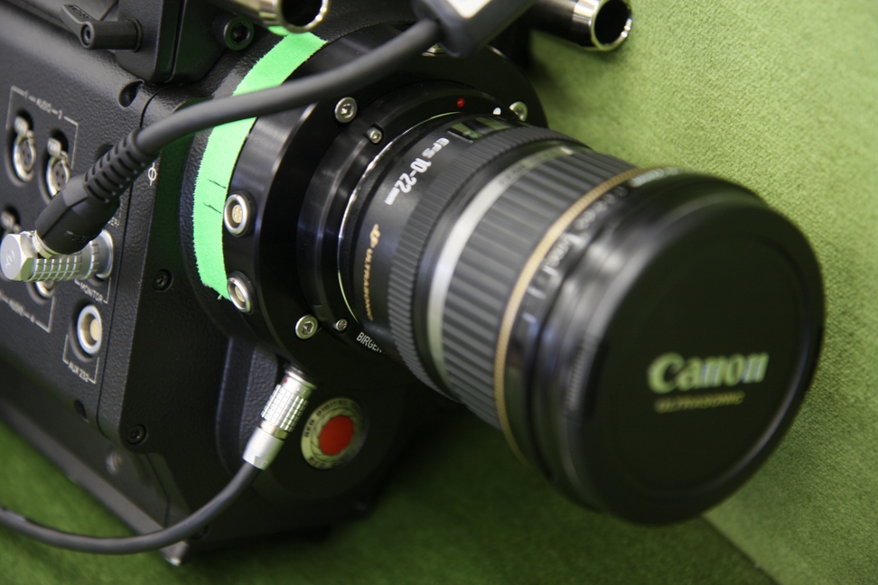

I've used the Canon EF-S 10-22 on my Red. It's f3.5 sadly but then again, show me a faster 10mm lens for the Canon mount and I'll buy it! Oh how I want a 10mm fast Canon prime....
Quality of this lens is great though, sharp open and razor sharp by f5.6. Highly recommended even though it's not that fast.
