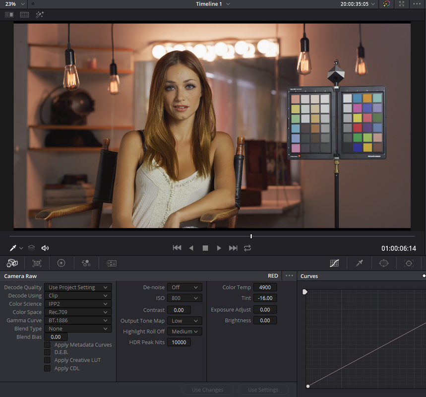

Also, most experienced colorists can work faster in Rec709, at least assuming that's what they're used to working in. There are pros and cons to confining your working color space to a specific range. Most of what I do mixes footage from different sources, so it's better for me to use a display-referred system. Use whatever you're comfortable with and what works for the project.

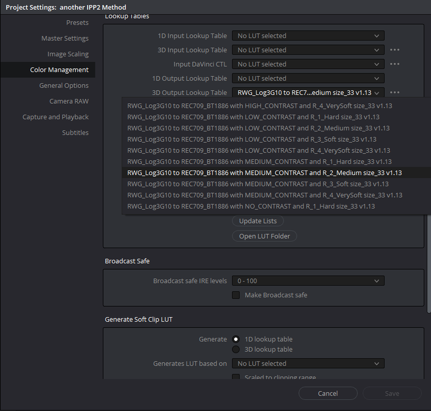

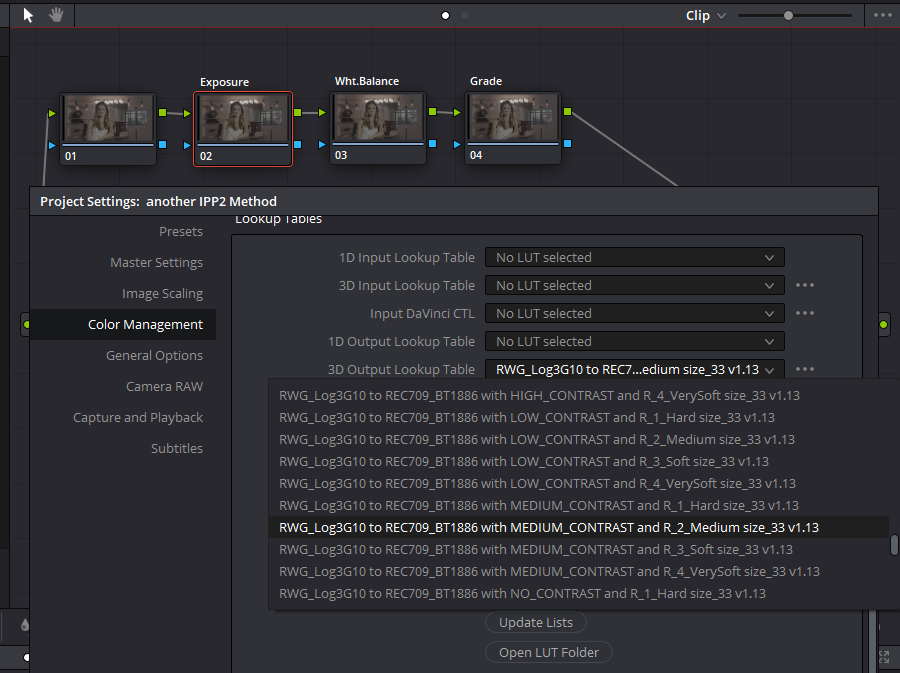

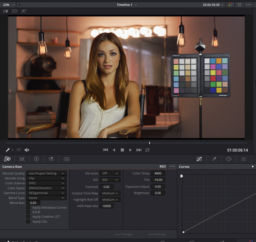

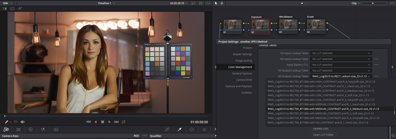

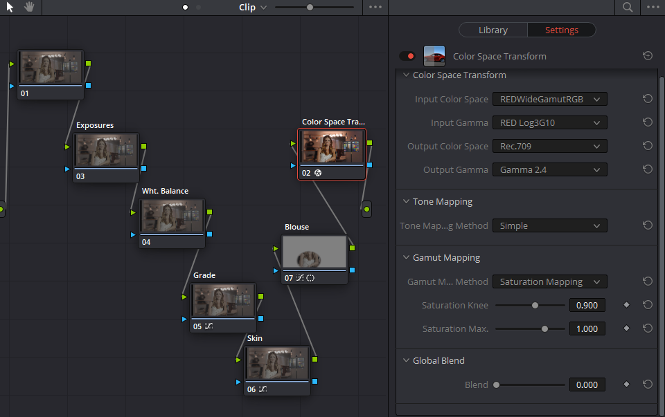

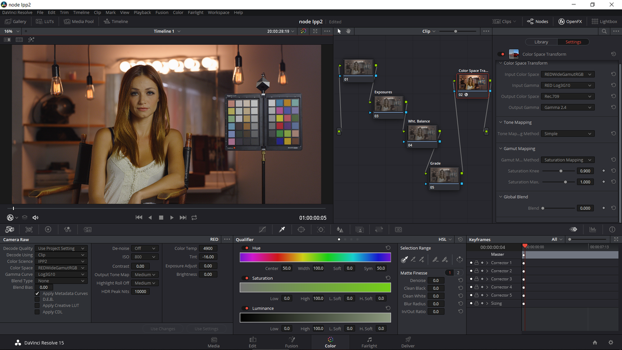

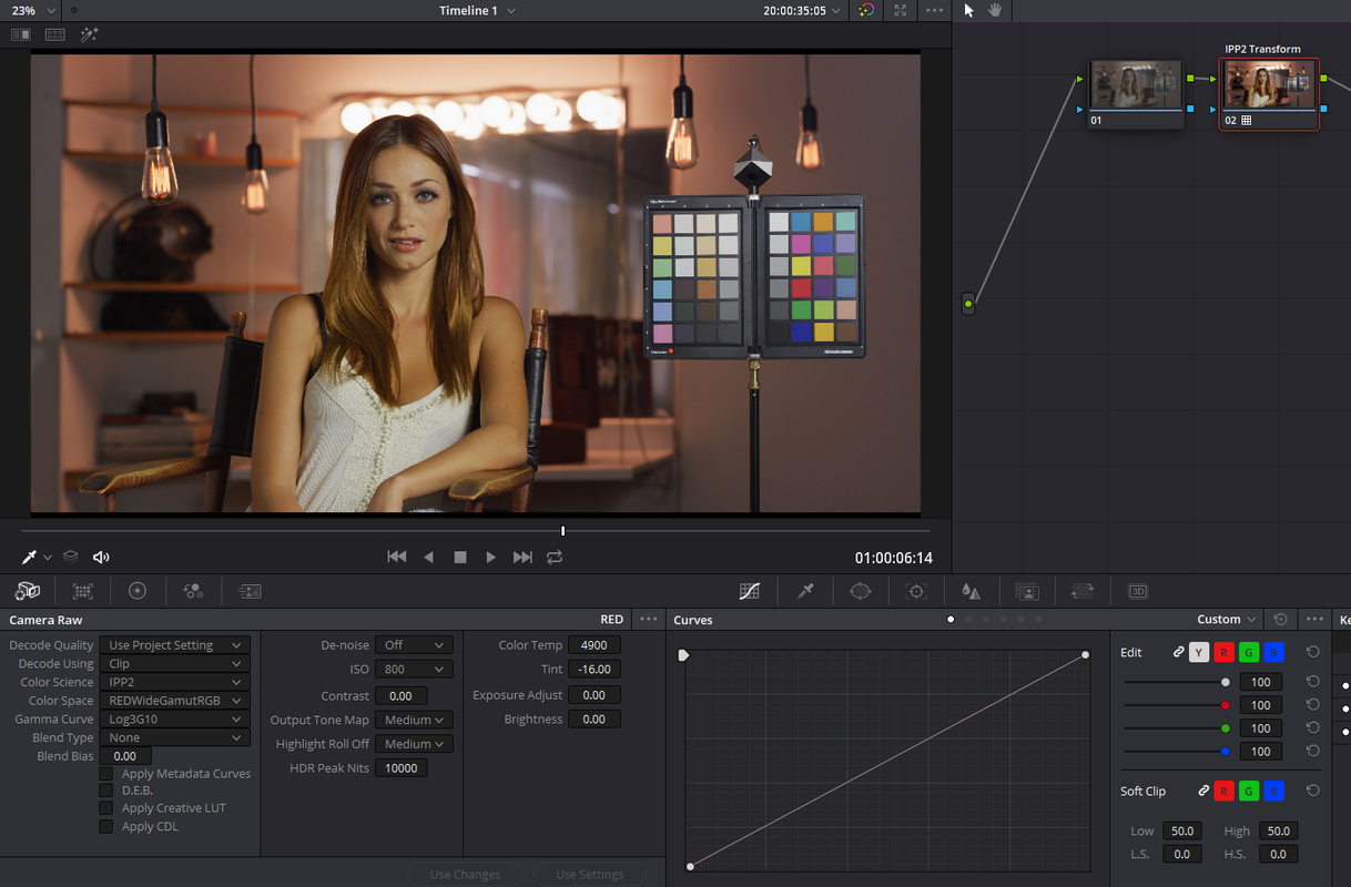

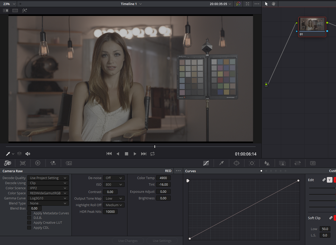

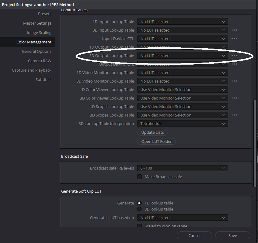

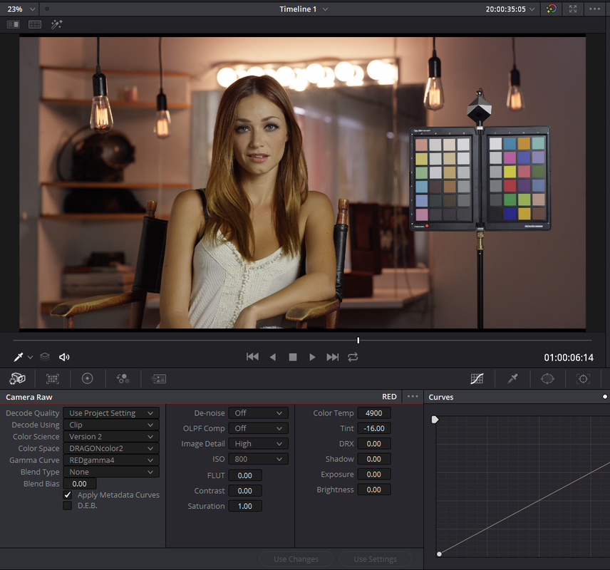

The problem with color managed is that you can't change your Decode setting (gamma, gamut, output tone map,...) in the color tab when "Decoding using : CLIP"
