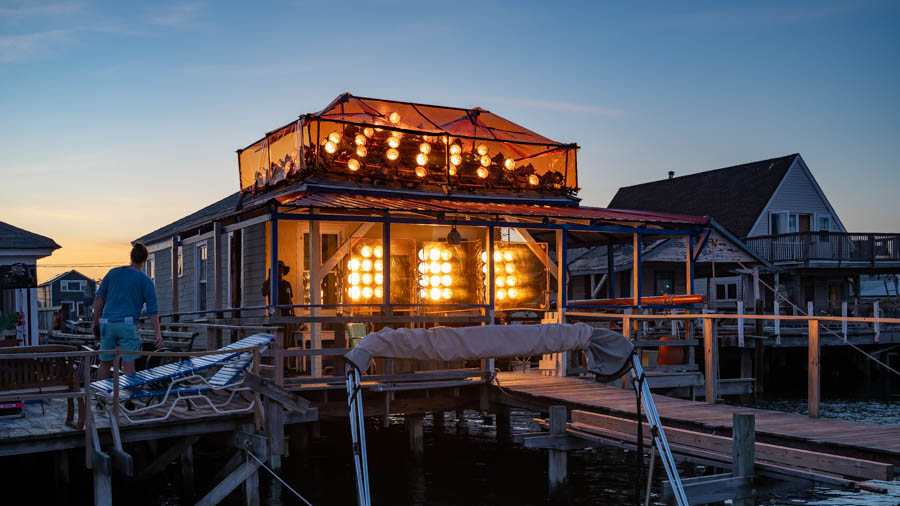

I saw your instagram post about the burning house shot for Mrs. Maisel. I was curious... you said you wrapped the house in Broad Channel. What is that? From the picture it looks like the pars on the roof were enclosed in an entire strucutre... of CTO? Why did you wrap it around the sides as well, and not just the front? Is it to make the light bloom on the sides as well? It looks like on the maxibrutes on the porch, you only put gels in the front...

We smoked up the area so there would be white light mixed into the orange if hadn't covered everything with gel. But I could have just gone ungelled and dimmed everything for warmth and used a higher Kelvin setting on the camera too.
