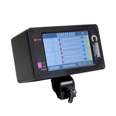

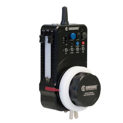

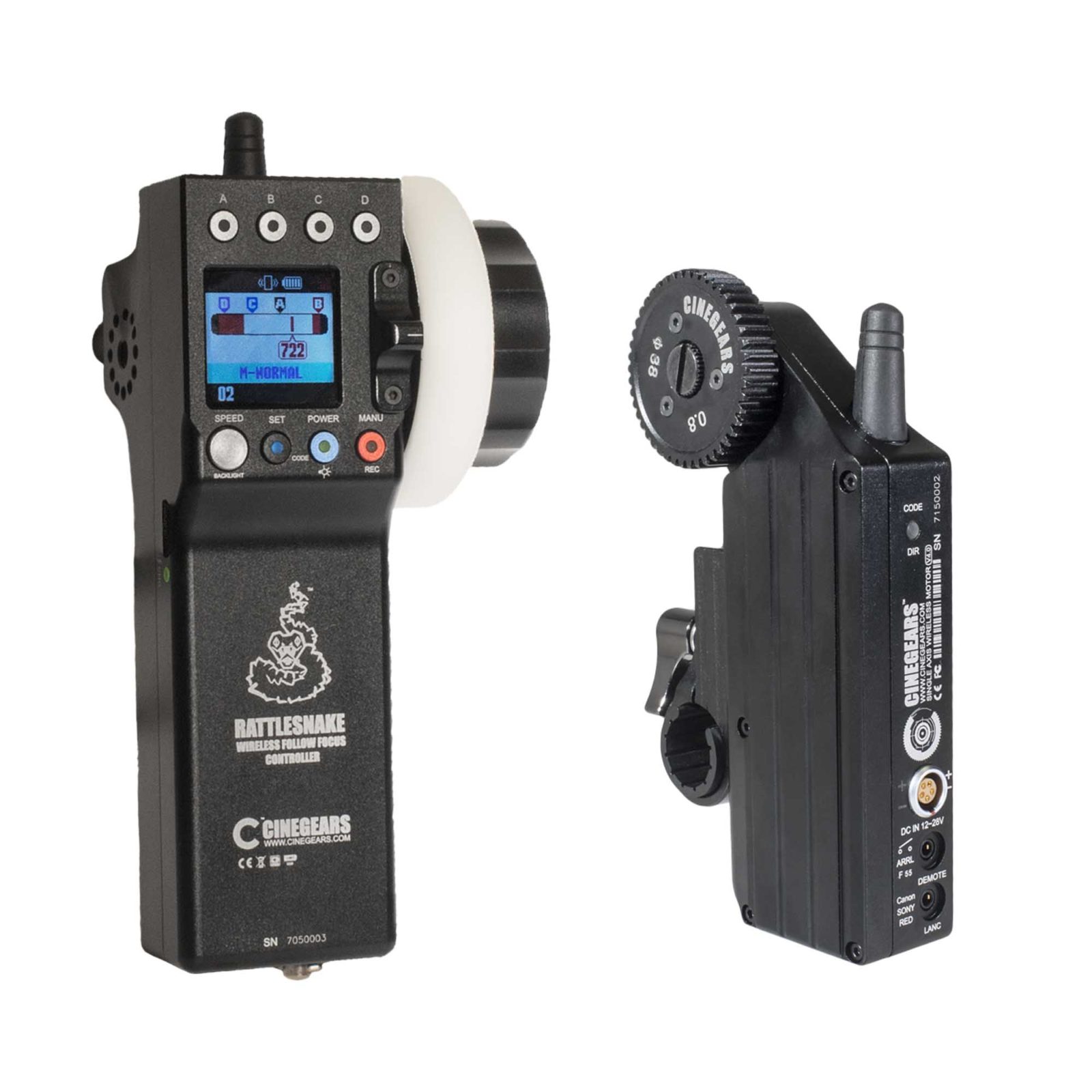

Many professional focus puller love Cinegears wireless follow focus products, put it on Red ZOOM, ARRI Alura or Ultra Prime, you will see the difference.

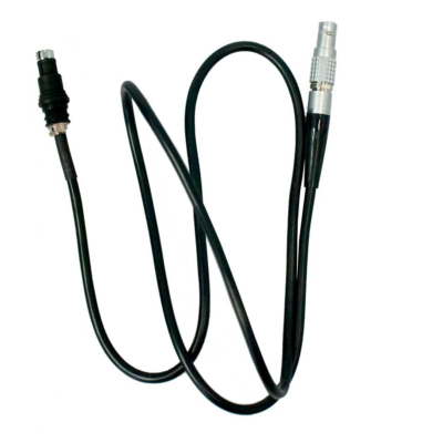

Cinegears also make Multi Axis wireless follow focus system V4, 2018 upgrade model come with High toque Motor and touch screen receiver, full set of start stop trigger for ARRI, RED DMSC2, LANC, get the job done nicely.
