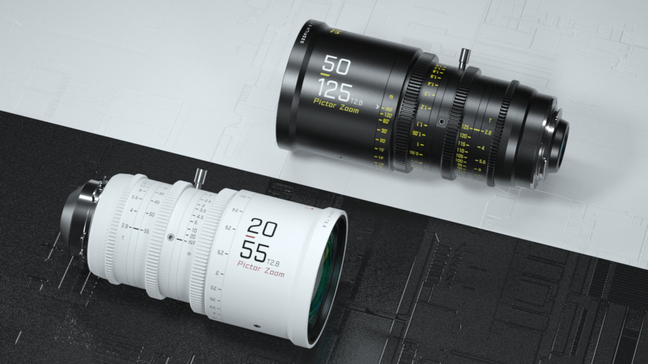

Phil seems like the Loawa has much more "character" and less contrast than the DZO. Can you elaborate anymore on the DZO?
I'd agree with that, the OOOM has more classic vibe, but still pretty modern. The DZOs are a bit cleaner, but due to their compact nature have a bit more distortion on the wide end as well.
Harder questions to ask about these honestly. For about the same price you get 1 zoom with a broad range in a larger form factor, or 2 zooms with more range when combined and shorter/smaller individually.
Price-wise, both are really alarmingly good deals. I mean nearest competition is twice the price and then it's the rehoused stuff that's not parfocal.
I do think the Sigma 18-35mm is a good choice and even shorter in length physically and focal range. I have the Tokina 50-135mm here as well, if they have their mid-range zoom done this would be a super spicy battle. Their 11-20 though is gold and seems to be the goto solution on the wider side if you need it. Not seeing much overlap there.

Care to quickly compare/contrast the DZO to the tokina 50-135, price not being a factor? Thanks

I love the white ones. They are really cool. But $900 more than the general version.
