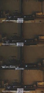

Here is a frame size test. 6k, 5k and 4k. Then 4k with the speedbooster.
With the speedbooster the frame size is greater that 5k and not that far off 6k.

Currently there are 4 types of optics from metabones, right? 0.71, 0.71 Ultra, 0.64 (BMCC) and 0.58 (BMPCC).
In theory 5kFF should be possible with a 0.71 speedbooster. 4kFF with 0.58. Well, if calculated with 36mm width for FF35 lenses... So i wonder why 4k is currently the usability limit. I mean, usually the 0.71 e-mount speedboosters are used to get FF35 to APS-C (which equals 5kHD Dragon).
