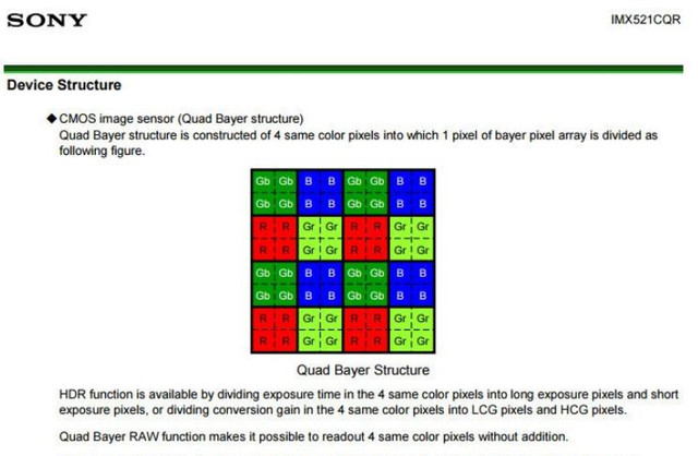

BTW, what's your bet that inside this is a 48mp quad bayer hard-wired to 12mp mode? Would explain the latitude if some of the pixels were at different sensitivities similar to Alexa / Canon dual-gain.
I'm not sure that dual-gain has anything to do with the Bayer filter. I think its has to do with duplicating the output of the sensor before it is debayered, then amplifying one dataset, then merging them together, preserving the highlight data of the non-amplified dataset. Or some shit.
As the for the Quad Bayer pattern - it could be the case. I don't know if anyone has said anything about it yet.
This is an old misconception. The finished resolution of a 4k Bayer image that is processed to RGB is still 4K. If it is processed to 4:4:4 RGB color space fully sampled, it will still be a full pixel for pixel 4K image with every pixel a fully defined RGB color pixel. There may be very slight loss of red/blue channel spatial density which is perceived as a blur, but nowhere near the loss of 4:2:2 or 4:2:0 sub sampled video.
Sophisticated Bayer color filters all have some overlap in filter values such that a red pixel is not pure red but has some blue and green value. Green has blue and red values, and Blue has red and green values. Modern Debayer algorithms and advanced color science can accurately interpolate those value differences for full luminance resolution and nearly full color resolution.

those are some pretty words, but don't you lose like 25% resolution?
Bayer pattern is brilliant but not THAT brilliant. You can debate overlapping filter values but let's be clear - you're only capturing one value per pixel. It's not as bad as 3:1:1 but it's not exactly 4:4:4 either. And if you have too much of an overlap in filter values, you get into some very wonky color issues because you're subtracting colors from each other to get "pure" values.
The other thing you're overlooking is that the OLPF has to be tuned to not produce horrid color moire... so the OLPF for a 4K Bayer sensor movie-optimized camera will be pretty soft.
If you compare a7 mark 3 (6K bayer downsampled to 4K) vs a7s2 (4K bayer to 4K) for video mode... a7 mark 3 has more real detail, a7s2 is a bit either soft or oversharpened.
