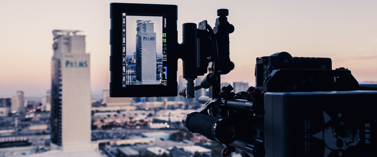

I have been experimenting with my Scarlet as a stills camera (although I used an Epic here) and have been loving the results of 5K raw images. Only issue is weight and ergonomics. The touch screen is not useful outdoors without a shade but with a shade you're stuck with side handle controls and glare. Switching over to the RED Bomb EVF is great for focusing but placement is everything.
First I started with a short arm mounted on top. The eye piece worked best when held portrait, but was awkwardly high for landscape.
Then I added a cheesy base plate and this brought the eyepiece down but made Portrait awkwardly low and the camera high above your head.
Finally, using an small right angle bracket with a 1/4x20 slot, I could try the first setup again but the with eyepiece closer to the brain making both landscape and portrait comfortable. For power I'll be using a v-mount battery belt
And for fun, a medium format mode made for waist level landscape shots
]And for fun, a medium format mode made for waist level landscape shots
