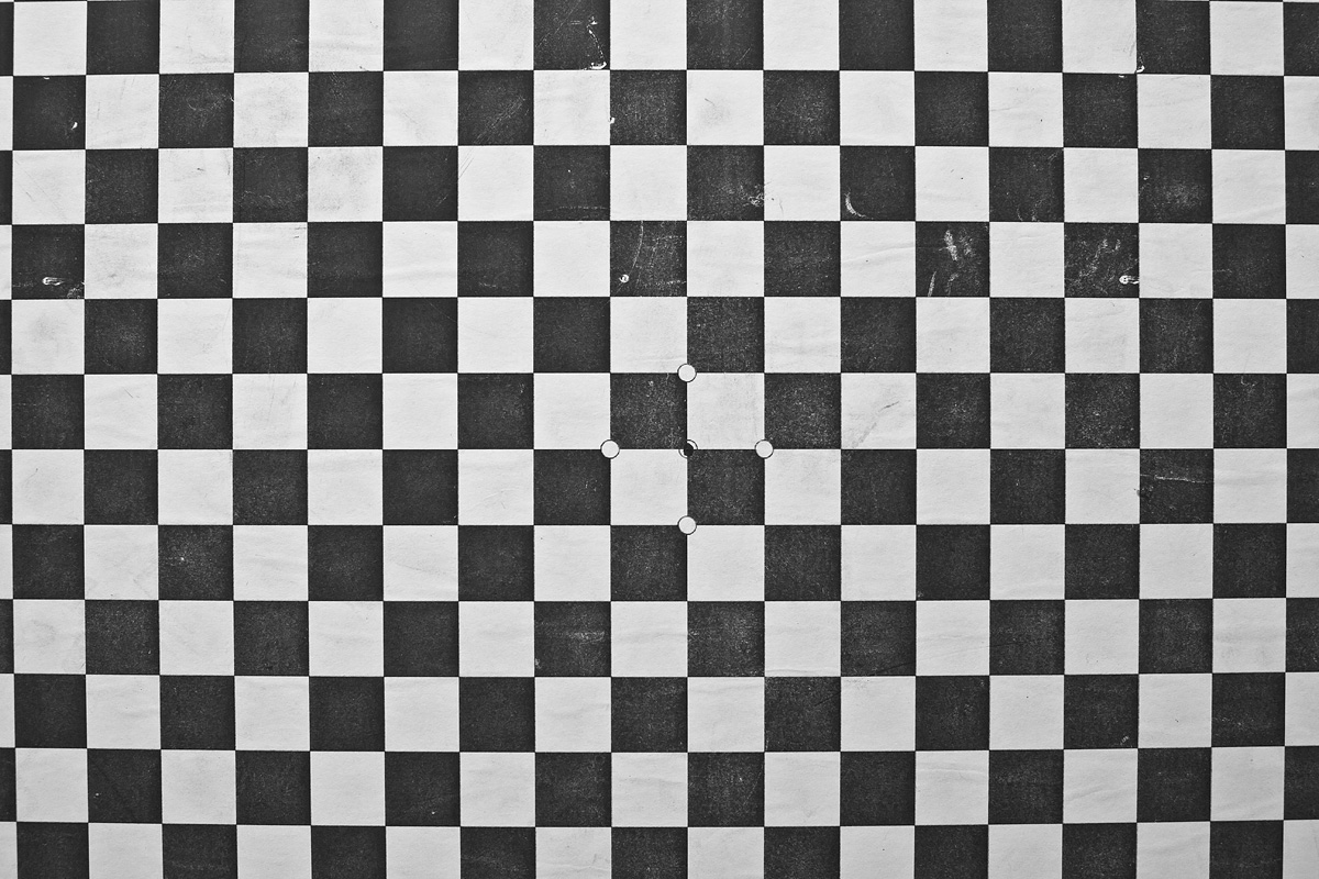

(here's a distortion chart for the 90mm)
And the Elmarit 60mm f/2.8 Macro:
(here's a distortion chart for the 60mm)

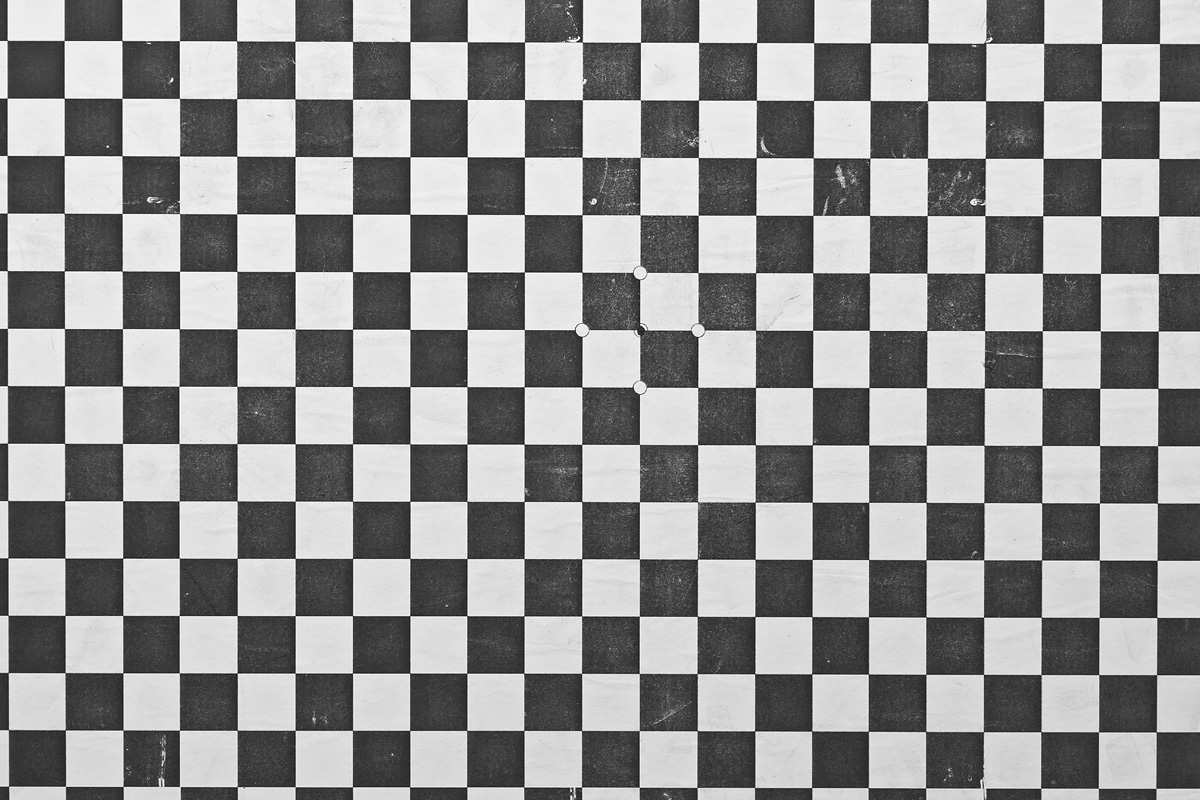

Another lens to look at is the Voigtlander 40mm f/2 SLII. Wide open it's not the best thing on earth. It got a unique feel, built very well, and is extremely compact.
(here's a distortion chart for the 40mm)
