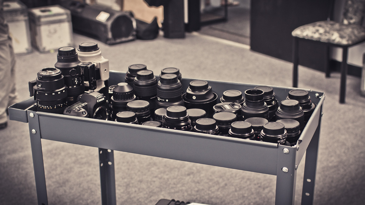

Part 1, Metrics:
Projection:
The below results were attained using the lens projector at Duclos lenses that is set up in it's own room, specifically for the purpose of evaluation of optics on an even playing field. The same projector and screen were used for all lenses and the distances were maintained for the equivalent focal lengths (3' for wide lenses, 6' for teles). A loupe was used to determine resolution in line pairs per height and width for the Center, Field (middle) and edge of the frame based on a super 35mm motion picture frame roughly equivalent to the Epic and Red One's image area. Although the projectors reticle has the markings for full 24x36mm still format some lens mounts vignetted this a bit and made any attempt to gauge full frame still corner resolution moot. All of the findings below should be interpreted as applying only to the Epic/S35mm frame. Lastly, although we did measure the lenses in line pairs this is an observational procedure and rather than deal with the political ramifications of publishing these absolute numbers we've decided to present them as they apply to the Mysterium-X sensor in the Epic and Scarlet. The data presented below is such that even measurements with a "Fair" grade will, for the most part, resolve the full resolution of the sensor.
Notes:
Where you see notes in the table below represent specific observations, if a field is blank that means that the lens performed average for that metric. If it was either better or worse or particularly apparent it was recorded.
Perspective:
The last thing to keep is mind to take these results with a grain of SALT (Bad joke, I know) but numbers are not pictures, there really were no dogs here (OK maybe one) but for the most part the differences were about personality, not quality.
Some general observations from the projection:
Cinema:
The Optimos were extraordinary, other than some odd distortion you really see the performance and what you're getting for your $20K+. They out performed every other lens prime or zoom and had zero visible CA or veiling flare.
The Duclos modded Tokina takes a great little optic and corrects for the inherent image shift, de-centering and other aberrations that the stock still lens displays, more on this later...
Canon L:
The Canon's performed quite well and overall had the lowest distortion of all the group, but also the most CA.
Leica R:
The Leicas we're less stellar than I expected in resolution but contrast was really good. They all have a unique quality that focuses the highest resolution to a slightly different plane than the highest contrast. This is the reason they all seemed to project a lot of veiling flare, but in actual photography it may not appear at all like flare, it's most likely what's responsible for the so called Leica "Snap".
Nikon G:
Although they performed great I had expected these to post higher scores, but what was apparent was their great contrast and how well they controlled flare and CA, especially the harder to deal with axial CA and purple fringing. The trade off seems to be a bit more distortion.
Zeiss ZF: (Same optics as ZE & CP.2)
The Zeiss wides performed quite well but the 50mm was the only real disappointment of the test. Weaker than all the other 50mm lenses including zooms. The 50 and 85 also suffered from a lack of contrast overall, of course that could be a good thing when shooting faces.
The 70-180/200s:
These three lenses, the Canon 70-200 IS II, the Leica R 70-180, and Nikon 70-200 VRII were all stellar, with the Leica being the only lens in the test to get a perfect score, with an astonishingly high level of detail and contrast and just a slight hint of veiling flare. The Nikon was just as good in the center and field only giving the corners up slightly to the Canon which had very even resolution across the frame and just slightly lower contrast.

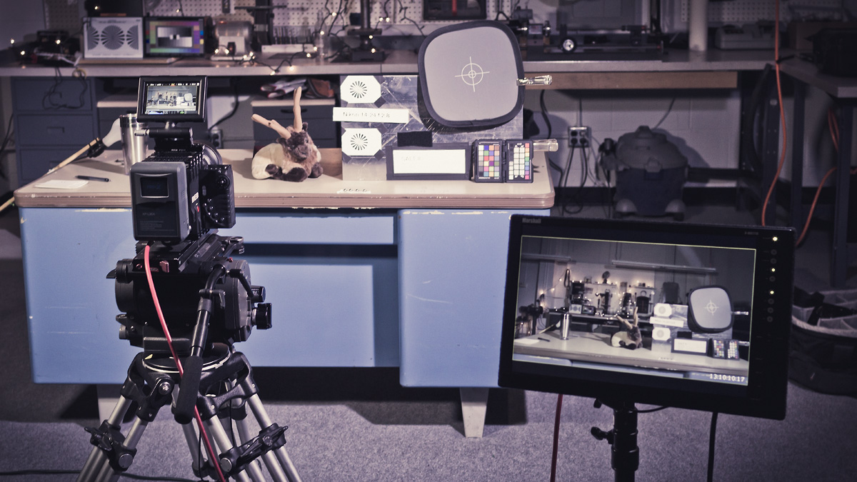

Part 5: Bokeh, breathing and flare...
This test was designed and executed by Matt Uhry with the help of Phil Holland (operating the Gandalf staff of light)
The purpose of this test is to see how each lens breathes in an extreme focus rack, both foreground and background, as well as how it renders elements when they are not in focus (Bokeh). Lastly we wanted to know how the lenses performed when a source flares them from different positions, this is exemplified by the bare lightbulb being drawn across the frame.
The still life setup is lit with a 200W Joker HMI which metered pretty right on to 5000K with the addition of the slightly warm LED panel used for fill. When the flare test is performed a flag was rotated in front of the Joker so that the contrast would be greater, but otherwise the lighting for this setup should be consistent from lens to lens.
The lenses that are faster than 2.8 were shot both wide open and at 2.8, the others just 2.8. This is indicated by the slate in frame.
You can check out all the test clips on youtube in 720P here... http://www.youtube.com/user/evoblue6
The .H264 QTs were rendered out from RCX in 720P, 5Mb/s. with identical settings, they can be downloaded here but please watch them on youtube first and then only check out the QTs if you aren't seeing what you need to from Youtube, I want to spare my server as much as possible.
Here are some examples of the 35mm...
