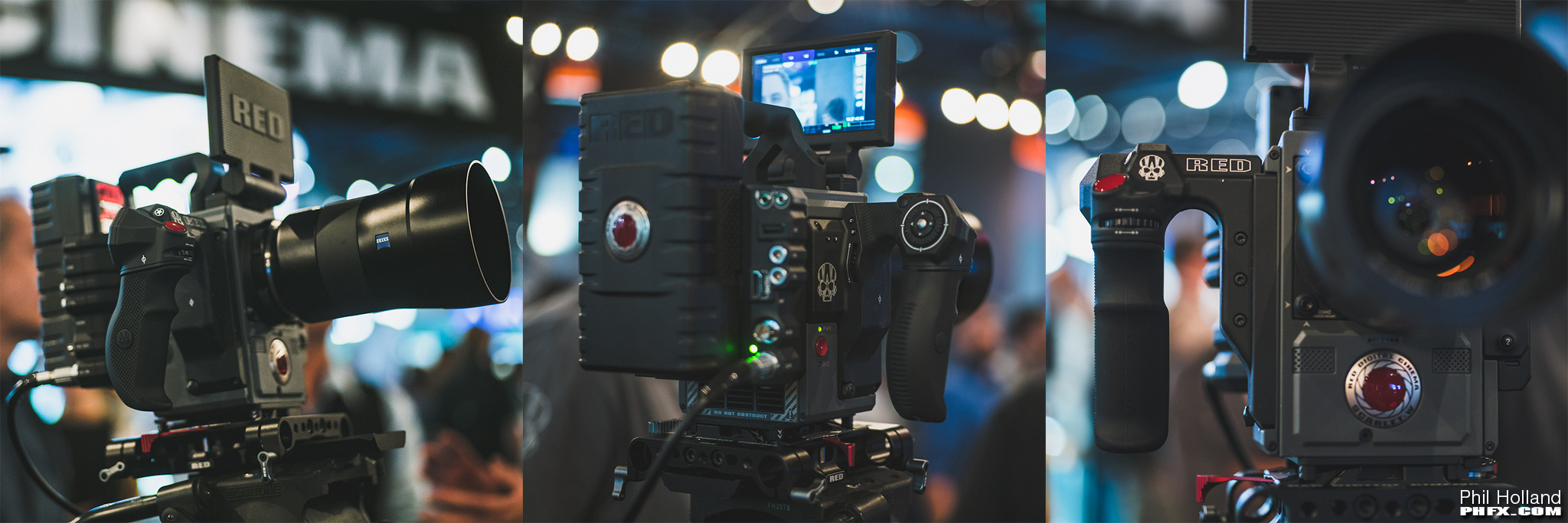

You could always publish a recent photo of the dsmc2 sidehandle to catch up. Phil wouldn't be able to do that
Here you go :)
