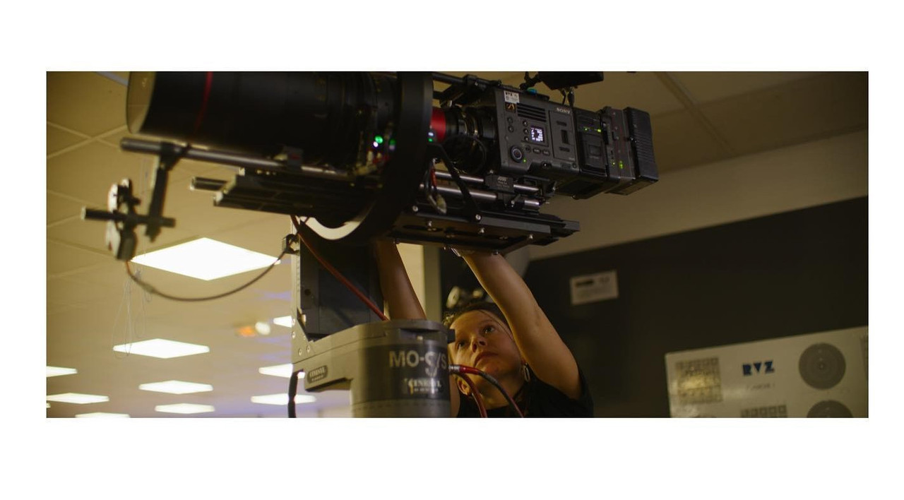

At about the 1:22 minute mark, he shows some stills from the Red V-raptor S35 from some filmmaker in france.
