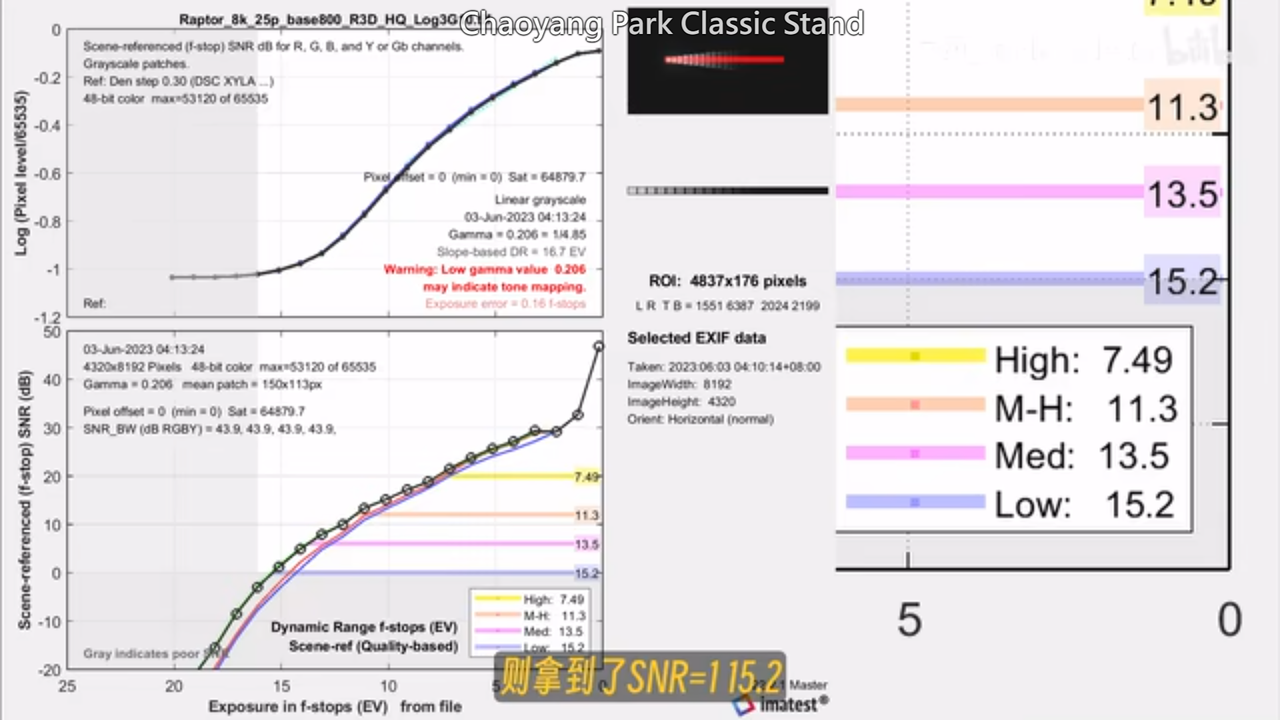

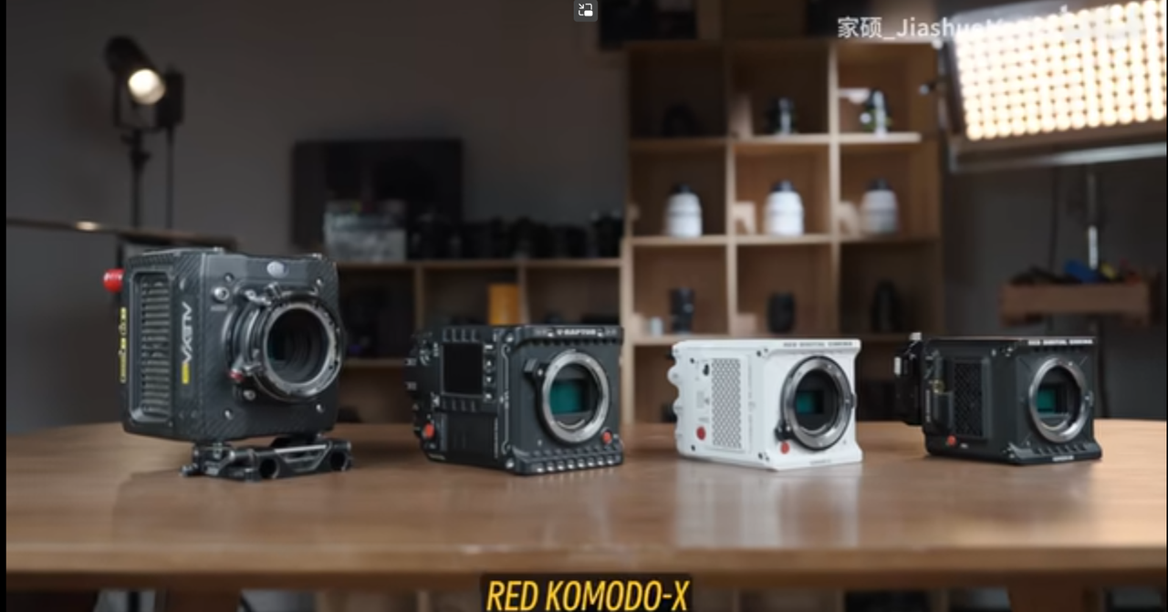

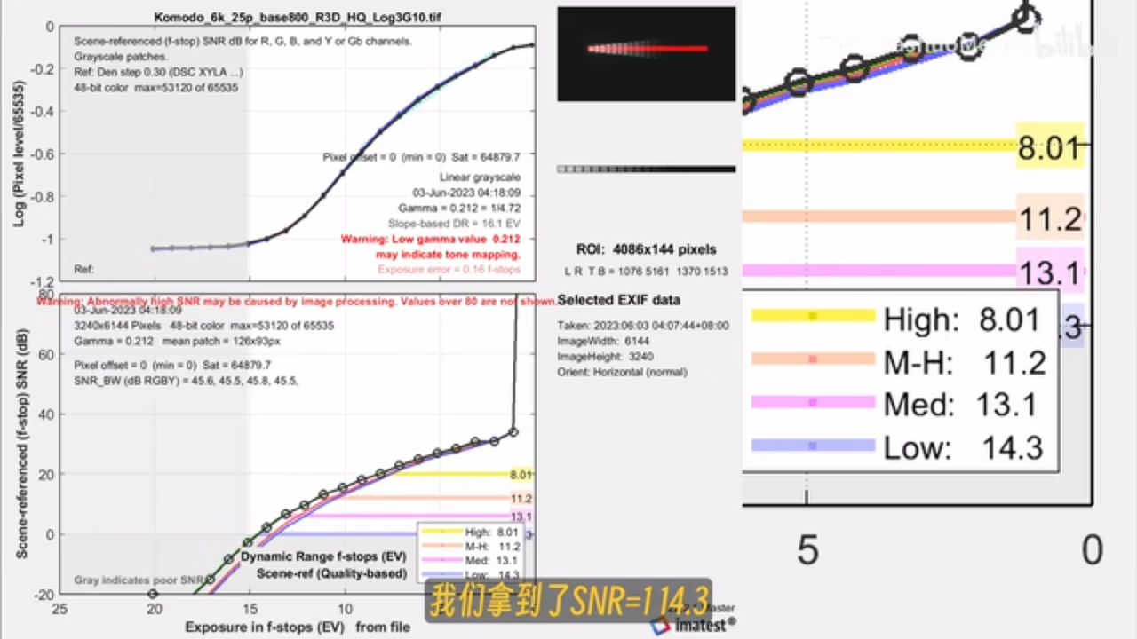

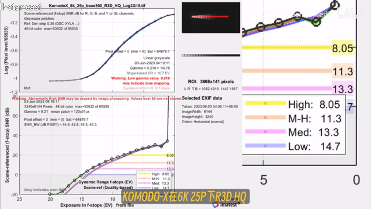

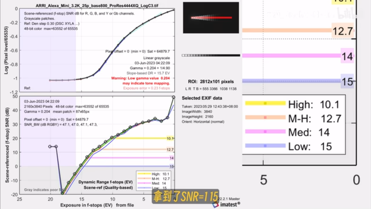

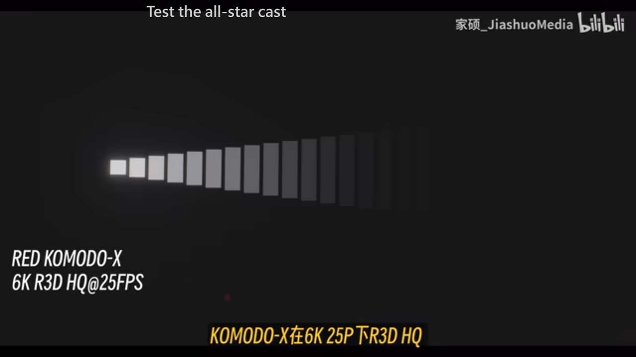

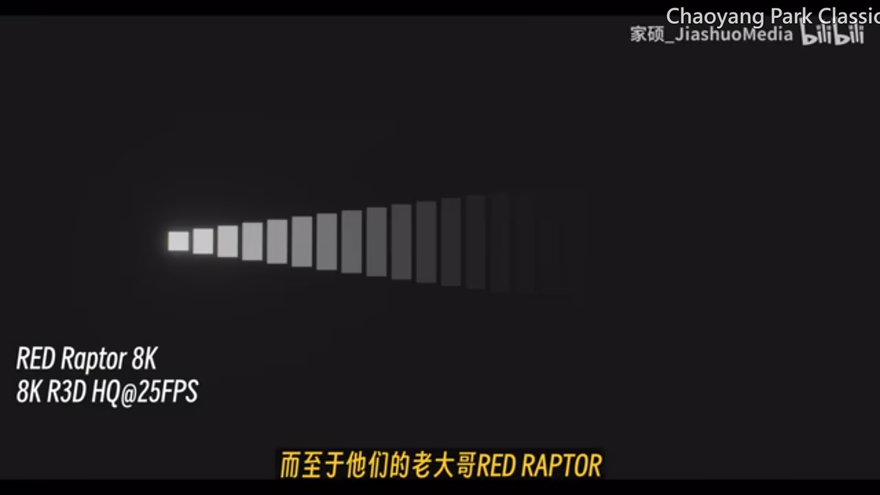

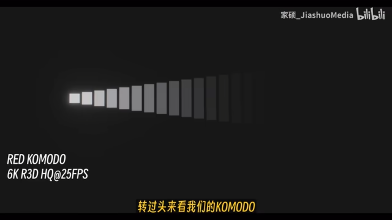

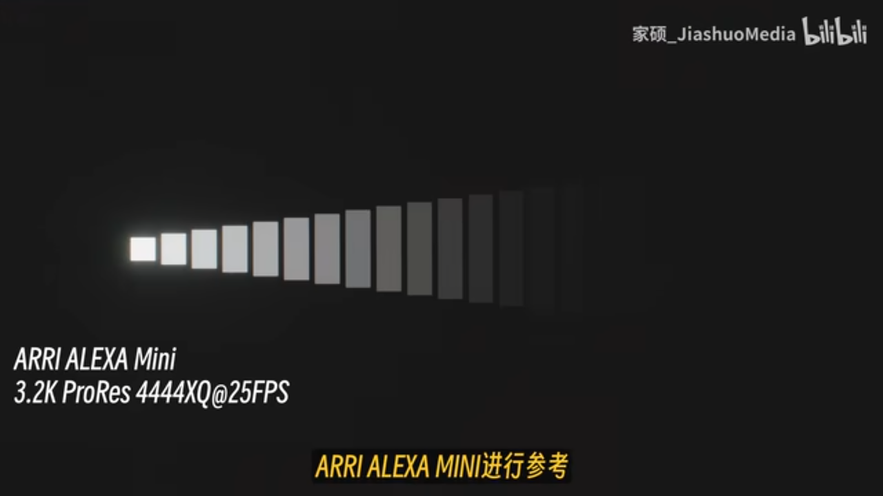

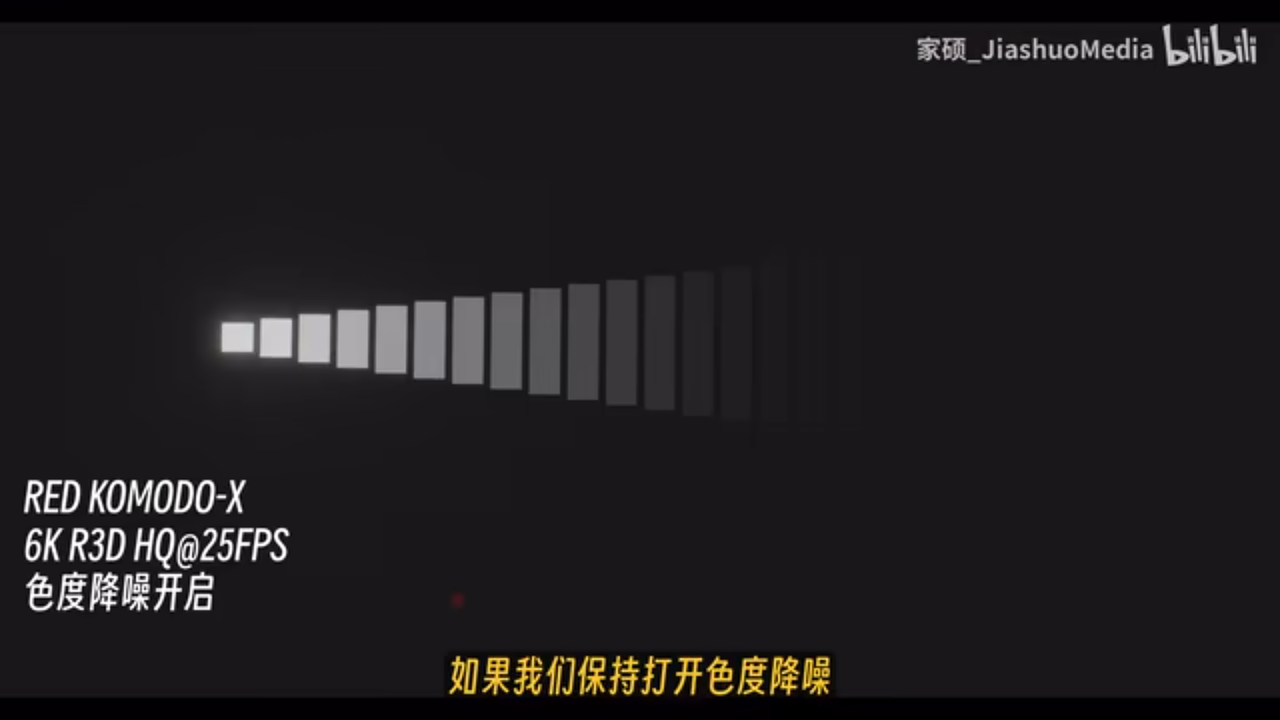

Here'a a link to a Chinese language video comparing the Komodo-X ,OG Komodo, Red V-Raptor and the Alexa Mini in certain parts of the video. It includes some over and under tests. Unfortunately it is in 360P if you are not logged in with an account. I just posted it so that you could gather whatever info you could from it visually.
多花两万值不值?RED KOMODO-X首发评测_哔哩哔哩_bilibili

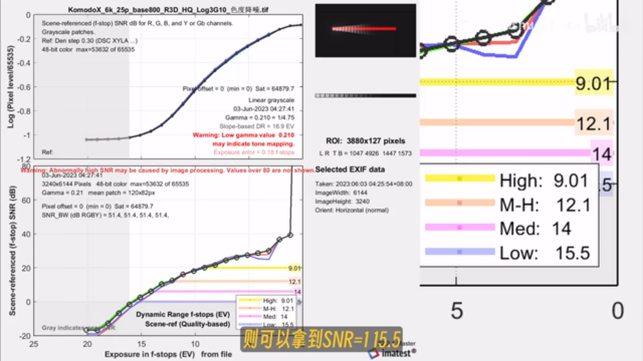

He does XYLA CHARTS Between the four cameras shown below at about the 4:00 minute mark onwards.
Did I understand right that Komodo-X has more DR than Raptor? Komodo-x 15.5 / 14 stops VS 15.2 / 13.5 for Raptor? I just read numbers but no chinese...

It seems under certain circumstances that seems to be what his Xyla Chart testings indicates, if I'm reading that correctly but I'm probably not. However I don't know his testing methods and I think I would much rather wait for someone like Phil's tests to back something like that up or not back that up.
