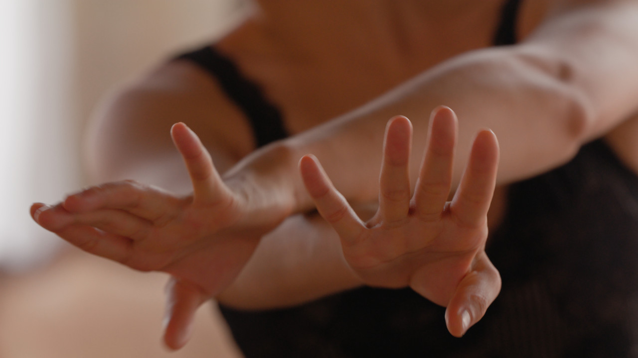

This is a mix of archival fashion and Red Komodo-X /Red Helium footage
By Neil Fernandez
Filmed on:
Red Komodo-X
Red Helium
Tokina Cinema Lenses

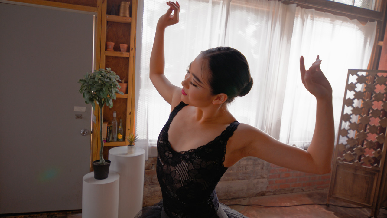

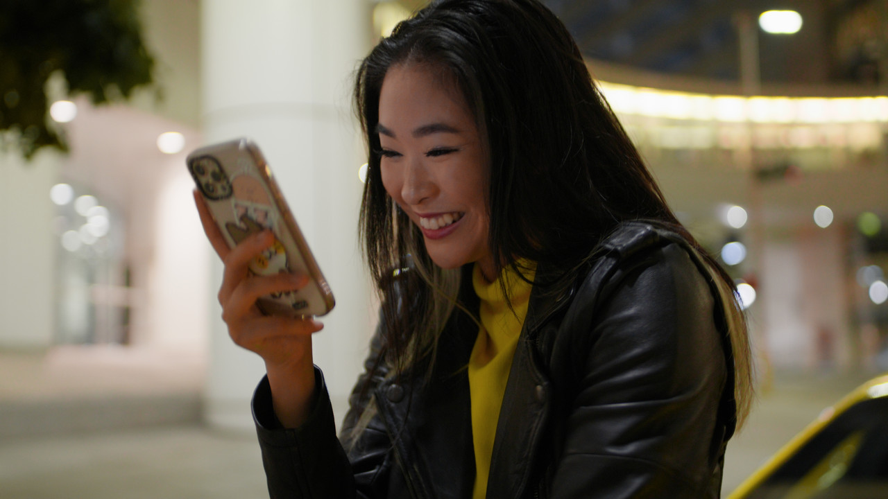

Here's my grades of a few of the new clips James gifted us with. Again, the little black dots are from a demo DCTL I'm using. Graded in ACES.
Wow, so many R3Ds! :cheerful:
"Punchy/neutral"
Hi, Rand! Hi, everybody! :)
Hi Sabovik, good to see you again.
Not seeing the "Punchy/neutral" pictures in your post though, there's an outline where they should be and when I open them up in a new tab it just says, 'Invalid File Specified'.
Ooops! How about now?
I haven't uploaded a picture in a long time, don't blame me, please. :smilielol5:

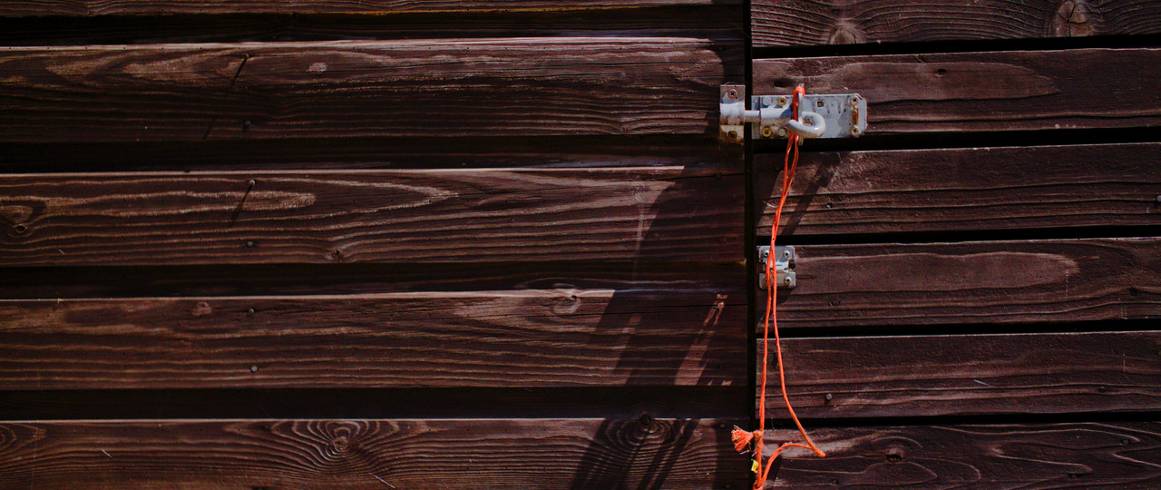

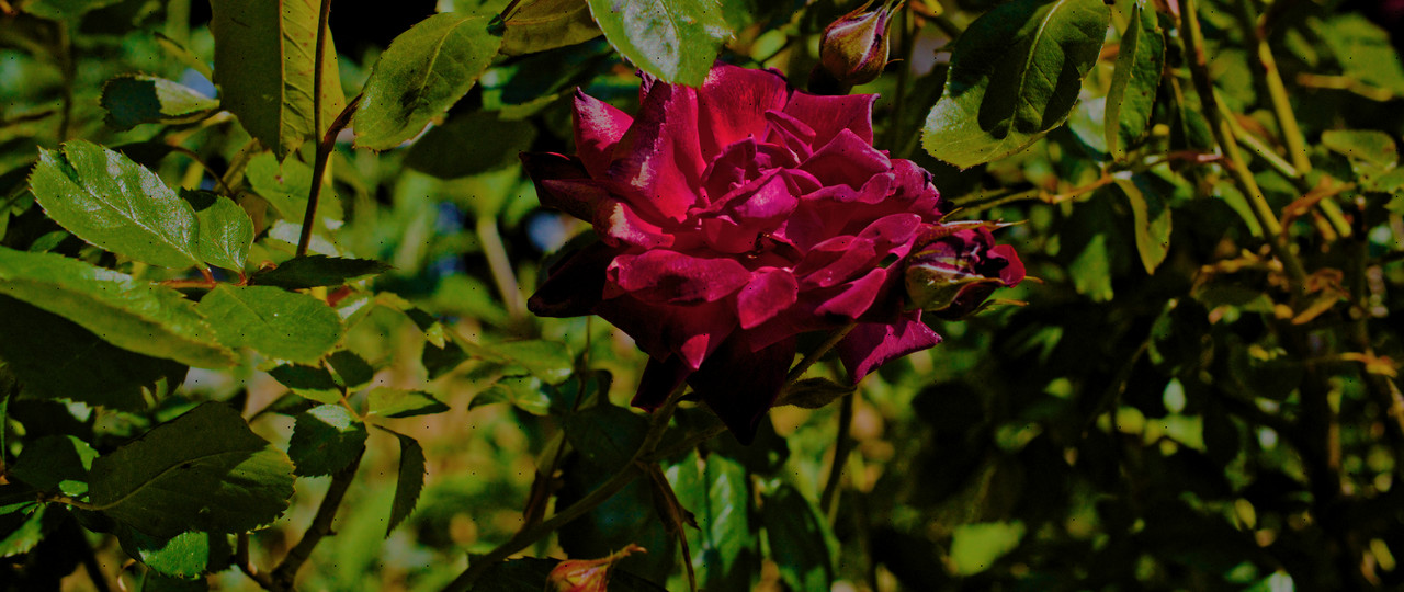

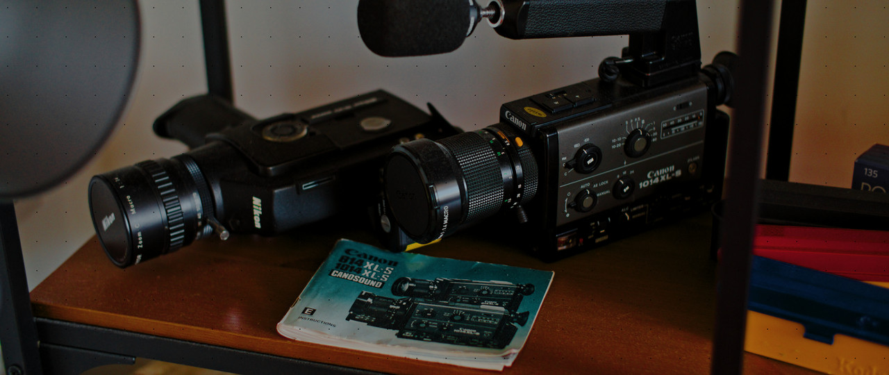

Here are some adjusted versions of the R3D frame grabs James also provided -
It's been good to see how the Komodo-X handles the uncontrolled lighting.
Still curious how the HQ and MQ compression levels might help with the noise and overall image-quality.
Thanks again to James for providing the real world examples of where the camera's exposure limits are.

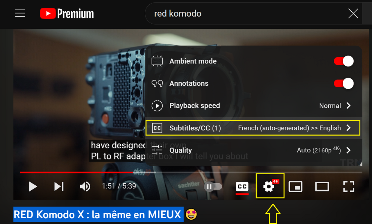

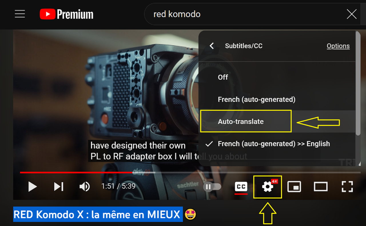

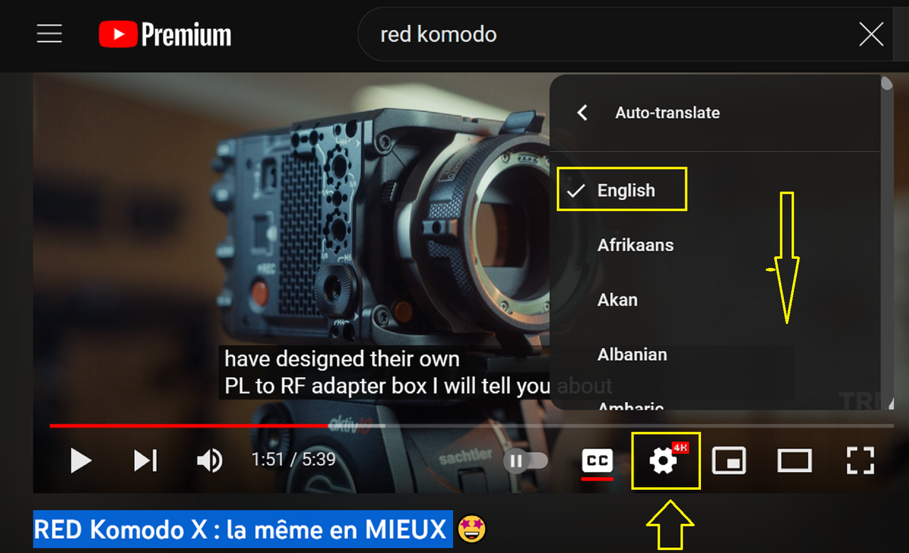

To view the English Translation of this French Video, follow these steps below
Youtube page
RED Komodo X : la même en MIEUX - YouTube
1) First go to the Youtube page link above, for some reason the procedure below doesn't work the same way on Reduser. Click on the "COG WHEEL" icon and click on the arrow pointing to the right next to "SUBTITLES/CC".
2) Next go and click "AUTO TRANSLATE"
3)Finally scroll down the list to the language you want to translate to, in my case it was "ENGLISH"
And you're done!

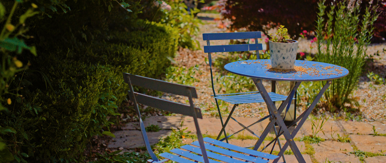

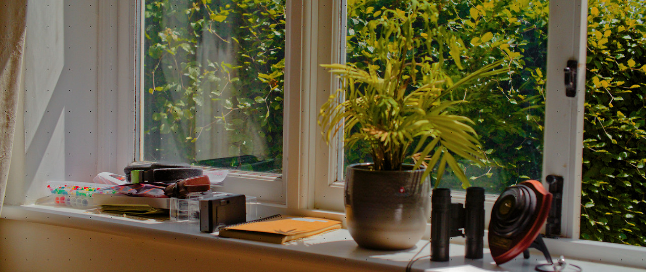

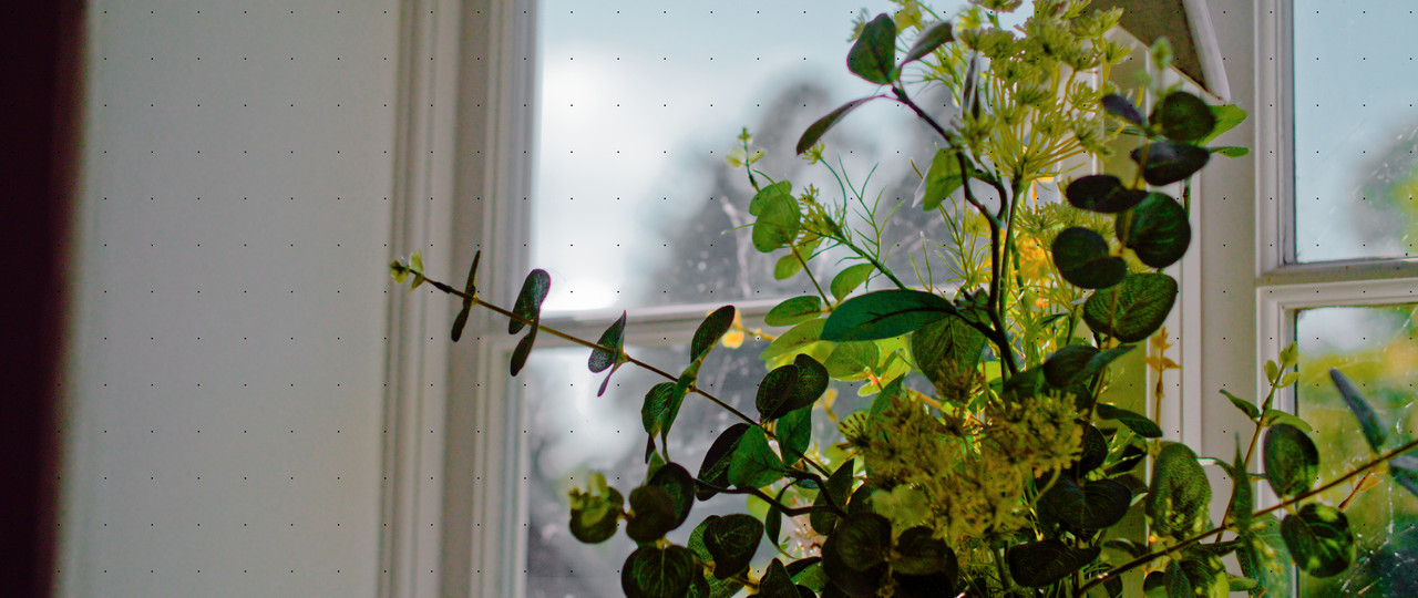

So just for the hell of it, here are some stills from one of James' earlier R3D frame grabs.
They're all from a 6K 2.4:1 (6144x2592) timeline in Resolve, exported as uncompressed TIFF's, then converted to 100% JPG's and uploaded without re-sizing.
The base grade is just something that looks kind of normal, using the ISO800 setting the image was originally exposed for.
I then just upped that same base grade in the Camera RAW settings, to ISO1600 and ISO3200 to show the equivalent of a one and two stop pushing of the image to bring out shadow detail (also made some minor contrast and saturation adjustments).
I've also zoomed in the appropriate amounts to show the theoretical 5K, 4K & 2K 2.4:1 resolutions that aren't actually available in the Komodo-X (according to the Operation Guide), with the lower resolutions being upscaled to fit the 6K timeline.
The aim is to see the noise in the shadows when the camera is exposed for the highlights in a real-world directly-sunlit scene.
It may be that there was more exposure range available in the highlights and that the shadows could have been better exposed, but it doesn't look like it.
There could also be different ways of grading the footage to balnce the highlights and shadows, but that doesn't change what was actually captured.
Likewise, noise-reduction could be applied to make the shadows look better, but I think this frame is a good example of the practical limits of the camera.
The question of how much the ELQ compression level played into the result remains, not having seen enough comparisons between the different levels to say.
It's actually a pretty good result imo.
