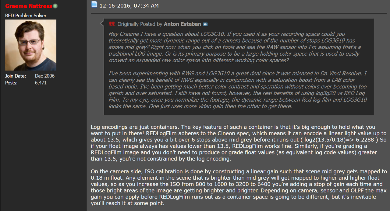

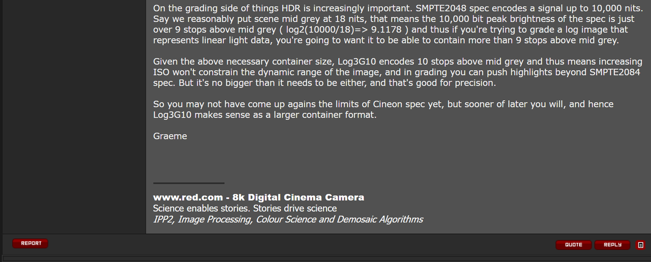

So is LOG3G10 vastly different from REDLOGFilm?
J. Orlandi,
Here's a post From the man himself, Graeme Nattress, responding to a similar question from another Reduser Member.
