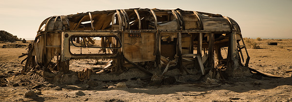

Here's an image shot on an old Isco anamorphic that actually covers the full 35mm plane. It's about a 1.5x anamorphic which produces a 2:1 aspect ratio.
- bigger
And this is actually a 100mm f/2 anamorphic lens that I had Panavision machine together. This sucker is a 2x anamorphic and produces a 3:1 aspect ratio, which is what I was originally after.
- bigger
My goals were rather different on this front though because I wanted full coverage on the sensor.
I'm currently trying to build a wide angle anamorphic, something between 25mm and 35mm if possible, but this is just getting silly expensive on my side.
Here's a couple others from the 100mm.
-bigger
These were all shot on the 1Ds Mark III. I've done a little testing with the video on the 5D Mark II and the anamorphics, but you will certainly be using higher quality optics for your shoot. Locking focus, as always, is just a "pleasure" with these suckers.
Cheers man, and good luck on the shoot!
