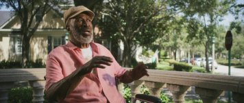

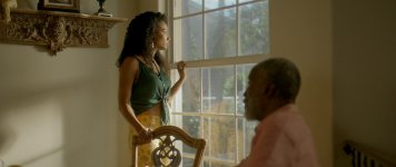

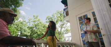

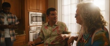

I'm shooting a feature right now with Komodo as my A cam. I must say that there's nothing video-i about it. I've been using MQ compression...
beautiful stills.
What lenses are you using?
