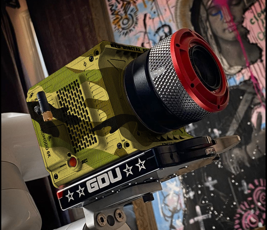

Here's a Camo version
Super cool Rand!
Super cool Rand!
