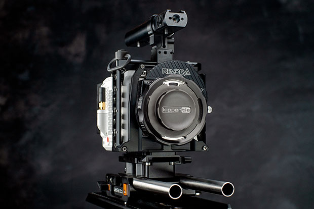

Bright Tangerine Komodo accessories
Hi all,
Tim from Bright Tangerine here.
our cage & accessories will be shipping very soon. Will have a few units out in the wild being tested shortly so they will be able to share their first impressions/experience.
Hi all,
YESSSS, been waiting on this. Prices coming too?
Hi DannyF,
Yes, I'll be dropping full details by the end of the week
