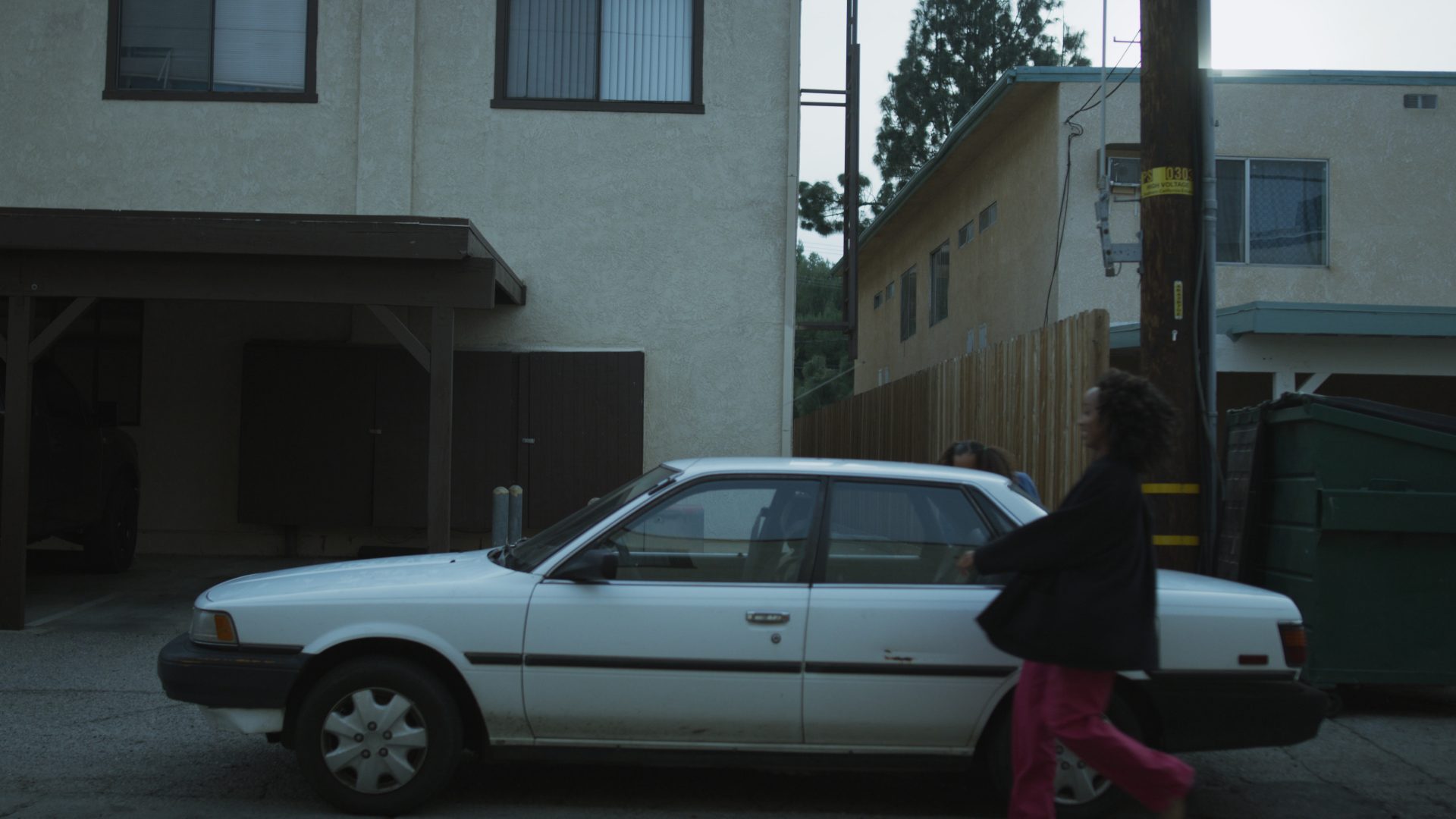

I was coloring a project today using REDCINE-X (to add LUTS), saving them to .RMD and importing into Premiere Pro. I noticed some marginal color shifting between programs (which I realize is normal) but there are a few times where the differentiation between the programs seemed much more out of the norm.
EXAMPLE 1: PhilmColor Print D FLAT (Graded and Saved to .RMD in Red Cine X and loaded into Premiere Pro CC)
RED CINE X
PREMIERE PRO CC
EXAMPLE 2: PhilmColor BASE NIGHTHAWK (Graded and Saved to .RMD in Red Cine X and loaded into Premiere Pro CC)
RED CINE X
PREMIERE PRO CC
In the second example I pushed the kelvin up to the 5800s, since that's probably not in the realm of normal for the Nighthawk LUT, which is blue, I'm assuming that led to the MAJOR color shift. But it seems like something is amiss.
In both examples, The Red Cine-X version looks way better to me. It almost seems like the LUT is set at 50-75%. I looked through all the settings on premiere and compared them to Red Cine X and everything looks exactly the same.

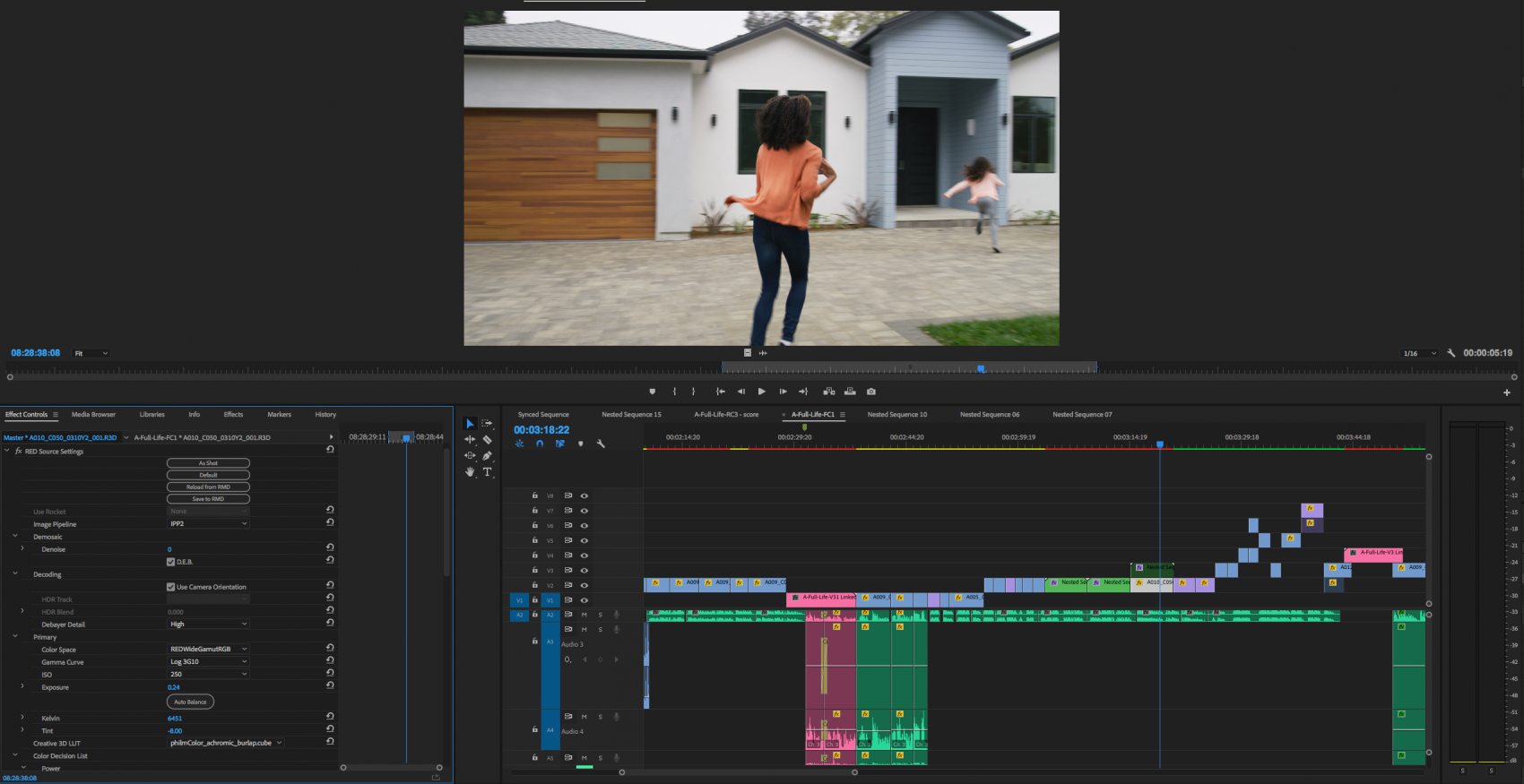

Premiere Pro Output Transform Settings:
Color space Rec.709
Gamma Curve BT.1886
What Am I missing?
