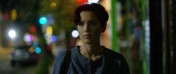

The first thing I noticed with the Epic-W Helium apart from the astonishing low light capabilities, were these nasty hard clipped bokeh's. I did extensive tests with several cameras, and ran tests in post and found that using dragoncolor instead of Dragoncolor2 (suggested by Phil Holland) and REDWideGamutRGB, helped reduce some of these clipping issues, but does not eliminate them. Photos on the left are from Tim Daust's tests (reference: https://vimeo.com/189478583), photos on the right are from my tests (reference: https://vimeo.com/188865905). Both most likely wide open, I believe that's when the problem occurs (shooting wide open at spotty highlights). Because the colorspace seems to have improved these problems, is it safe to assume helium color will likely solve these problems?
