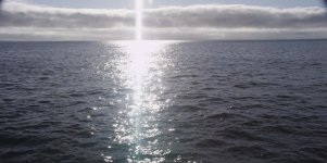

Ok...here's one for ya...ANYONE ever see this ? This is what i think might be a reflection of OPLF--but i don't even know what i'm talking about when i say that....but i heard enough talk about it to be dangerous...Anyway, i see this on images where the light is just right...on this image i'm using Tungsten LED lights....but i also see the same image on some shots where i have HI contrast...dark on lower half of image and then looking up to sun underwater...It's ALWAYS the same image...to me it looks like a big ladder hanging down in the middle and then there is some kind of box to far right.....
R1mx; Shooting 4k 30fps.....and I have NEVER seen this before...only recently (this last shoot).
