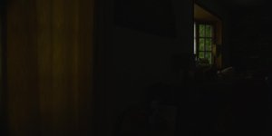

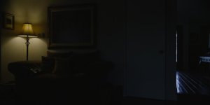

Here's a few more examples where I feel the noise levels are much higher than they should be. In these R3Ds, there is PLENTY of light hitting the sensor and yet I'm seeing heavy noise in certain areas.
R3D FILES
https://elevationvideo.box.com/s/155nfvoqpcs67t15atr5
https://elevationvideo.box.com/s/roq8u7wi7b0drnzok6sb
Here's some 100% screenshots of areas of the frame where the noise is much higher than expected.
R3D FILES
This is EXACTLY what I've been seeing on my two recent DRAGON shoots.
The images are properly exposed in daylight/sunlight. However, the gradient/less bright areas in the picture exhibit a very noticeable red noise pattern other people have pointed out as well. As soon as I began reviewing the footage after the shoot, I was struck by it - the first second the footage was up. I also played with an earlier version of Dragon a few months ago, and the footage didn't have it (even in footage than was less than ideally exposed). That Dragon almost certainly had the old OLPF, as it was one of the first Dragons in the wild.

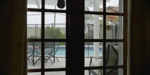

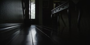

Just for comparison and information. I received Dragon last week and could easily see how ramped up the noise became above 800 in blacks/shadows. However, I don't seem to be having the same noise issues.
Here are some Dragon clips I just shot along with their corresponding jpgs. I would normally shoot these shots at 250-400, but at 800 they're pretty clean.
These were all shot at:
6K 2:1
5:1
800 ISO
Dragon Color / RG3
Temp at 65
Xenar 25 at exposure or just under

I haven't downloaded the clips themselves yet, but as far as the JPGs go, those are pretty crushed.
