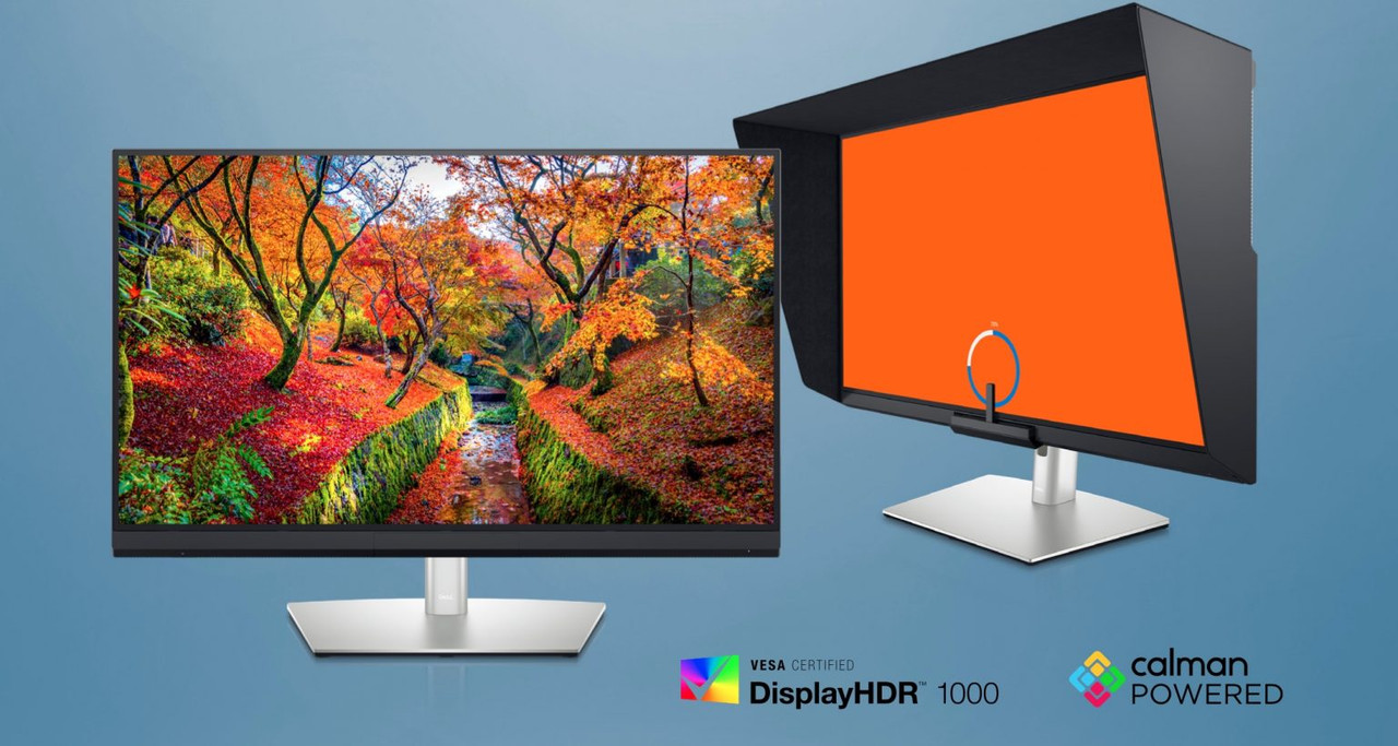

Will be available on November the 5th for $4,999.99 USD.
Article
https://www.newsshooter.com/2020/10/07/dell-ultrasharp-32-hdr-premiercolor-monitor/
That’s kinda dope, right? I hope it can hold its own. 4k, HDR, 10bit, 1000nit, 99.8% accurate DCI-P3, built-in calman... *wish it was* half the price of Apple’s.
That’s kinda dope, right? I hope it can hold its own. 4k, HDR, 10bit, 1000nit, 99.8% accurate DCI-P3, built-in calman... and half the price of Apple’s.
I hope so as well Mike. The built-in Calman Calibration without needing to be plugged into a computer sounds great as well. But we'll have to see how well it actually works.
Did you actually read the article? Matthew writes: "The Apple Pro Display XDR comes in at a similar price, but it does have a lot higher resolution (6016 x 3384) than the Dell. However, it doesn’t come with a stand or self-calibration. The Pro Display XDR is also a lot brighter (1,500 nits) and a lot lighter (16.49 lb / 7.48 kg (without Stand)) than the Dell."
I think the Dell could be popular in the $2,000-2,500 segment. At $5K I'm shopping FSI, Sony, etc.
To Dell's credit, I'm thrilled to see the integrated CalMan feature and hope that self-calibration becomes standard on pro monitors going forward. Will it be as precise as a proper calibration by a trained calibrator - likely not. That said, assuming it does a credible job, it allows me to trust what I'm seeing - no small thing.

Dell UltraSharp 32″ HDR PremierColor Monitor (UP3221Q)
Price $4999
4K UHD(3840 X 2160)
1000 NITS
99.8% DCI-P3
True 10bit
VESA Certified HDR 1000
Zone Dimming 2000
built-in Calman Powered colorimeter
