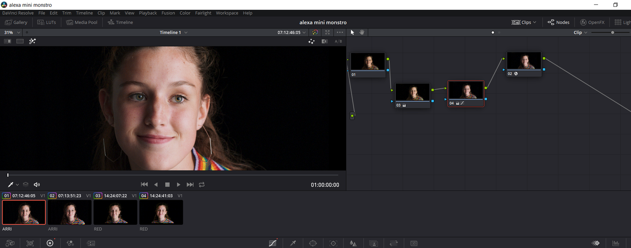

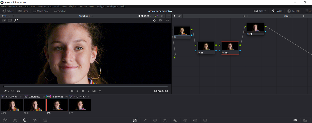

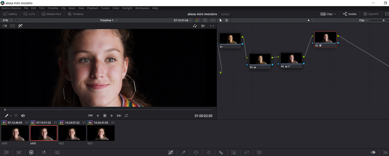

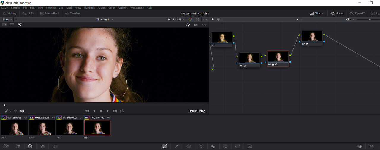

I saw the link with several colleagues and colourist now in the studio. Look this files in 4k Oled .
What happened with the face? there are almost 2 stops of light difference, why this choice?
In the rest of the images no news Monstro is cleaner and better than 1 stop in the shadows, you could push to T22 and it would be the same noise of ALEXA to t16, ALEXA holds better than 1 stop in the highlights, we see that at T2. 8 the limit , and for Monstro at T4, so the DR is exactly the same, except for Monstro you have much more resolution to use.
Perhaps the only thing is that Monstro tries more green in the under exposion.
The rest of the over exposures are unusable in both cases.
However on the field in identical conditions Monstro has a better image of ALexa,this is the reality of the facts., it is enough that you go out and try to shoot something and then go back in post and you will realize when this camera is really beautiful. The graphs speak up to a certain point.

link photo:
https://drive.google.com/open?id=13BleZ6GCOiMPnCCXOAKKYtv6K-IPdksS
[/url]as by luigi valtulini, su Flickr[/IMG]
[/url]Screen Shot 2019-02-06 at 21.22.59 by luigi valtulini, su Flickr[/IMG]
[/url]Screen Shot 2019-02-06 at 21.22.46 by luigi valtulini, su Flickr[/IMG]

@luigi, I need to dig through CML, but does anybody know what ND filters they used in that side by side?
I have alarmingly different results, but I think the variance is the ND itself.
I do not know Phil.
it is one of the test is hallucinating .. I do not know I also think that they use ND filters, but do not know which ones.
thanks Rand, I just wanted to understand.
I do not use Acesst, I'm traditional;) and therefore I miss 2 light stops. I also imported the clip into my Monstro to understand and is underexposed, compared to ALExa.
If Monstro would have been at the same opening in that image you could see very well how much is better than ALEXA.
The nice thing and that even if it is underexposed by 2 stops is still a good image.
