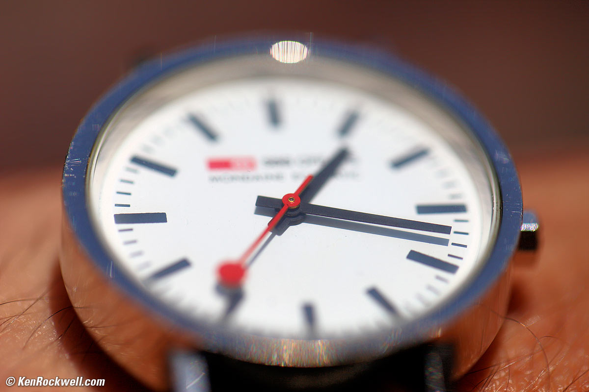

All I afraid now is that I cannot get focused image of jewerly. Close - yes. Focused - afraid not with all 100 and 105mm lenses.
Look at the picture in the first post. It all in focus. With 100mm f2.8 looks like I can get this (this pic from Canon ef 100 f/2.8) at F2.8:

Yes you can. Use more light, get in the f8-11 range, and flatten the subject/jewelry to the lens. Your first photo has the watch falling away from camera, this puts less of the watch in the focal plane. If you rotate the watch (like the 2nd pic more of the subject will lay in the focus plane.
YOu just have to fiddle about, you can get the same result as the 2nd photo....dont give up so easy :)
