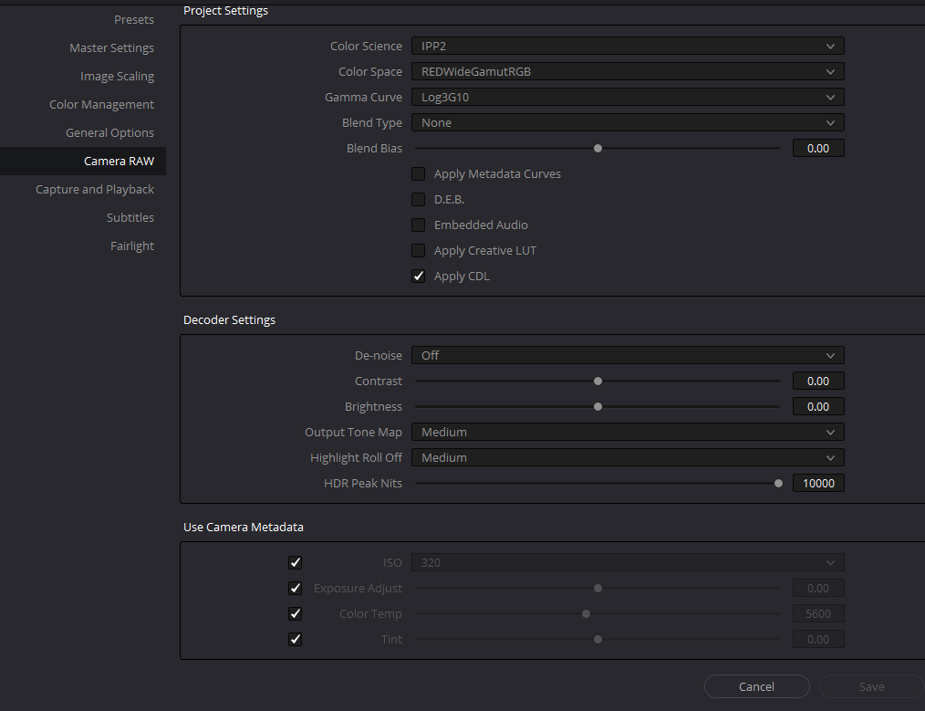

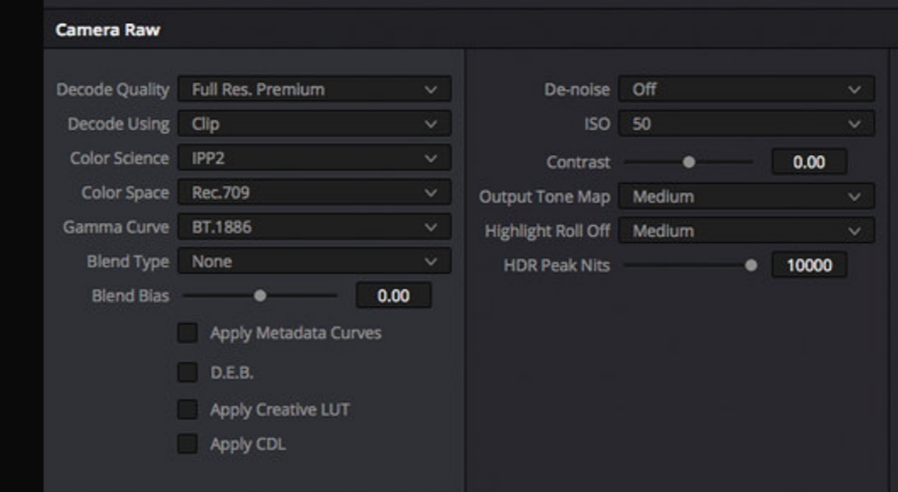

Also, part of your problem is that you are using "Rec709" for Color Space instead of "RWGRGB" and BT1886 for "Gamma Curve" instead of " Log3G10" under the IPP2 " Color Science". You transformed your R3d file in IPP2 into Rec709 and Bt1886 at
the import of the R3d file into your timeline instead in the last node of your grade. So you are doing about the same thing as trying to push an already Pre-graded ProRes file.
If you pushed the temp inside IPP2 with the IPP2 Output Transform Lut in the last node of the grade you would get better highlight retention/recovery from the highlight recovery Algorithm.

The temperature control in the raw tab is still happening prior to the output transform in the raw tab. It will make no difference. In fact, if you do set your raw tab to RWG and Log3g10, you can watch your waveform with NO output transform and still see that you can still truncate the tops of peaks off depending on the color temperature set in the raw tab. It's happening in the SDK's white balancing section, which is why Jake is suggesting to avoid the color temperature slider and instead use Resolve's controls to change color temp.
RWG/Log3g10:

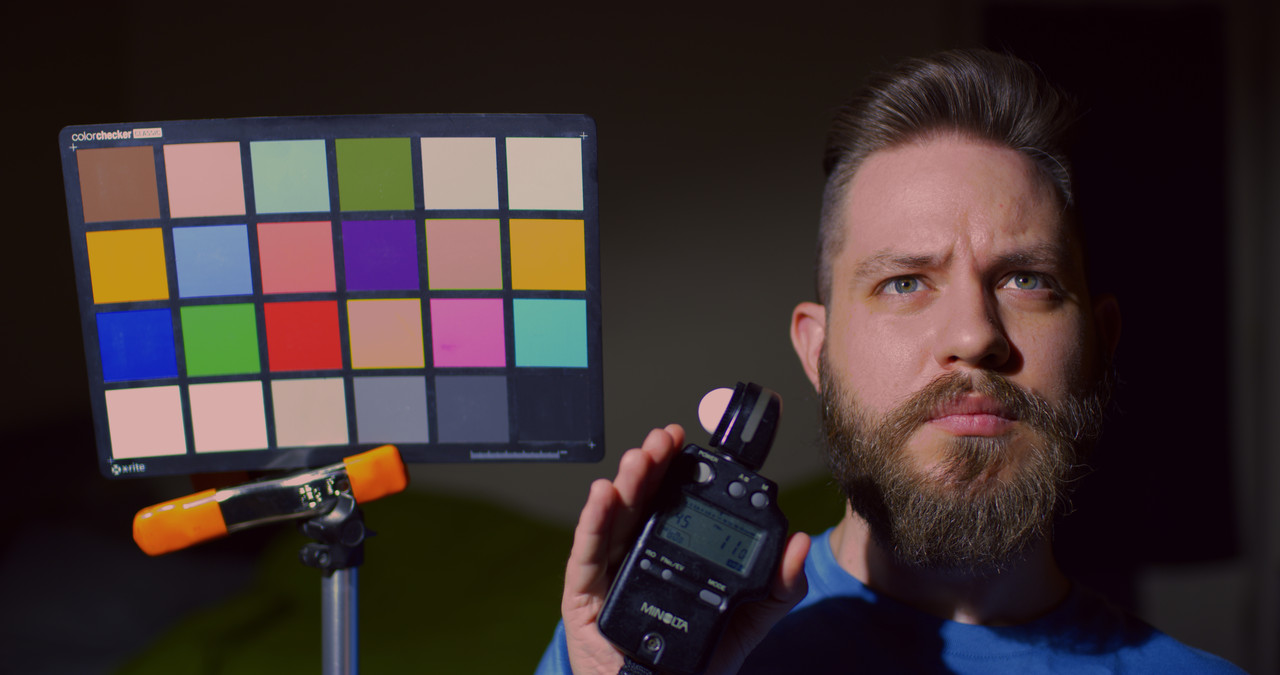

It's a RED phenomenon; Specifically the highlight recovery algorithm. It is more or less effective at various color temperatures. It happens in RCX as well as Resolve. See below.

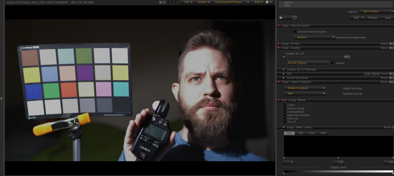

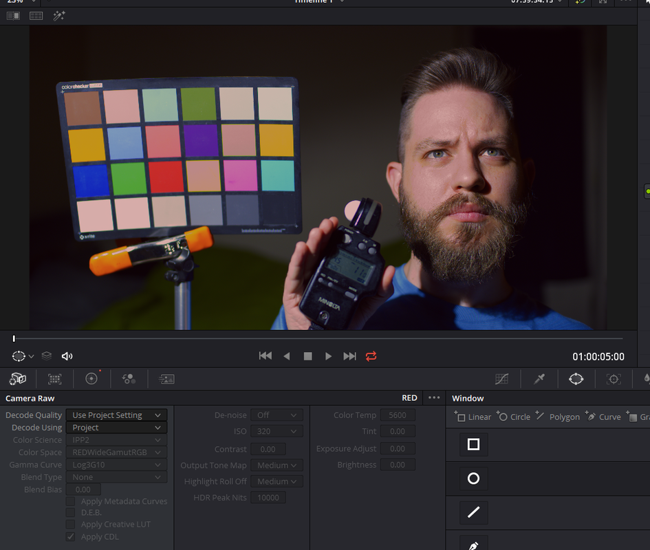

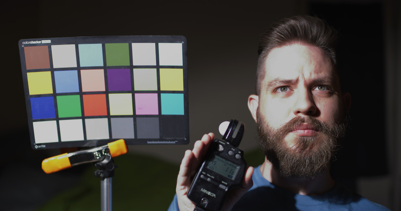

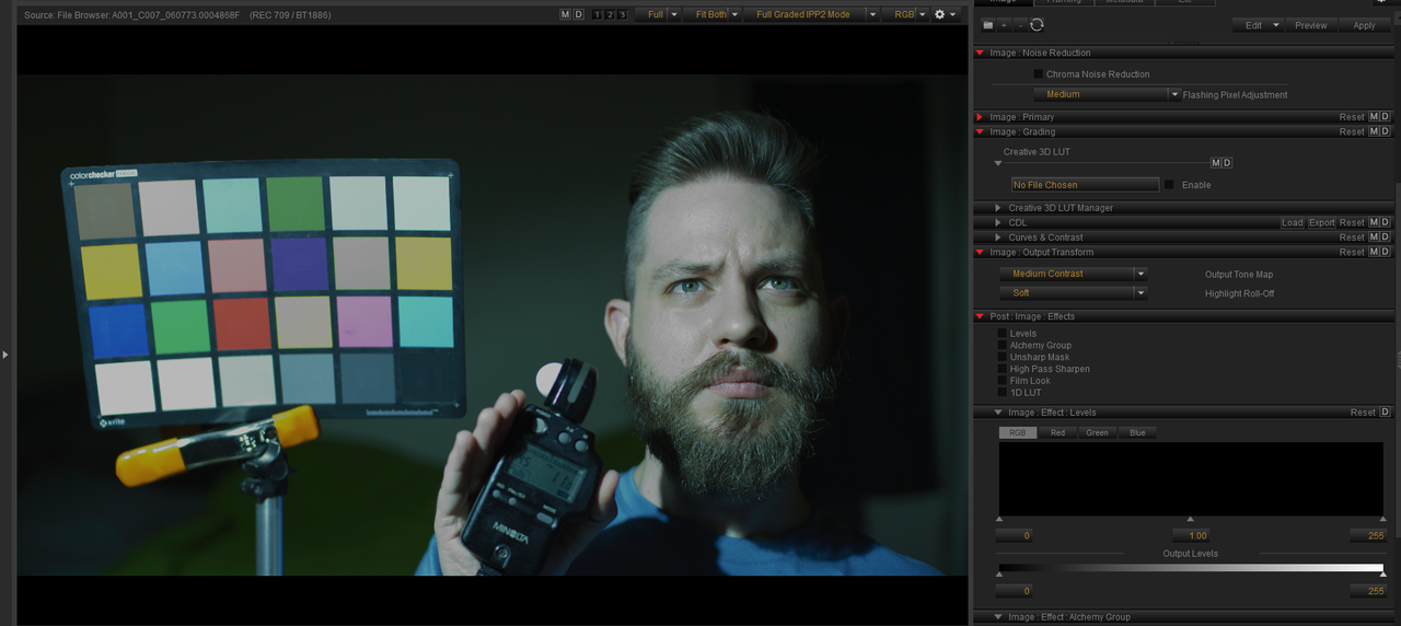

What I'm saying is the inconsistent recovery of clipped peaks at various color temperatures issue is a RED SDK phenomenon that happens prior to any output transforms. It happens in RCX as much as it happens in Resolve. Set your IPP2 monitoring in RCX to view straight RWG/Log3g10 and mess with the temperature slider and you'll see peaks come and go as you slide that slider around. Your worklfow of only changing the color temp in RCX isn't gaining you anything over doing it in Resolve -- You're creating unnecessary extra work for yourself.
Here's Resolve and RCX side by sides at two color temperatures with both RWG/Log3g10 and Rec709/BT1886 (medium contrast/medium roll-off) versions. You can see that they look the same across both software when the settings are the same, output transform or not. Resolve version always on the left of the RCX version:
So telling Luigi his issue is because of when in the workflow he's applying the output transform is irrelevant to the discussion.

The interesting thing is that even if you avoid adjusting the metadata, you might not avoid the issue because it's counter-intuitive. The example I've been using of my mug was shot with a 5600K balanced fixture. The metadata color temperature that yields the best highlight recovery in this scenario is somewhere around 3200K. But of course I shot it at 5600K and would of course deliver it to a colorist with that metadata. But a colorist would have better luck actually changing the color temp counter-intuitively to 3200k and then timing that color back to 5600K in their grading software.
