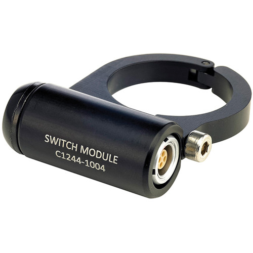

Start-Stop button
Carsten Schuffert
Active member
Jan 13, 2016
25
Stuttgart - Germany
Hello everybody,
I am new in that forum and quite new to RED.
Is there any solution to have a simple external start stop button for the Epic MX ? No Redmote, Foolcontrol etc, just a button ?
I have searched but did not find a proper solution.
Thank you for your help.
Best
Carsten
http://madlyfins.com/index.php?id_product=42&controller=product
or can brew you own if you know how to solder a 3V battery to a diode and switch (info is in the red dsmc manual to trigger start stop on sync port and discussed on several threads here on reduser...)
I adapted my aaton wooden handles on the EPIC... and can help with instructions if you want to do something similar. On dsmc2 with a jetpack the trigger can now be a simple close / open circuit but on dsmc 1 it requires a 3V signal.
Thanks both, this was fast ! I probably start with the soldering solution first as indeed its the cheapest. Thanks again !
Carsten
@ Mikael: BTW: Have you heard any news about the DroKnob V3 ? If yes please PM, as this is probably the wrong thread.
Hi Carsten
Yeah, its pretty simple to do. Take a look at Ops guide, there is a circuit there. You can skip the LED if you like, but do not skip the capacitor otherwise you may see false stops or multiple starts.
http://www.cinegears.com/portfolio/cinegears-remote-trigger-for-red/
CINEGEARS Single Axis REC Trigger for RED Epic is designed for RED Epic cinema cameras.
Effortlessly trigger your REC button with this specially designed cable. It leaves your hands and mind free to focus on other aspects of the shot. The Trigger can be powered by D-tab cable or USB cable and used as a stand alone REC trigger. Also, you can use it with any of your CINEGEARS Wireless Motor for wireless remote REC Start/Stop control.
It is also featured with aluminum build, LED light and REC button.
http://www.cinegears.com/portfolio/cinegears-remote-trigger-for-red/
CINEGEARS Single Axis REC Trigger for RED Epic is designed for RED Epic cinema cameras.
Effortlessly trigger your REC button with this specially designed cable. It leaves your hands and mind free to focus on other aspects of the shot. The Trigger can be powered by D-tab cable or USB cable and used as a stand alone REC trigger. Also, you can use it with any of your CINEGEARS Wireless Motor for wireless remote REC Start/Stop control.
It is also featured with aluminum build, LED light and REC button.
Will this also work with Weapon?
i woud love a nice wired remote on off too, but not a cine gears one.
hopefully wooden camera makes one.
im trying to stay all wooden camera and red.
