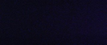

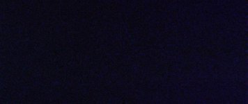

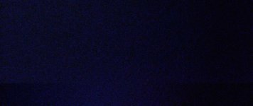

just to give you an idea .... 3 bodies red epic .. project time base 25, frame rate 120fps shutter 1/240 5kws. To test this I went to 12800iso and 'the result ....
BUt only exceeding 75 fps, 25p or 50p frame rate in base 25 all good ...
same environment, same procedure, same temperature, etc. ....
3 black different, and every time I make a black to these settings and 'always different ... yet the temperature and exposure remain the same ..
I thought it was a problem with the lcd, however I find him also on file ..
If I set the cameras to 23.98 at 121 all right without this ...
Or if I leave the black in default, everything ok without line but with the stain all right ..
I am going crazy ...:001_unsure:
All work by the black shading? or no one is aware of this?
TheBied help.....
