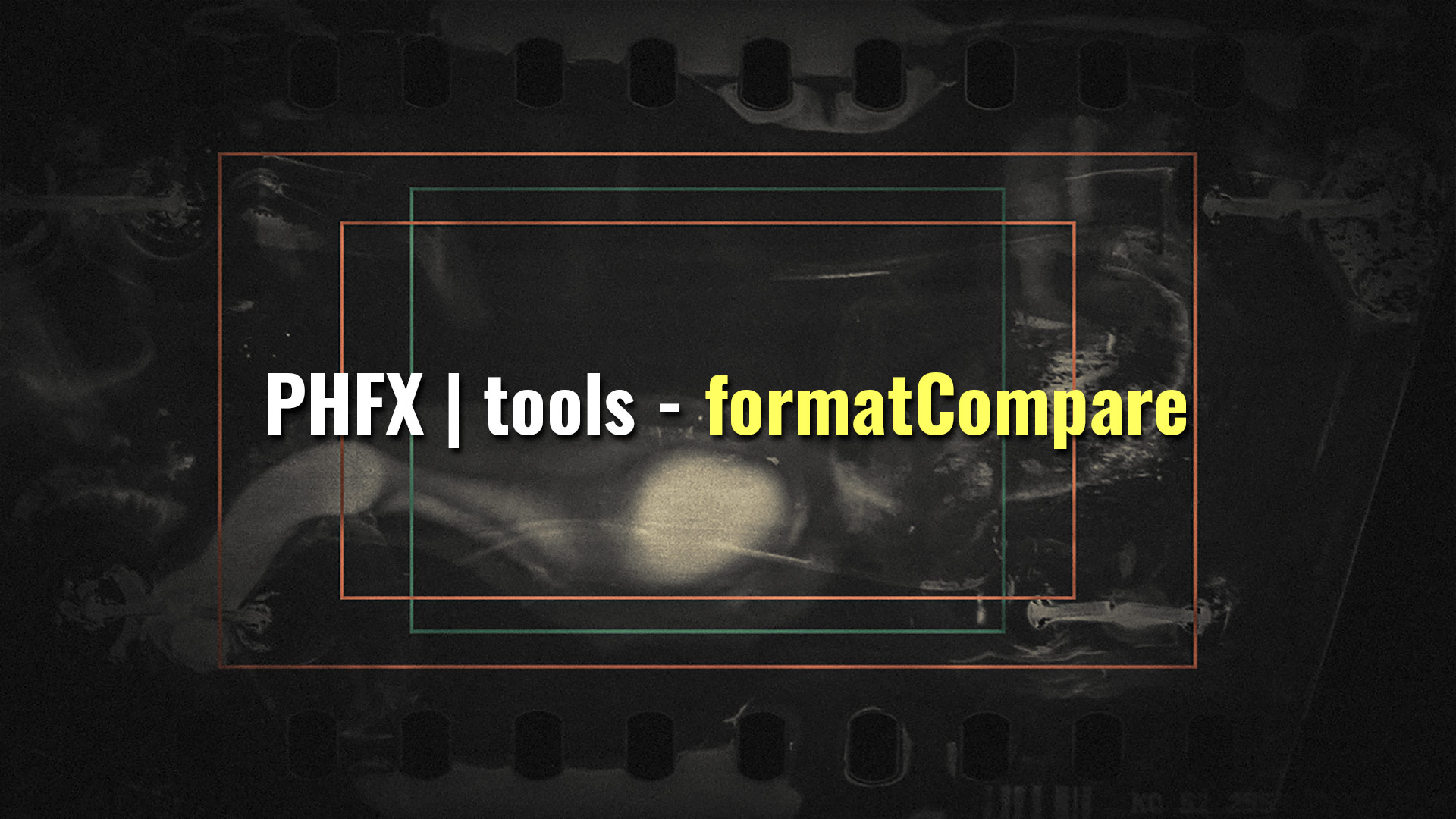

V-Raptor XE should be the same level of performance of the [X] without the high frame rates and advanced features. Here's a format comparison for the field of view:
But the critical thing, is this camera is 8K capable as well as 4K deliverable anamorphic capable. Those are the pros.
If you purely need 6K to deliver say a 4K final, Komodo-X is a great value. But 8K and a larger format is real good here too. And Raptor XE also can give you 5K and 6K S35 if you think of it that way.
