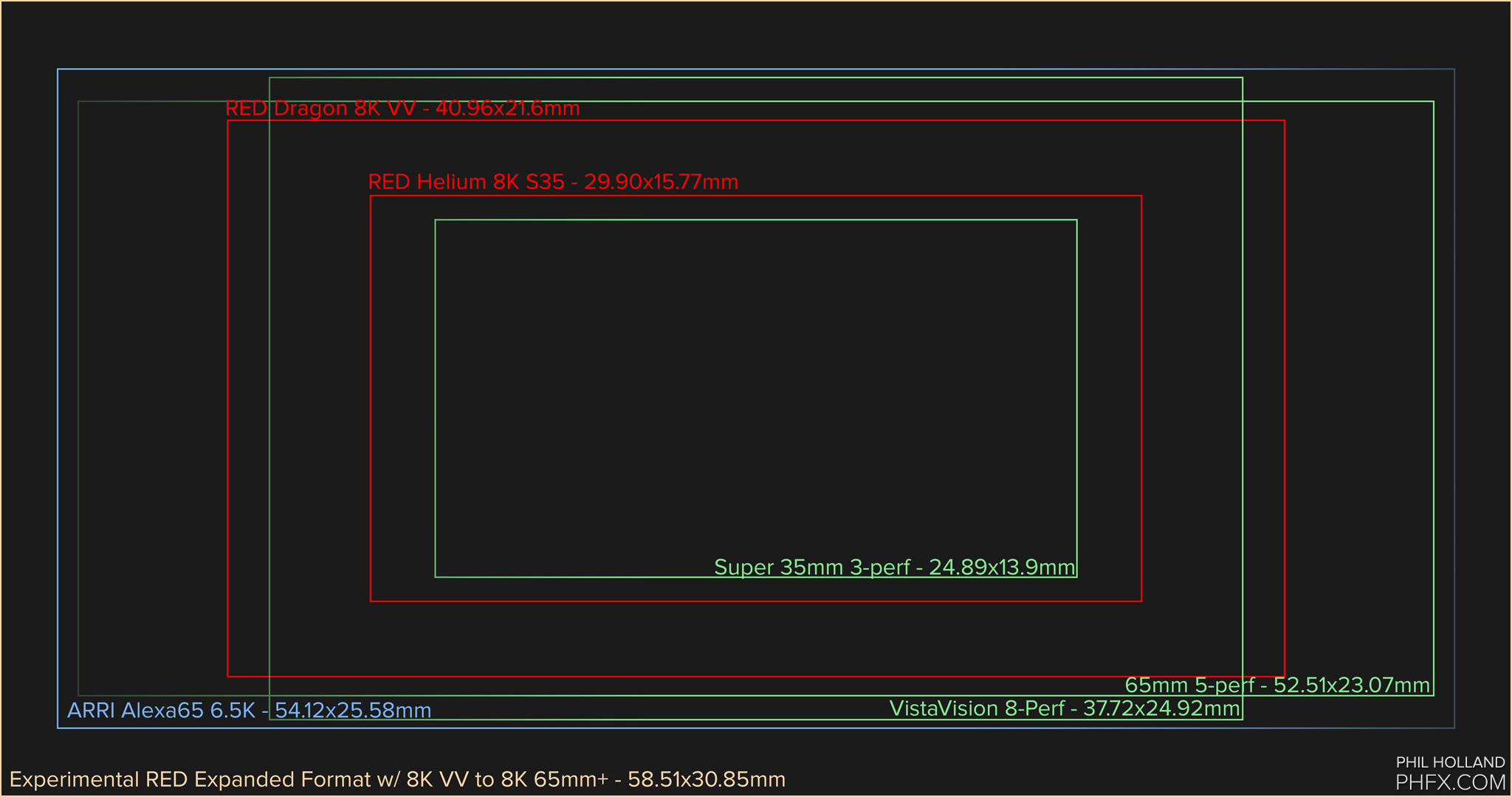

Consider this. A 35mm prime on Super 35mm film compared to this "Monstro 645 Experimental" format would have the effective HFOV of a 15mm prime lens.

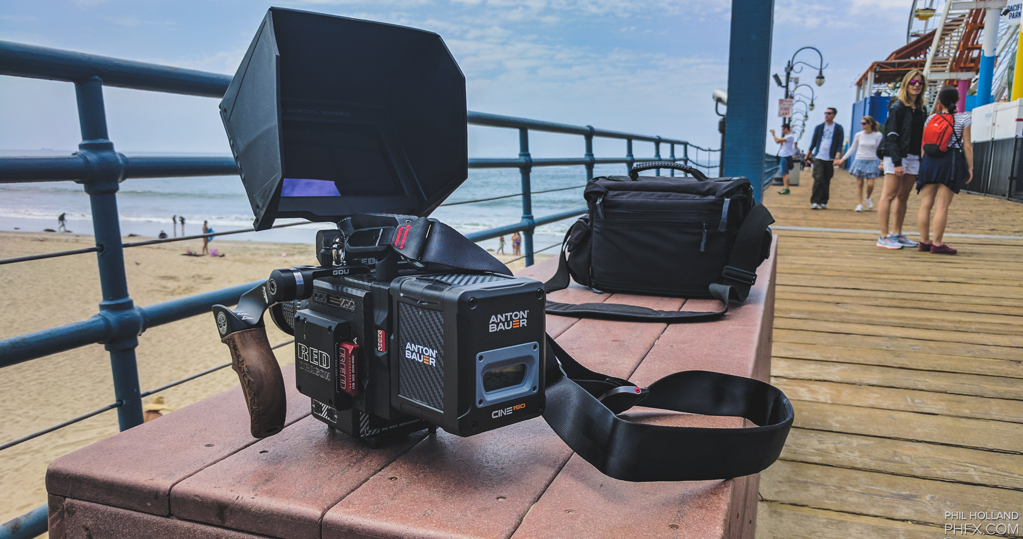

It's been fascinating having a very large format digital cinema camera that I can sling around my neck. This is my Bellycam 3.0 setup, which I would love to use more really. I shoot mostly on support of somesort, but I do like the candid qualities of this rig and it certainly has that waist level finder appeal from medium format still cameras.

This would be considered an speed booster and you do indeed gain about 1 stop of light. Adding optics into the chain will do a few things. In this case with our current prototype base element it enhances barrel distortion and of course adding any optics into the image chain will slightly degrade the image. Interestingly fighting back against that by stopping the lens down 1 stop helps loads.
This concept holds potential for both of RED's 8K offerings it would play nice with FF35 and VistaVision lenses to Helium S35+ would benefit as well for those interested in exploring all of this. For those who are fortunate enough to have a Dragon 8K VV and have medium format glass that they want to see "more of", this is indeed a wonderful option.
