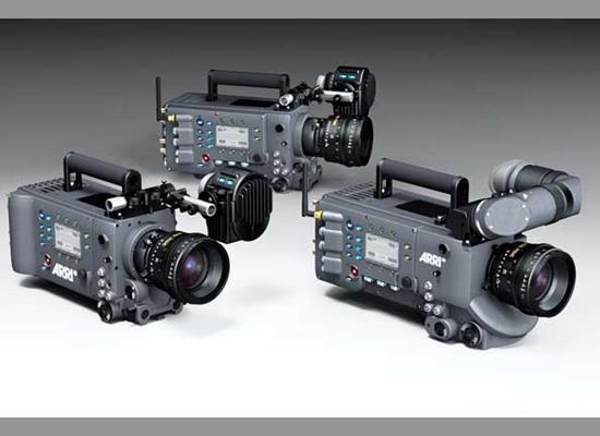

They maybe 3.5K sensors but with Arri they will be true 3.5K, they also understand the need for true dynamic range and they will be true to Rec 709 throw in 75 years of knowledge of the movie businessmakes them a formidable high end opponent.
Pawel Achtel is right they dont need to be cheaper, they do need to be better.
I'd go speak to a guy at Arri about sampling theory if I were you. They know how sensors work, resolution, MTF and optical low pass filters.
Any sensor, any type has rows of pixels. Say it has 3.5k pixels across. It cannot have a >0% MTF at 3.5k rez unless it is allowing for significant aliasing errors. MTF should be 0% at full rated rez, giving a measurable resolution somewhat less than full rated rez to avoid gross aliasing artifacts and artificial looking edges.

Not sure what is meant by "true 3.5K." It's Bayer type sensor like the Red.
True "x"k where x is some sensor horizontal pixel count doesn't make sense. Due to how sampling works you either have:
0% MTF at x -> implies you don't meet the rated resolution of the sensor, and hence it's not "true"
>0% MTF at x -> implies you have aliasing, which means some image details are corrupted, hence it's not "true"
But people are lead to believe you can have >0% MTF at full resolution with no drawbacks. This is just so not the case. I've spoken to Arri engineers and they fully understand this also.
What Arri does is a valid approach - 3k sensor (properly optically low pass filtered) designed primarily for 2k output - you demosaic the 3k and downsample to 2k. Or you record the full 3k as raw and demosaic in post.
That's similar to what RED does - 4k (and more) sensors (properly optically low pass filtered) designed for full resolution raw recording. In post you can leave as full rez or decode and downsample.

ill bet the camera is gigantic, just like the d20, d21..
and on the price.... lets just say its a rental
When the ceo of arri was talking about this new camera at the start of the year, I think he was saying that it will be smaller than the d21/d20. I suspect it will be around the size of a 416. We will see very soon how the ergonomics pan out....Arri cameras are traditionally pretty good on that front.....not as good as aaton's, but certainly better than the red one. Hopefully the ergonomics of epic/scarlet will be better.
Looks like its in the Red One ballpark, Size and ergo wise.
http://www.broadcastnow.co.uk/technology/arri-to-unveil-new-digital-camera-system/5005484.article
They are slated to cost $73,000 - $190,000 USD if the online currency calculator can be trusted.
Any on-board recording or is that extra?
