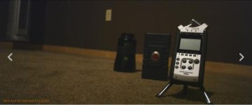

I was meaning to post these example pictures that the seller posted about the defect. As he mentioned, it looks like if you keep the lens wide open or close too, the defect does not show.

Well it could just be a sensor clean which red says is 120/hr. I am still waiting for my power cables to show up to test out the camera. I dont think the sensor itself is damaged, its just some cleaning fluid dried on the glass in front of it
Don't buy it!!!! Could easily be OLPF scratches - and then we are talking (guessing) $500 to fix, plus shipping to Red and back.
If the OLPF has been treated this badly, likely other parts of the camera are also in terrible shape.
I would wait for someone well known from here to sell theirs. They often come up in the sales sub-forum.
I've already bought the camera. i am waiting to get power to the unit until i make my decision to keep the camera or not. The guy said he would offer a refund if things were not to my liking so i am protected in a way. I know for a fact that the damage is NOT on the OLPF, the OLPF is perfectly fine, its on the glass thats protecting the sensor. The Sensor itself is fine, that glass just needs to be cleaned. After speaking at length with the owner i bought it from, it really seems to be a problem that looks worse then it actually is, but i can't be the judge of that until my AC cord arrives, so until then I have to play the waiting game.
