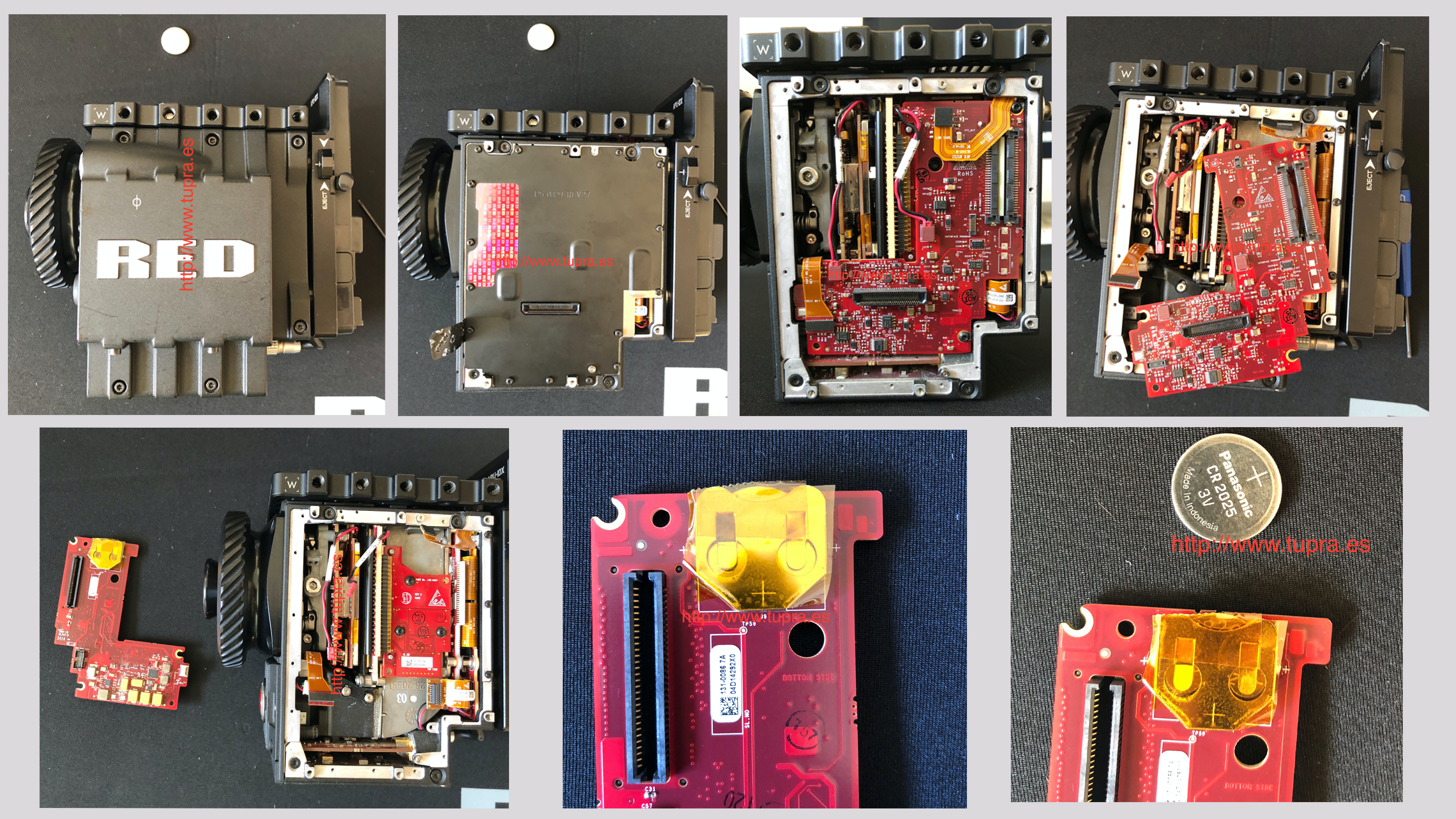

Hey Eric.. somebody already posted a detailed walkthrough with pics on the forum awhile ago. I used it to replace our scarlet battery. The instructions were in Spanish, but I just followed the pics.
if memory serves correctly, first you remove the ssd reader... then you remove the plate it’s attached to. Then you remove the circuit board that is exposed, and that should give you access to the battery or at least get you close.

After a lot of searching, it became apparent that this is the only info on how to open a DSMC1 body and replace the internal battery. Well i videoed my BATTERY REPLACEMENT effort and hopefully this will help you DIY too.
https://youtu.be/KpjSaE8XHEw
Enjoy and give it a thumbs up if it’s helpful at all 🤙🏽

Vuelvo a publicar los pasos aquí, pero ahora con la imagen alojada en mi servidor para evitar caducidad.
