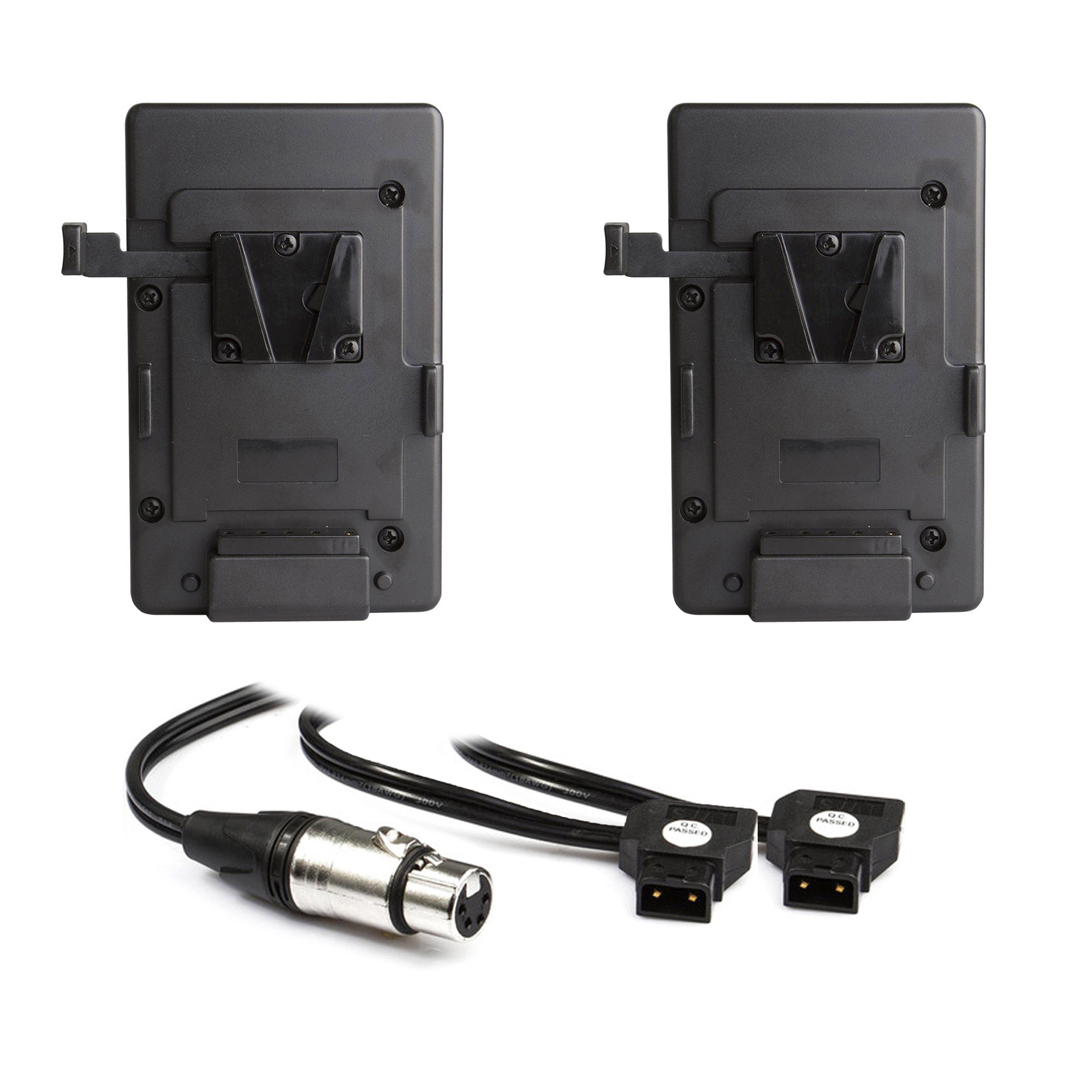

And is there yet a dual V mount solution to power this in field with 14.4v bricks?
Shawn,
Yes the 400FC at 3M (10Ft) is with the reflector that ships with the kit in this group buy:
https://hivelighting.com/products/hornet-200-c-par-spot-omni-color-led-light/
Yes we made a Y-Cable and dual battery plate solution for both Vmount and Gold (AB) mount batteries
it mounts so that a battery goes on each side of the light kinda like a beer helmet...
