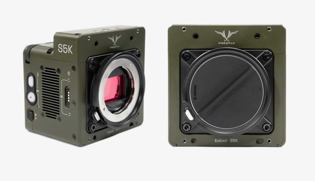

It's global shutter? Wtf! 800grams! (Only 11+ though... so basically MX DR).
$18k is a lot though... But like, not phantom price... and also 800grams and 20~40Wh is very nice.
Here's More info at the freefly website
Ember Specs - Freefly Systems

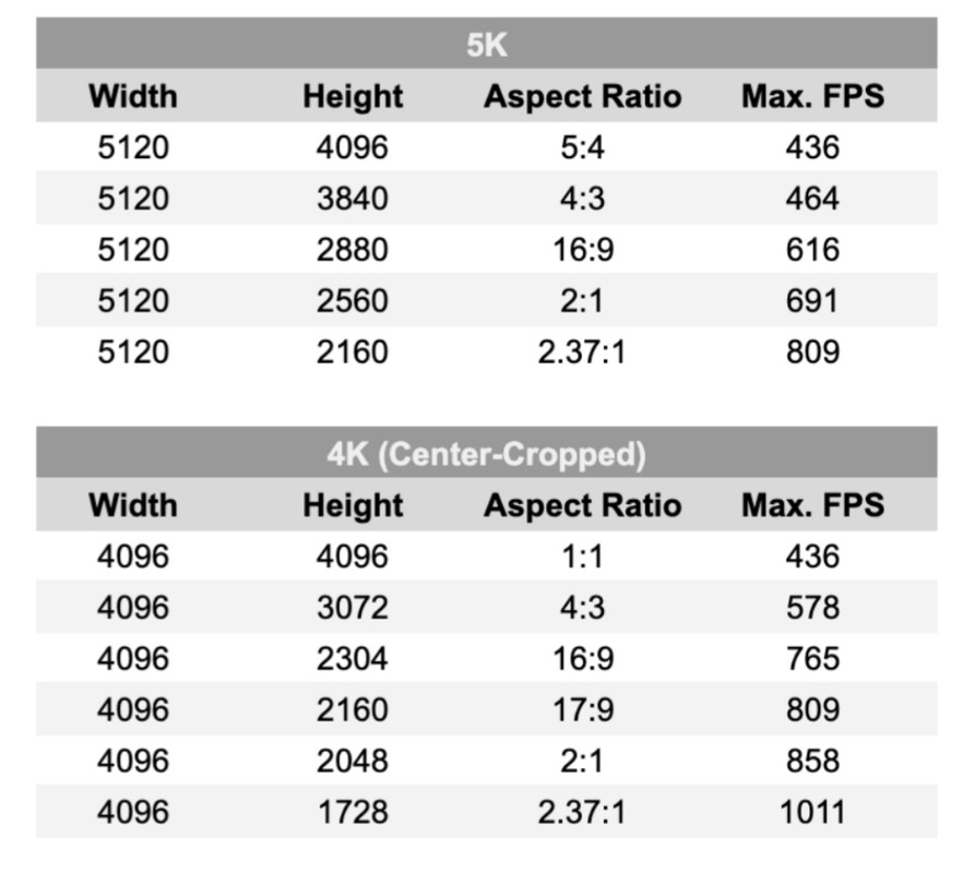

yeah it says ''GLOBAL ELECTRONIC'' on their website and 11 stops is not that bad for the kind of framerates it is offering at high resolutions.

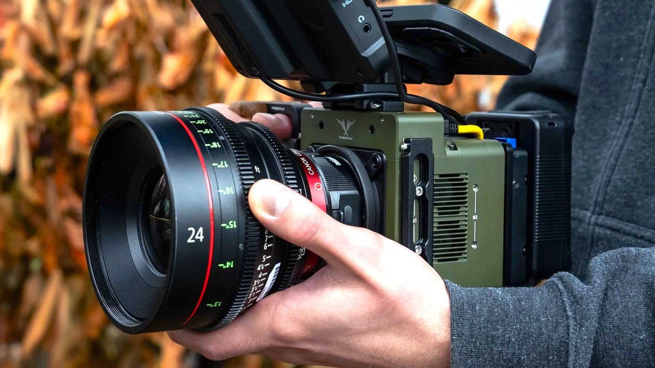

It uses E-Mount!? Very interesting! Clearly we now have a specialty high speed action camera for the Sony crowd in particular, also Nikon Z9 and Kinefinity by adapters.
Important to note it's a "dumb" E-mount, with no ability to operate focus or aperture, so you can't actually use Sony lenses on it (unless we mean PL-mount CineAltas via adapter). It's basically a mount meant exclusively to accept adapters, though I guess there probably are some fully manual 3rd party e-mount lenses...

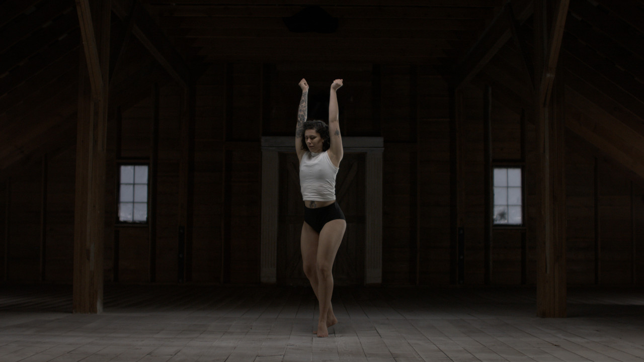

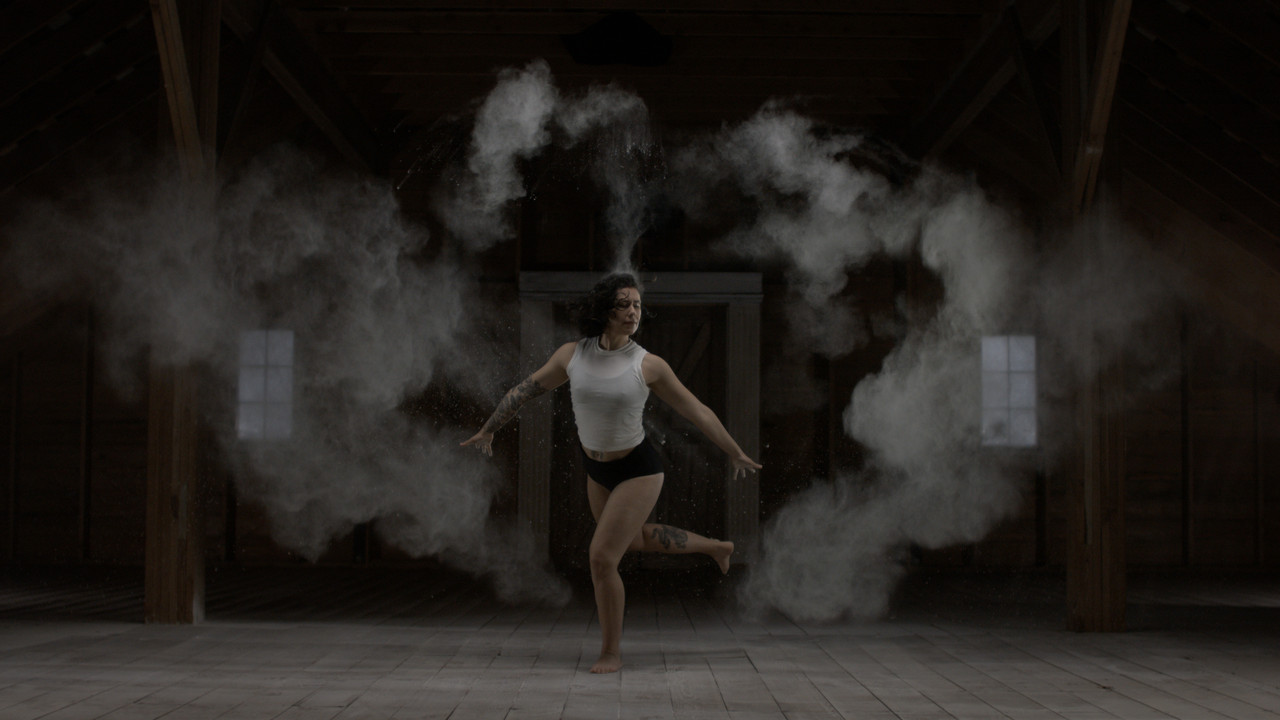

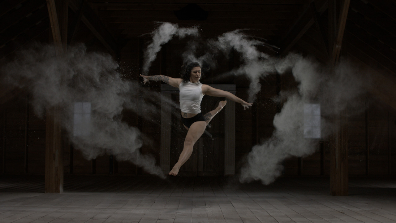

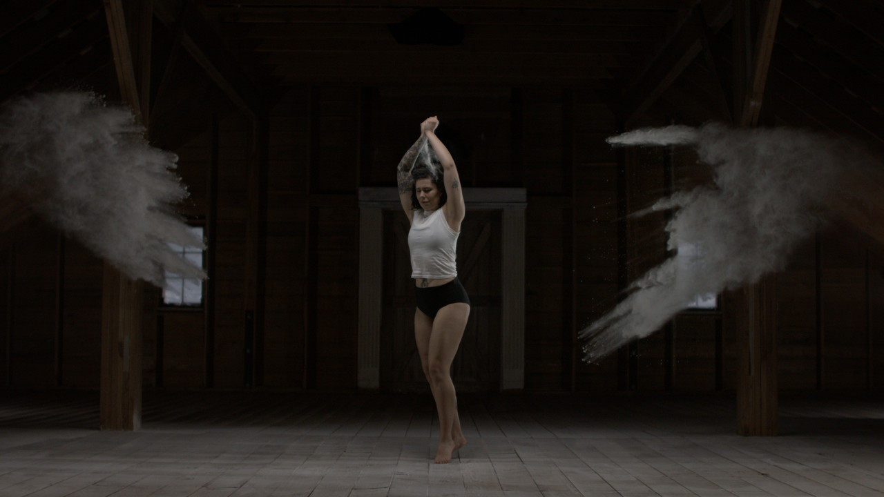

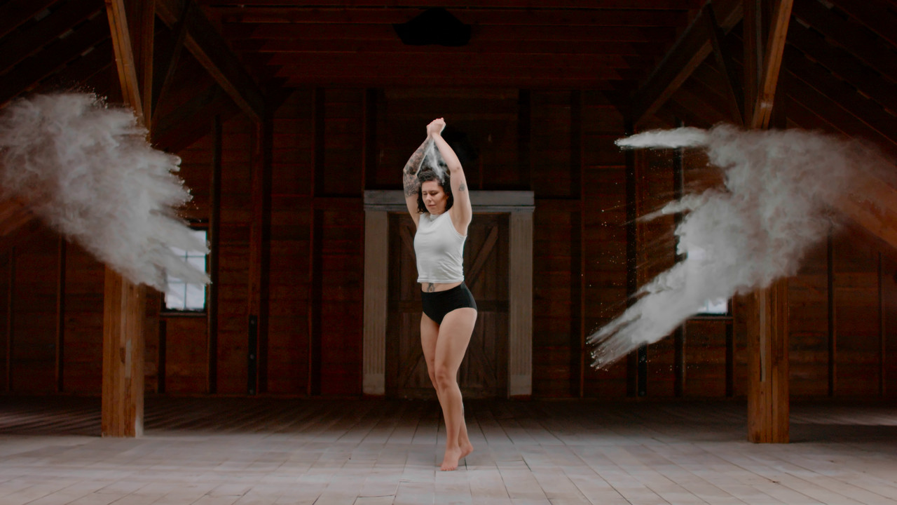

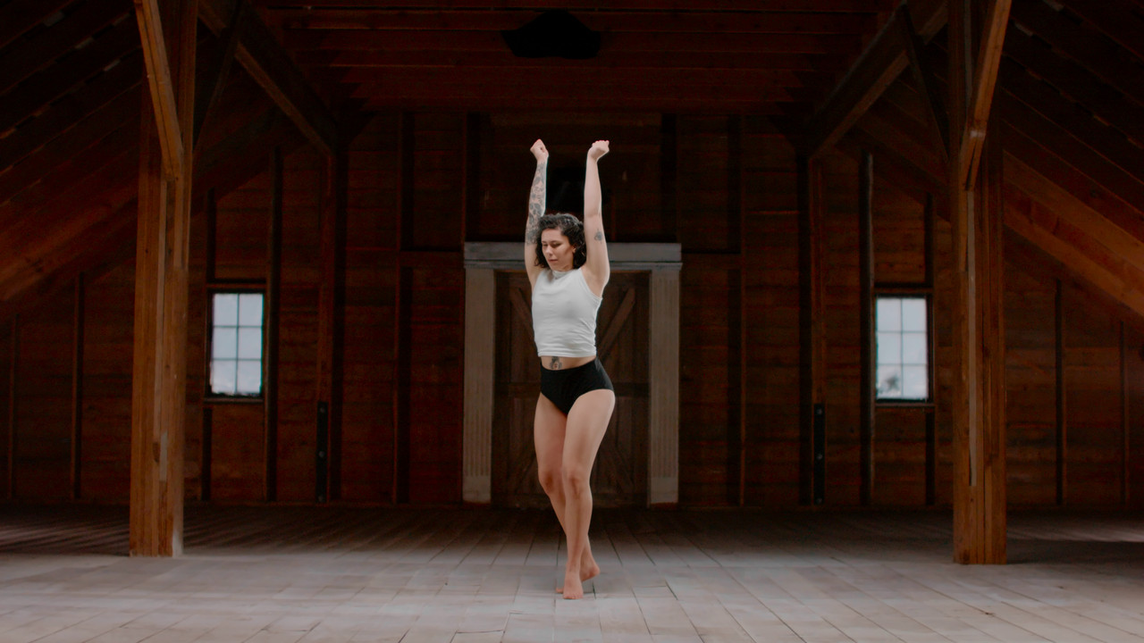

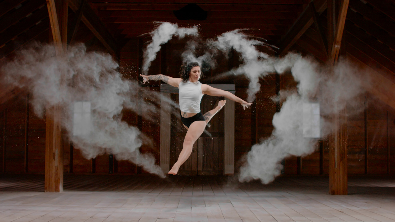

I brought one of the ''Original'' clips from the FREEFLY website into Davinci Resolve into an ACES Project workflow to just try messing around with the footage and something weird happen. It raised the shadows significantly which are really noisy but left the rest of the image mostly as is. I added some contrast according to the Mid Gray point for ACES.
Update: Images corrected because I was using an ACES Candidate 2.0 REC709 ODT that made both the Skin-tone and Wood in these look a little too Red
Originally how it looks on their website
How it looked brought in an ACES Project with some Noise reduction

After fooling around with it myself, Yeah you and whatever noise reduction tool you use will become very close friends. The native ISO of 300 is not very good for any scenes that doesn't have a shit load of lighting. Also this camera doesn't currently even shoot in LOG and is limited to a REC709 Color Space so forget about any HDR deliveries. If it wasn't for ACES, trying to get a half-way decent exposure and color image for the clip, it would require increasing the exposure which would decrease saturation which would then necessitate an increase back of saturation to like 75 to 90 Sat.
Also on the Freefly forum users complain about the lack of an true "BLACK LEVEL" and there is no "BLACK SHADING" available which results in "FIXED PATTERN NOISE" which even one of the members of the Freefly team in the Freefly presenta Ember S5K video above says is there.
I don't know what "COLOR SCIENCE" they are using with this camera and will it be truly supported by any major NLE. I personally can't see any reason to get this camera over say a RED V-RAPTOR S-35 which is a much more "Developed" and more feature rich camera than this one for only about $2000 more unless you are going to make "SLOMO...The MOVIE" or really need to see every flap of a humming birds wing.
