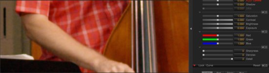

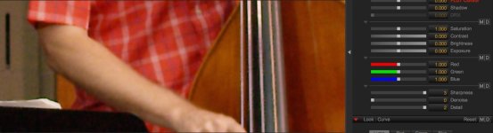

A strange thing I can see with the denoise and the sharpening tool (wich wasn't so apparent in my memory) is how the introduce artefacts.
Here a 250% snapshot of the strange effect.
1) With the denoise the blue stips from the shirt are gone.
2) Usually there are some strange artefacts in the high contrast or highlights when using sharpening but here ther are some on the strings.
See you.
Pat
PS : I miss the RG3 in the new RCX Beta build 33.35971

Patrick,
I'm sure there's a Swiss equivalent to the America aphorism "The patient complains 'Doc, it only hurts when I do this.' The doctor replies 'Then don't do it!'"
So I don't sharpen or denoise when 6K and D.E.B. does all I really need.
