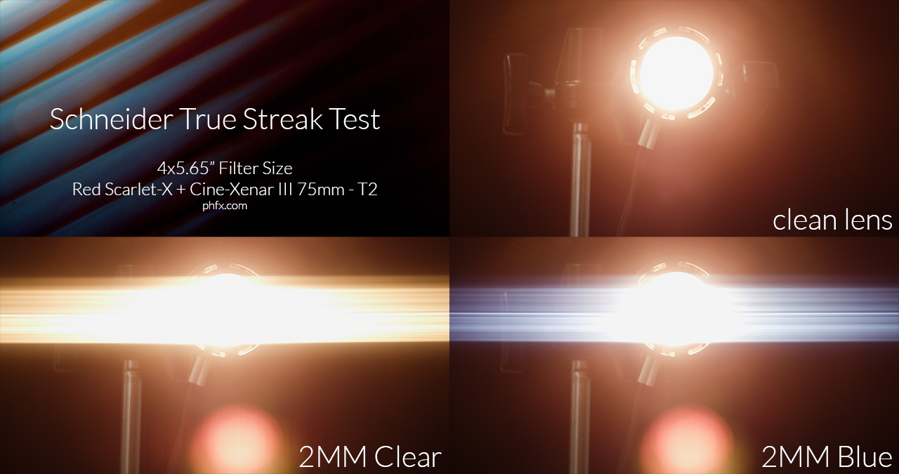

I use the Schneider True Streak when I need the effect and am not shooting anamorphic. Kinda looks like this:

One quick question, with the "CLEAR" True streaks, does the color of the light source determine the color of the streak ?
Correct. Clear holds the color of any light source. Most tend to favor the blue streak around town as it gives you that Panavision-ish anamorphic flare color.
